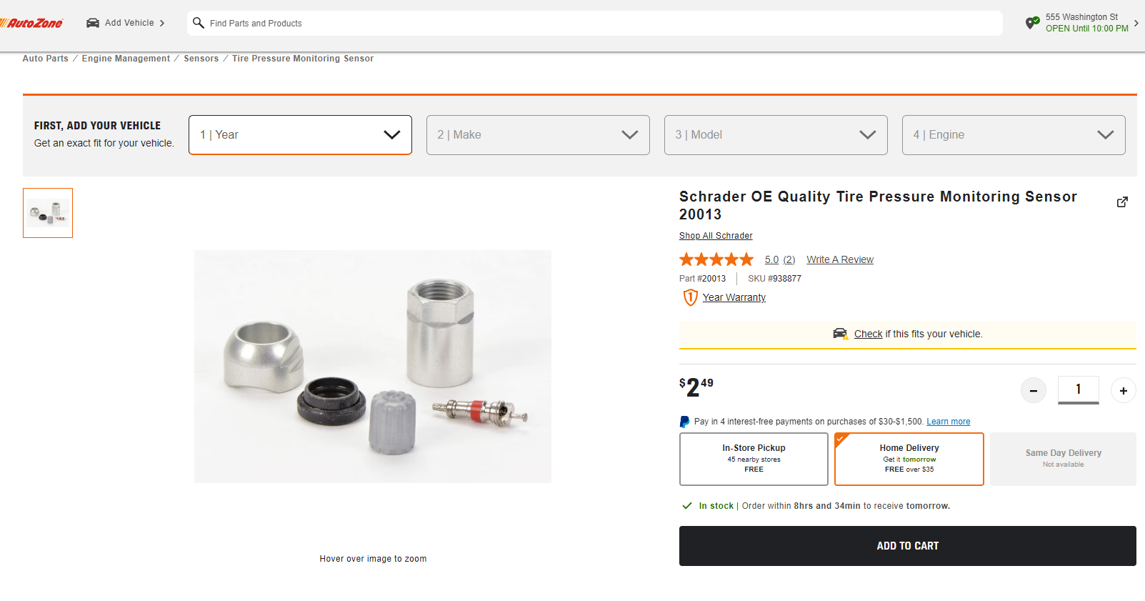

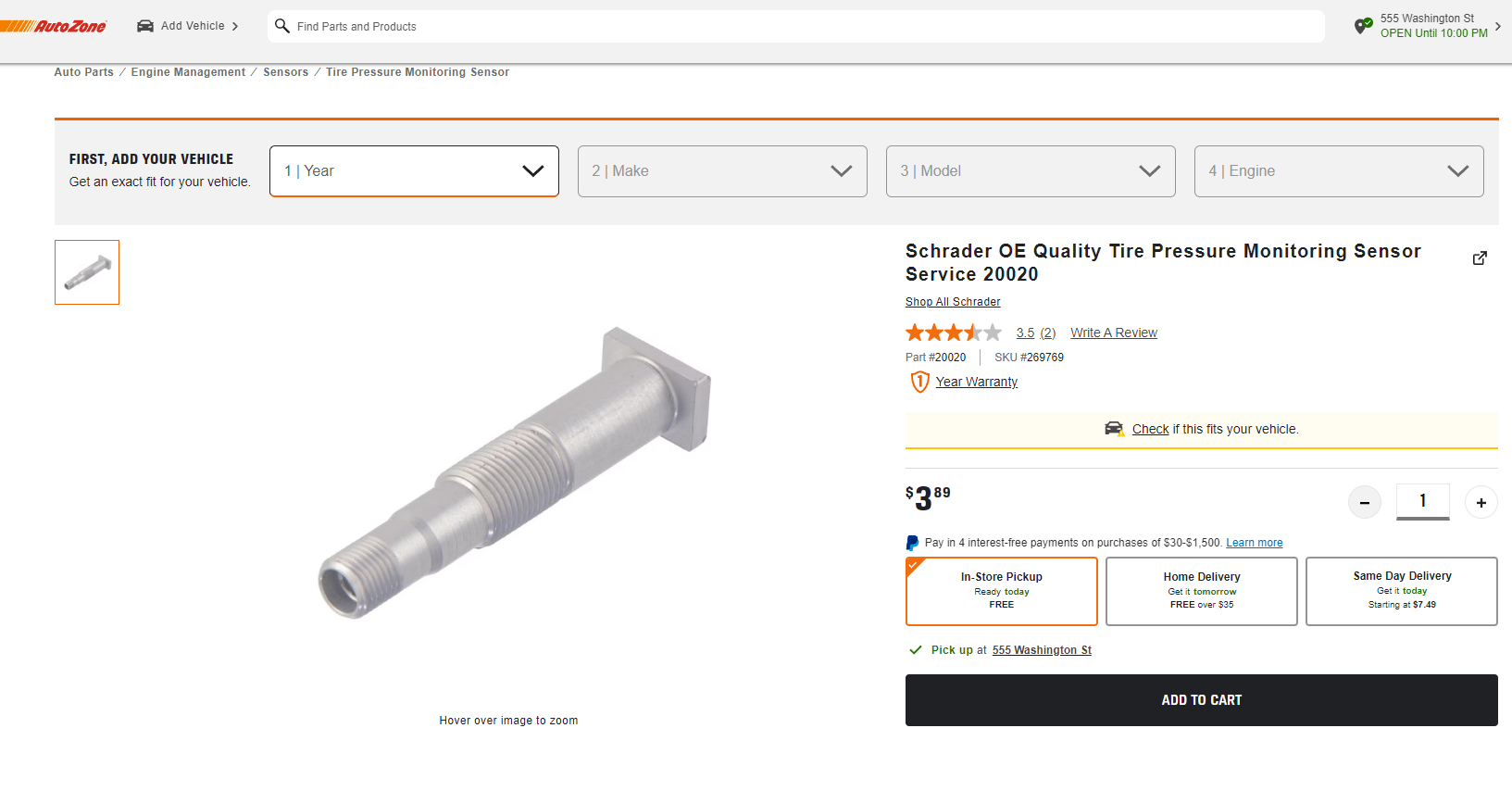

My 1st comment is did the shop replace all the parts of the sensors? Its good practice to have them rebuilt whenever the tires are replaced, especially if you live in an area that see snow and salty roads. Ive had sensors that were so corroded the stem just snapped off when I went to remove the cap to put some air in. I dont think this is related to your issue, just throwing this out there. I was able to find the rebuilt kits very cheap at my local auto parts stores. Shrader 20013,
