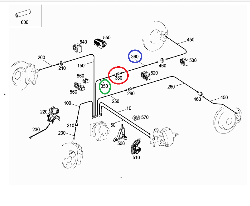

heres the parts diagram:
I'd rather use Mercedes fittings when possible and I was confused about which sizes are installed. From my research they seem to be M10, whatever that means.
I found the part# for the fitting by looking up other diagrams that use the same brake line part #'s.

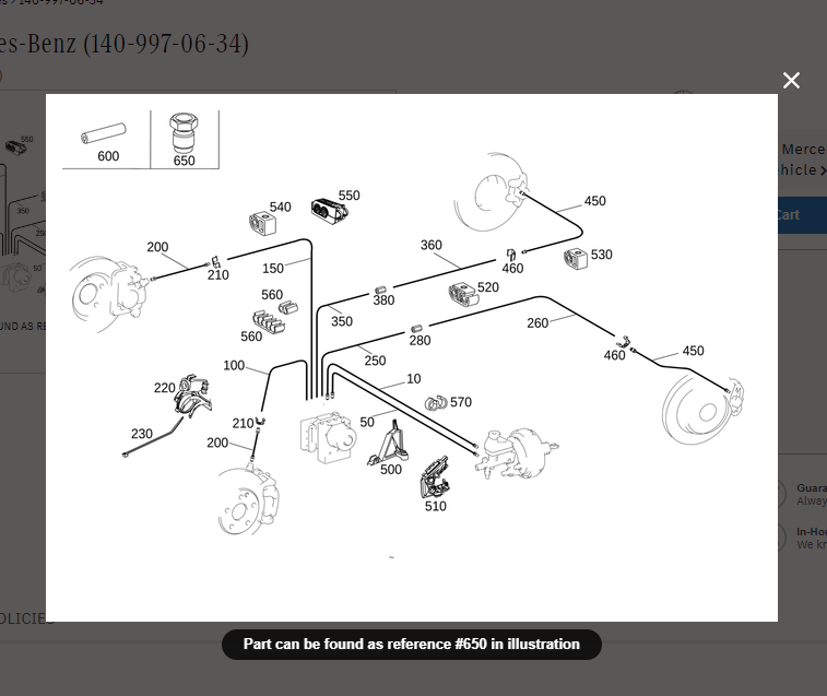

Back to the diagram:
Red circle shows part 380- Hexagon spacer.
Green circle shows part 350- Line 4.75 x 0.7 x 1395mm. So thats around 4-1/2 feet long.
Blue circle shows part 360- Line 4.75 x 0.7 x 4290mm. Thats around 14 feet long.
Im thinking that spacer must be somewhere near the front wheel well?
I was looking at photos I previously took that has my brake lines in them. I noticed some type of protection on the brake line at the spring mounts. I think that is part 600 in the diagram. Part # 2014761126. But when I search that part # I get fuel line. Is that just a piece of fuel line on the brake line?

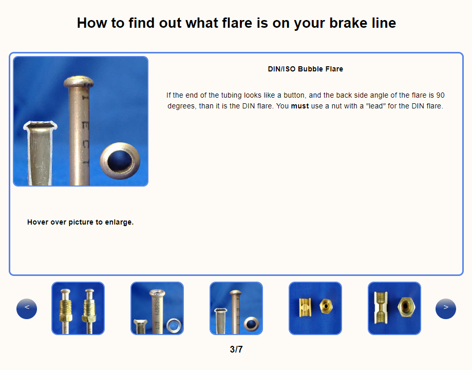

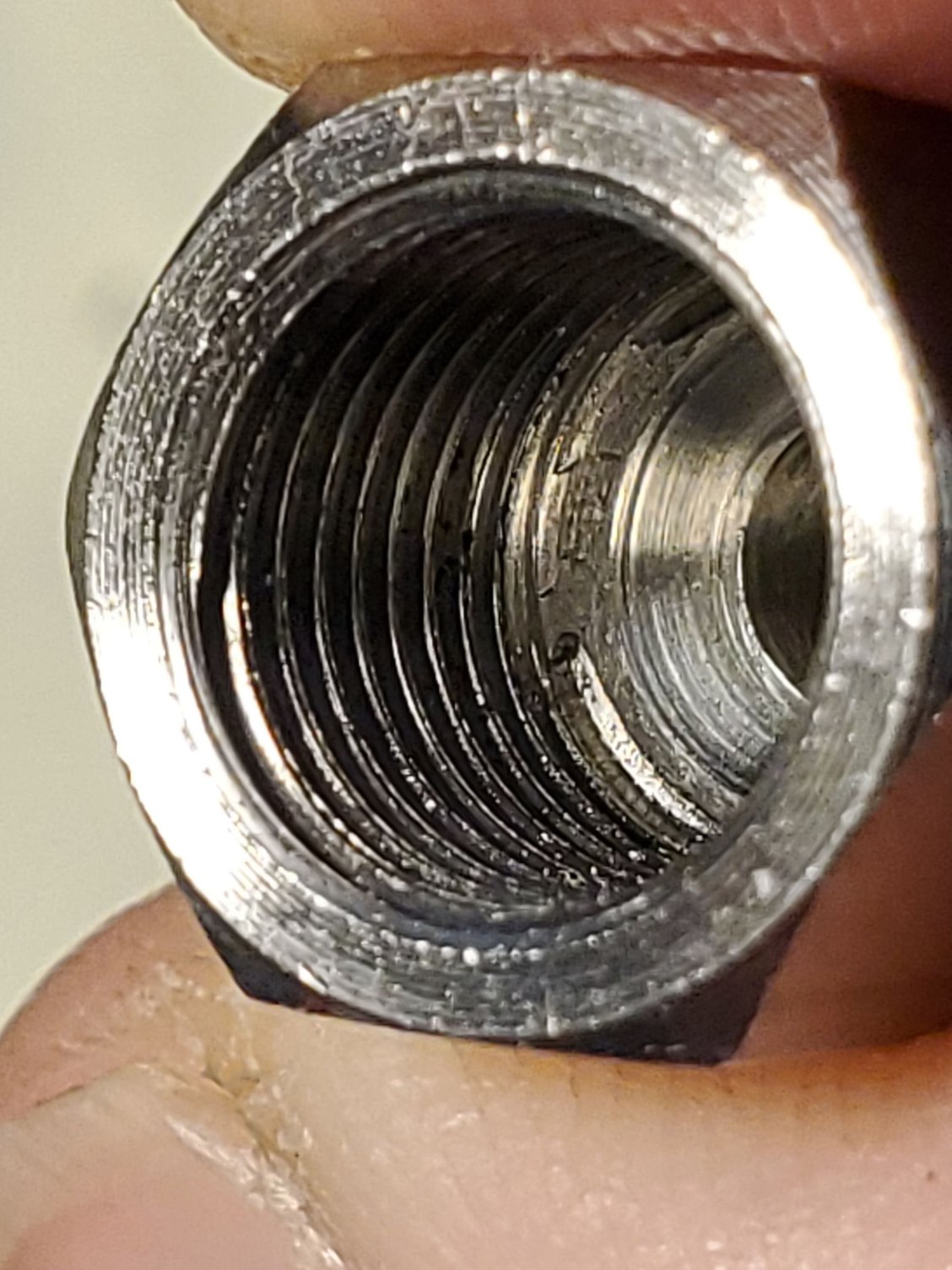

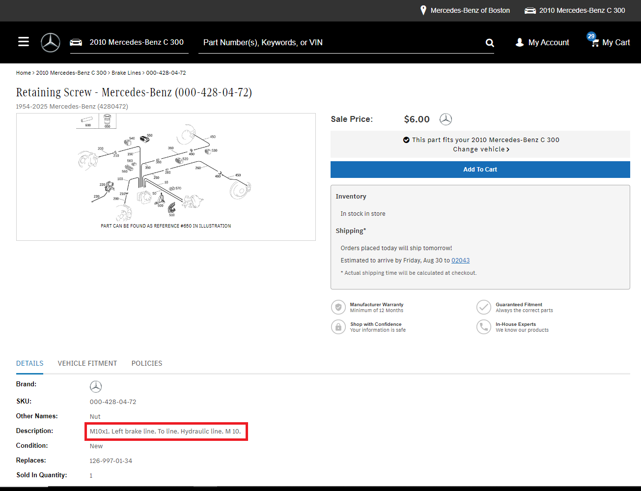

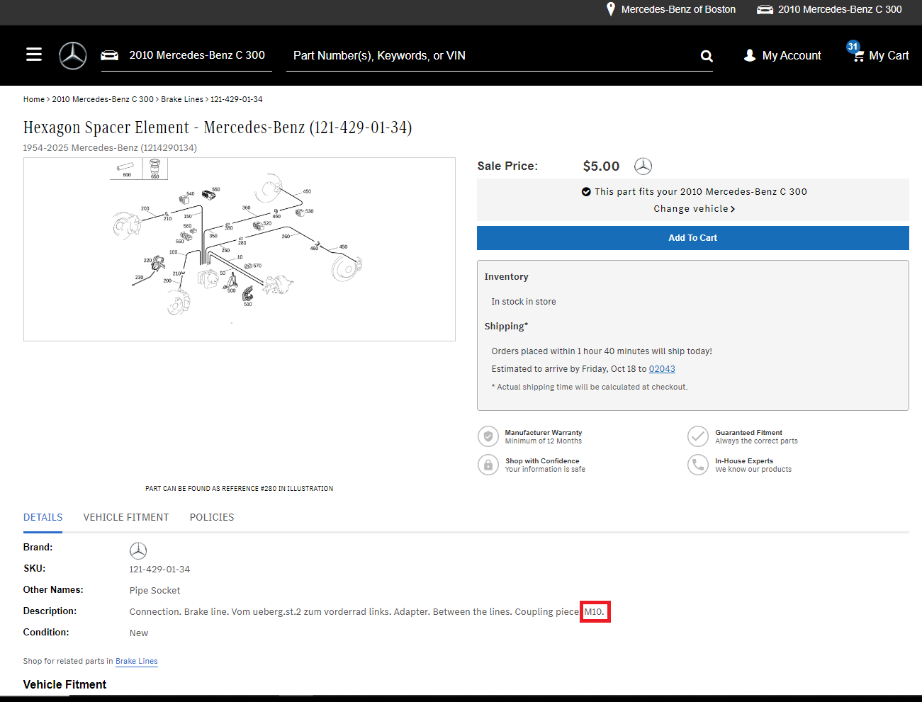

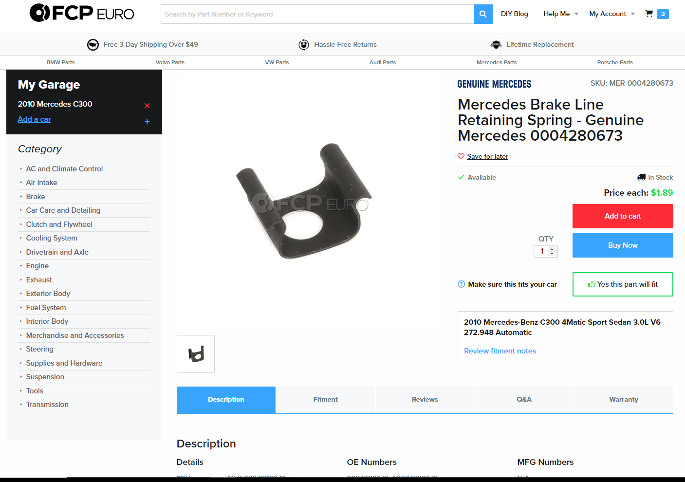

Ok, I think I finally understand. My issue was I kept seeing people recommend certain brake line kits they used and in those kits were a bunch of nuts, but to me they didnt look like they were the correct ones.
Am I correct in that the brake line kits on Amazon do NOT have the correct nuts? Heres an example of one I was looking at, it comes with a few different sized nuts:
I did some more searching around to learn what I am doing. It seems that the W204 brake lines use a DIN/ISO Bubble Flare? I drew the red X in below, my flare should NOT look like that, it should look like the one on the right?
This appears to match up with the parts I just bought, the hexagon spacer and the M10 Retaining Screw.
And the specific Retaining Screws/Nuts must have a "lead". Which looks like the Retaining screw I just bought? And the hexagon spacer I bought looks like the phot below.

I came across a video that seems to explain the difference with the nuts.

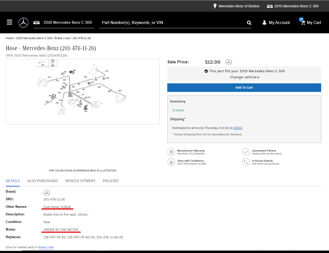

Now i'm wondering what brake line to use. I keep seeing people saying copper-nickel alloy is great, I see it for around $30 for 25 foot roll.
I was seeing how much the actual Mercedes brake line is. I found a few photos of it and got me thinking what material its made from. Looks like there is some type of coating on the outside To me it looks like PVF so searched around. Seems to match up with what im reading.
Now im thinking buying it from Mercedes isn't such a bad deal. Its $94 + tax. And figure it comes with each side flared and has two fittings. The fittings are $6 each and I do need two more. The description does note the line has to be adapted, im thinking one end cut to size and flared.
Id like to use the whatever will last longer, wont rust in a year, and is the easiest to work with and bend.
Heres the Mercedes brake line, for the passenger rear:

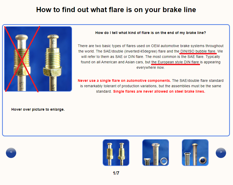

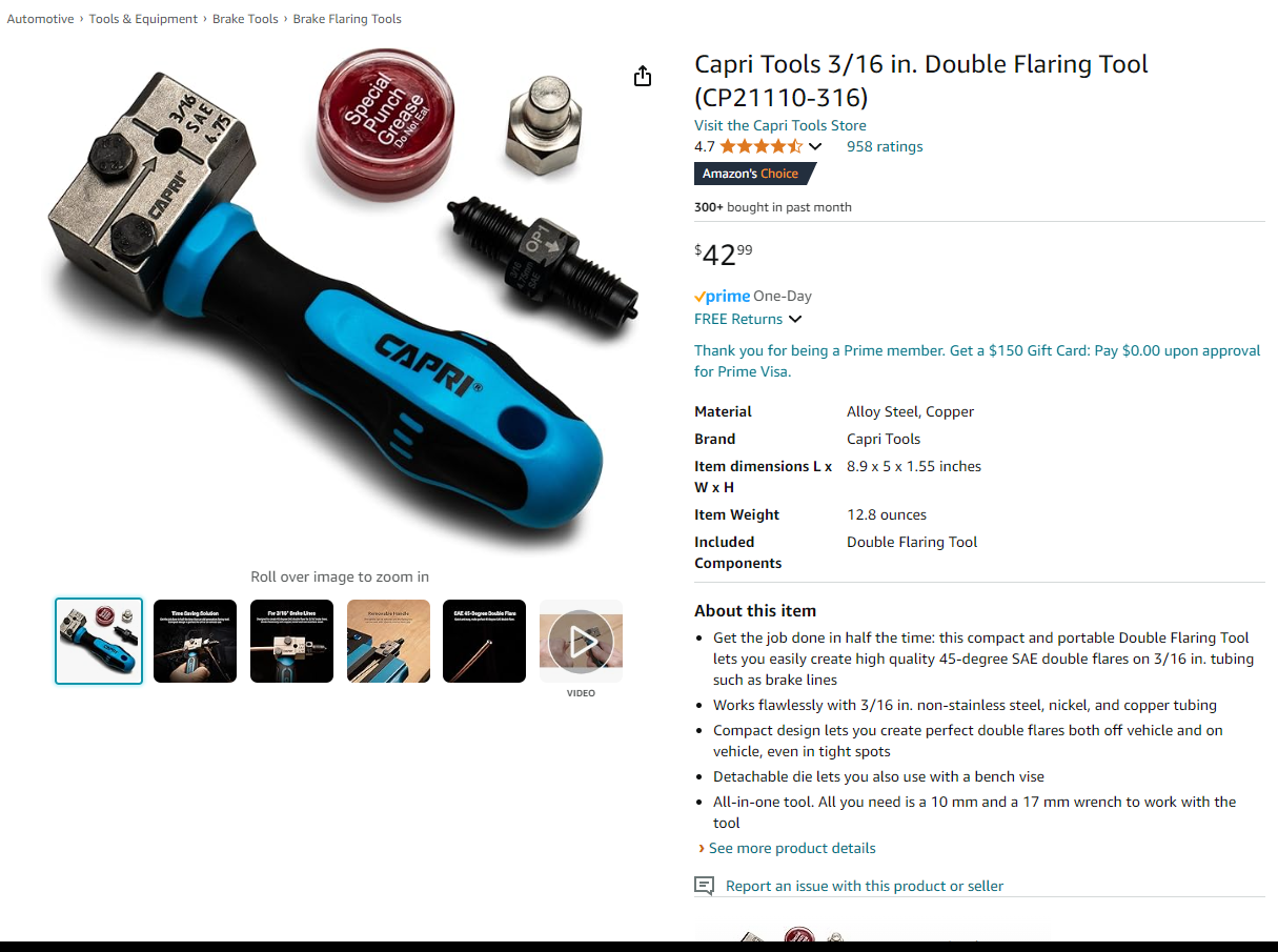

I now realize that flaring tool I posted above is NOT the proper one. That tool will not create a DIN/ISO Bubble flare.
I searched around and was looking at a few on Amazon. Titan has one for DIN/ISO flares. They even had two "used-like new" for $29 so ordered that one.
I wanted the hand held since i'll be splicing the old line while still attached to the car. Looks pretty simple to use, just tighten the die in the tool and its done.

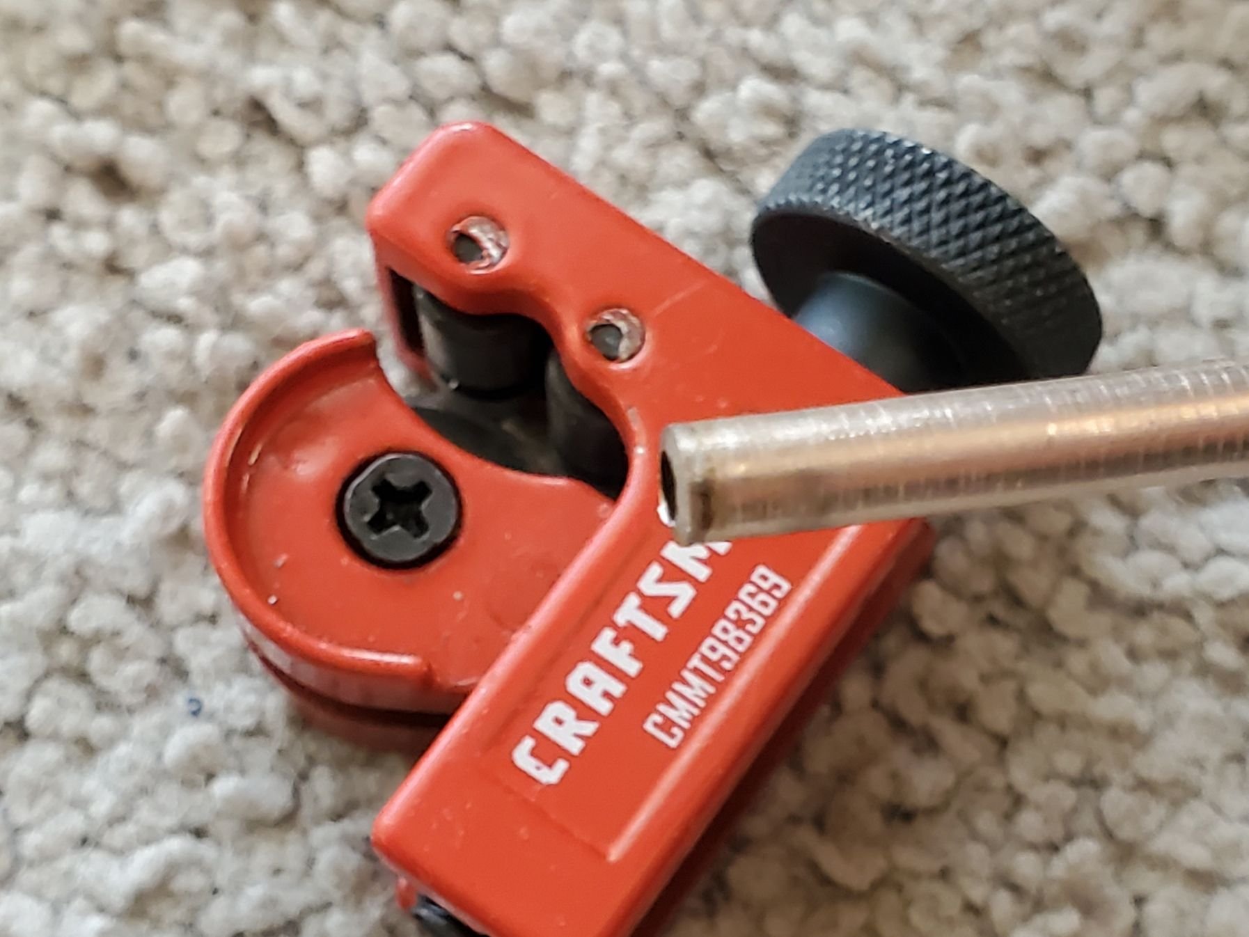

I received the 3/16 double flaring tool and unfortunately it is missing parts. The Amazon listing said "Used-Like New and in original packaging" but instead it is just the handle part wrapped in a plastic bag. Contacted Amazon customer service thru chat and received a full refund and I can keep it. I could have just done an automated return but was worried about being blamed for the missing parts, explained this to the customer service rep, which she thought was a good point. I think it helped that I was super nice.
So I did the next logical thing, I looked on AliExpress and found one even cheaper. $15, what a deal. In the photos it looks just like this Titan tool so its probably the same quality. We shall see.

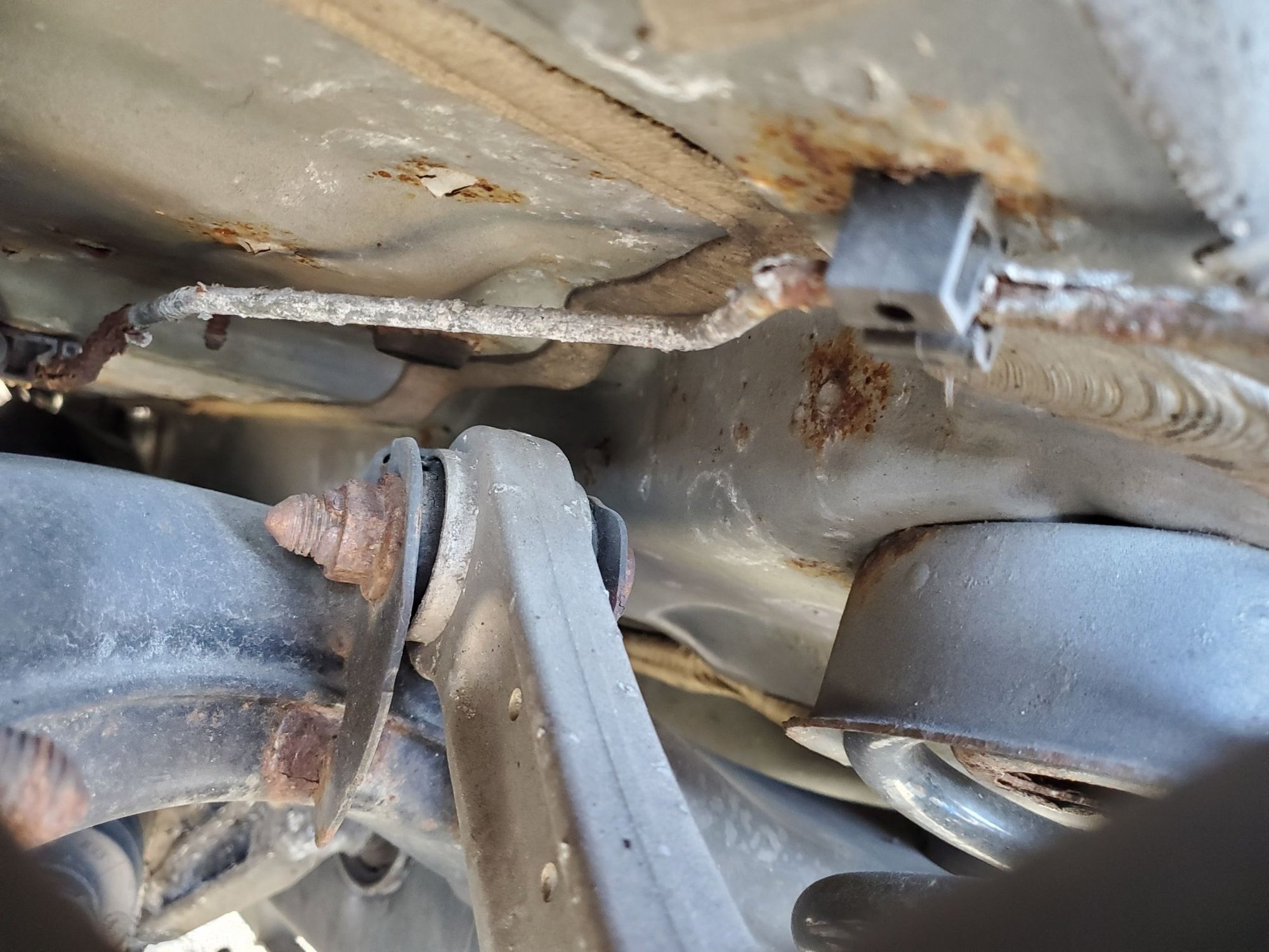

Got the car back and starting to inspect things. The rear passenger line is much worse than I thought. To me it looks like the corrosion/rust is at the bends, im guessing that coating was damaged when the lines were bent. From reading what they are theres just a coating over steel lines? Hope the new parts get here quick. I went ahead and ordered another flare tool off Amazon that should be here Thursday, I didnt want to risk waiting for the AliExpress one, even though it did ship out that day and tracking shows its on its way.

I had a chance to remove the plastic panel under the car and sure enough there is no hexagon spacer installed anywhere on the brake lines. Unless its up in the front wheel well, which I doubt.
Inspecting the brake lines it does appear that the drivers side rear has been replaced since it look to be in very good condition. The passenger side brake line that runs under the floor does not look as bad as the part going over the axle carrier. So for now my plan is to just make a new connection in the drivers wheel well and replace the line going to the wheel.

In the parts diagrams i have it shows the rear lines are actually 2 sections, and a hexagon spacer connects them. If you look for the part #'s it has 2 for each side, not just one. Oh well, i dont have the spacer, its just one solid brake line.
I dont think i can easily move the hard plastic line out of the way in order to make 1 entire line. Im thinking of making the connection somewhere around this location. Replace the rear section of line, then later on either replace the forward section or just redo the entire line. I think I need practice just doing it.

Heres the line under the car:
The drivers line (inner) looks newer.

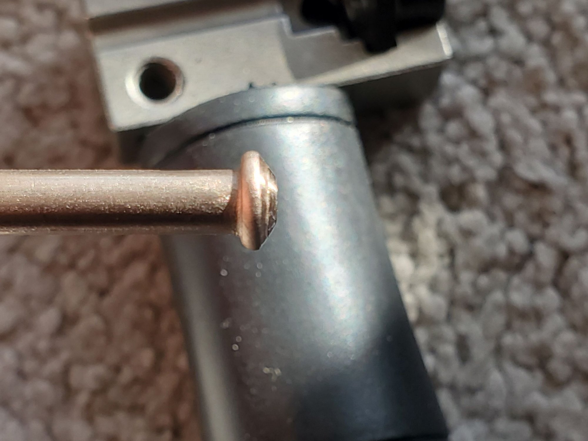

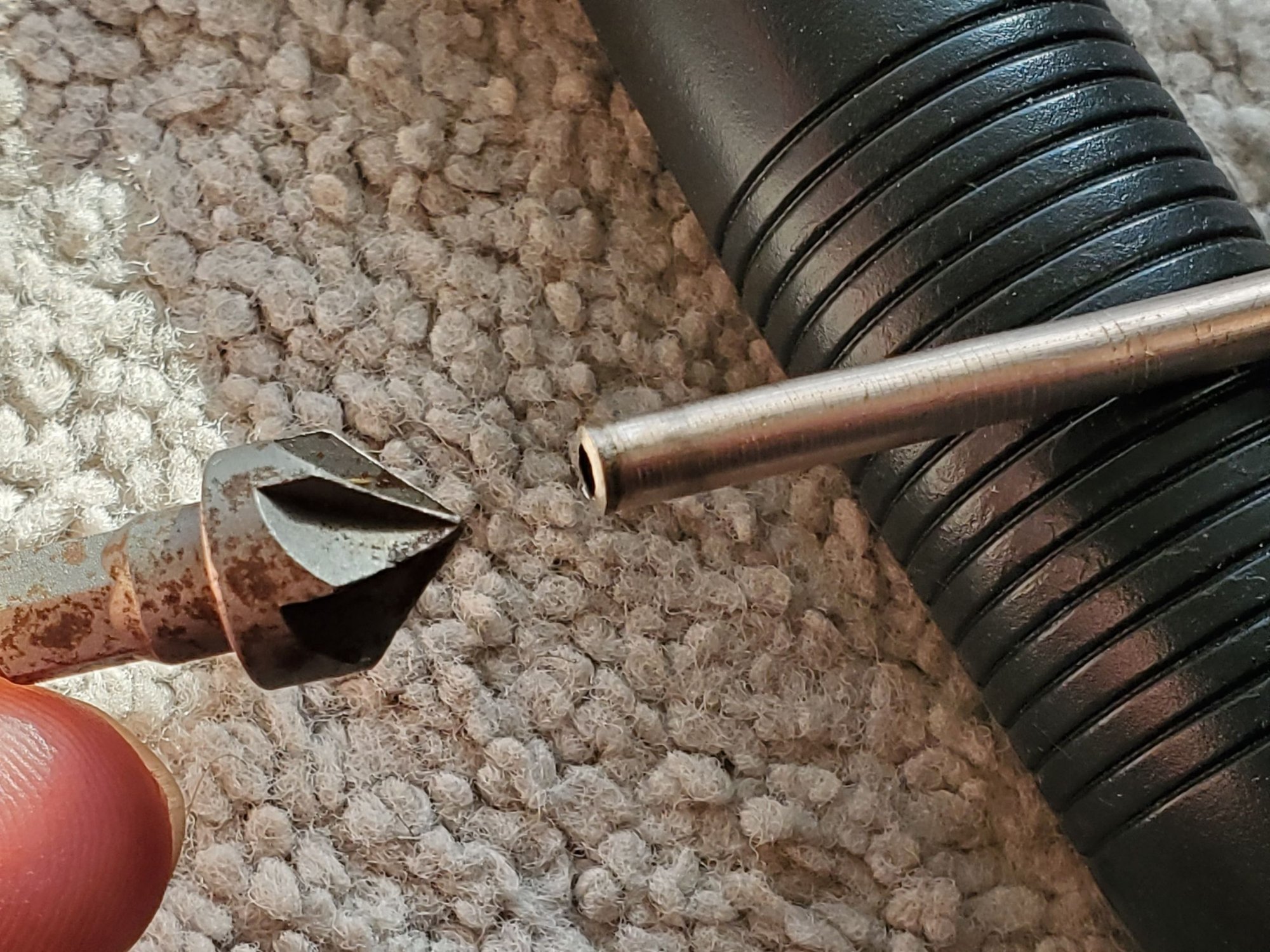

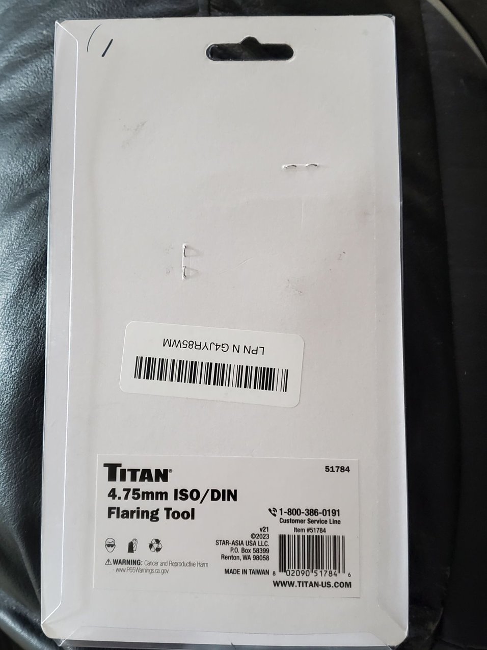

Received the Titan flare tool. This one was also listed 'used-Like new" and it does look new and not used, packaged isnt even open. This one was only $31.50. Says made in Taiwan. I still have the other one coming from China, see which one works better.

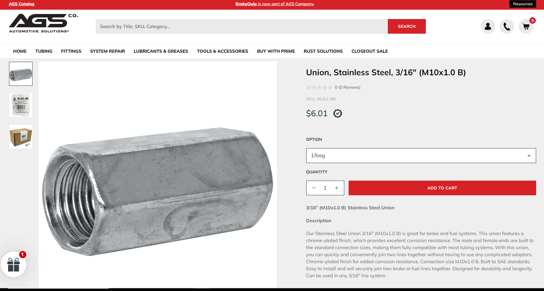

I received the brake parts from AGS and I do not like the fittings. The hexagon spacer is junk, the machining inside looks horrible. The nuts look good but they do not work with the Mercedes hexagon spacer, I do a test fit and the nut does not tighten the flare. Test fitting the AGS nut and AGS spacer the flare does seem to be fitting tight, but again i do not like the looks of that spacer.
The Mercedes brand nut and spacer work great so I will have to pick up some more.
I used the flare tool on the new line and the first one came out great. Its surprisingly super simple to do.
AGS junk hexagon spacer:
Bought a Craftsman mini tube cutter that works well.
I used a counter sink bit i had laying around to debur the inside of the cut tube:
Put the line in the tool, grease the die then just screw it in until it stops:
heres how the Mercedes nut fits:
The AGS nut feels loose and sloppy, the inside of the nut is tapered and doesnt push against the flare as good as the Mercedes nut.

Picked up more of the Mercedes parts at the dealer. I do not feel comfortable using the AGS stuff. The brake line looks good though. Wish I can figure out who manufactures the Mercedes nuts so I can just buy direct from them instead of paying $6 each.
I dont know if its just a quality thing but the AGS nuts look different from the Mercedes nuts. Different number of threads, the end of the nuts are different where the Mercedes have a flat shelf while the AGS nuts is tapered on the inside. The AGS look more for an SAE inverted flare.
If I try and screw an AGS nut into a Mercedes hexagon spacer it wont screw in all the way, its like the threads prevent it from going down all the way. I looked for other M10x1 nuts locally and they are all different from each other, different threads, tapers, it doesnt make sense to me.
AGS on Left, Mercedes spacer on the right. The hole in the AGS is much larger, it doesnt need to be since the Mercedes hole is the same diameter as the inside of the 3/16 brake line. The threads are machined different, AGS go all the way down.
AGS vs Mercedes nuts: mercedes are the silver ones.
