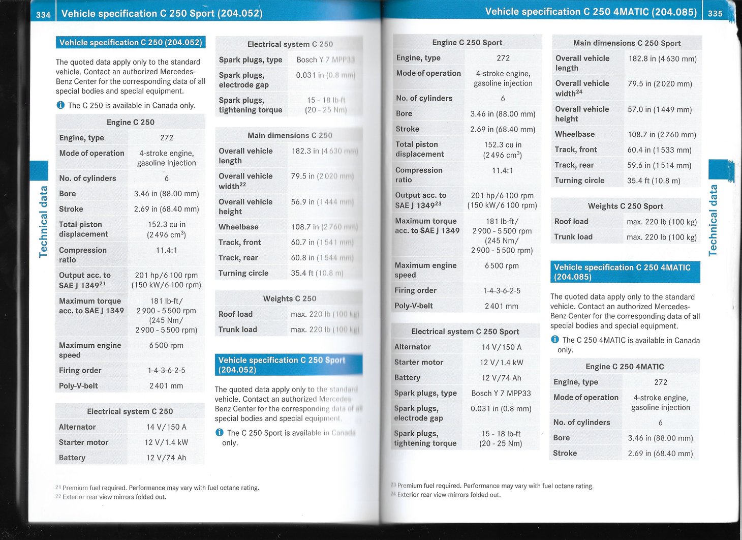

Look in your operators manual in the glove box. It may list the type of spark plugs in the vehicle specifications section. Mine does, I have a different engine so yours is probably different. Mine says Bosch then lists the part #. Also lists the spark plug gap. The entire section has alot of useful info, like drive belt size, spark plug firing order etc.
I personally wouldnt replace the coils unless I knew they were bad. Obviously replace the off brand coil.
The problem with over filling the oil is over time it may force its way into the pcv system, which happens to be in your valve cover. If the oil was recently done theres no need to waste it, just drain some off if you can.
Heres what my 2010 Operators Manual has for the C250.
