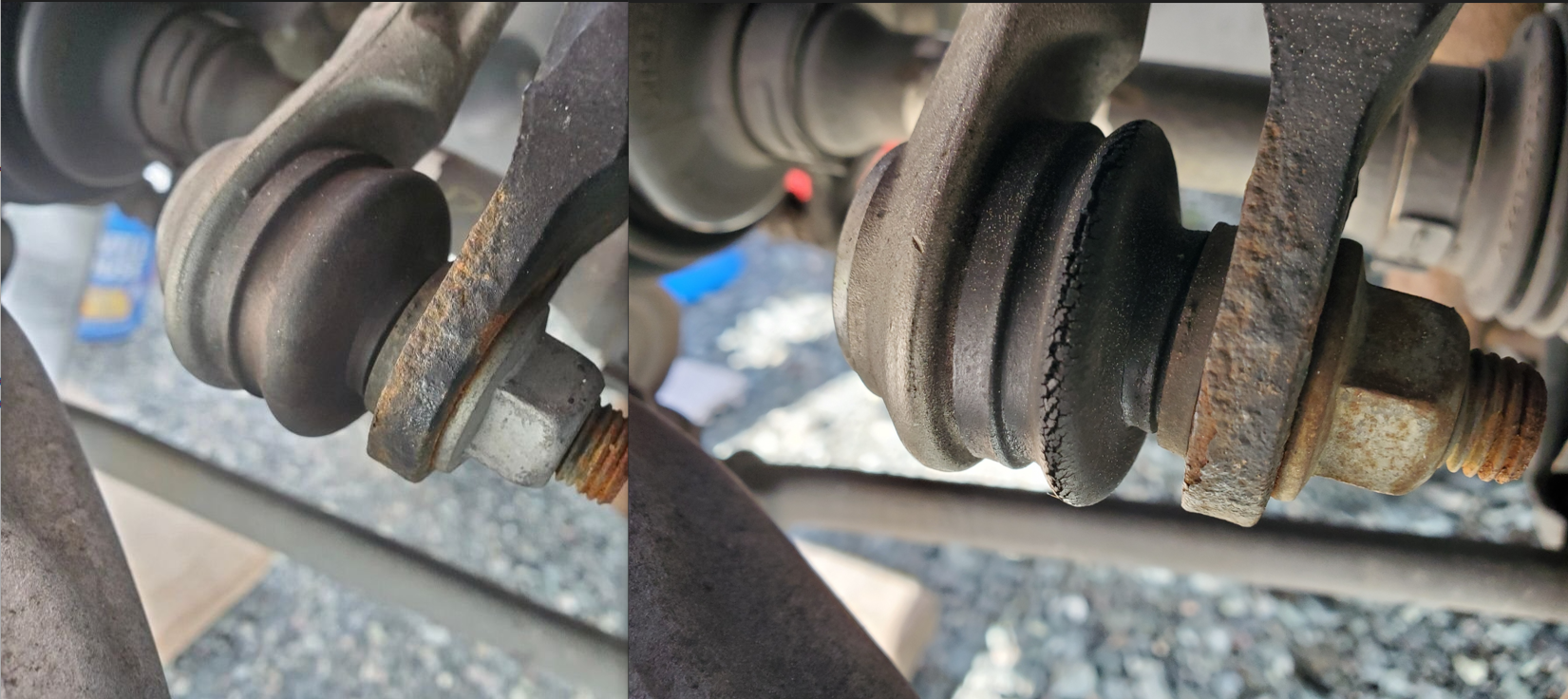

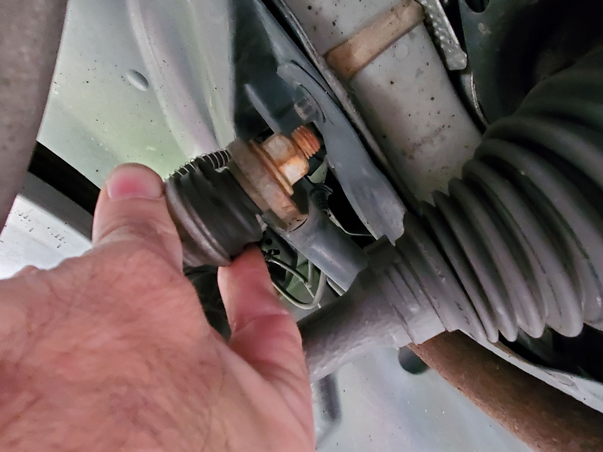

2yrs ago I had replaced some failed Genuine Mercedes sway bar links with a set of Febi sway bar links. I went with Febi because they were significantly cheaper than genuine Mercedes and figured Febi is a good brand. I also bought them from FCP so figured if there is an issue i can just get new ones from the lifetime warranty. This past summer I noticed the passenger side sway bar link boot on the bottom was cracking and looked out of place but other than that no issues. The drivers link looked fine. Now im hearing a metal-on-metal noise from that side. Jacked up the car and removed the wheels, while grabbing the link I was able to easily rotate it. The drivers side still felt solid, is very hard to move.
Never returned anything to FCP before so i emailed them explaining the issue along with photos of the boot. The response was positive, saying to buy a new one, ship the old one back and i will get store credit for the original purchase price.
Aug 11, 2022 I paid $29.99 for the passenger link, today it is $37.29. Shipping the old link back will be what, maybe $8.
To get free shipping this time around for the link I added an oil filter for $12, which is very high since I remember buying them for $6-8 last year.
We shall see if it solves the noise im hearing.
Drivers side looks fine:

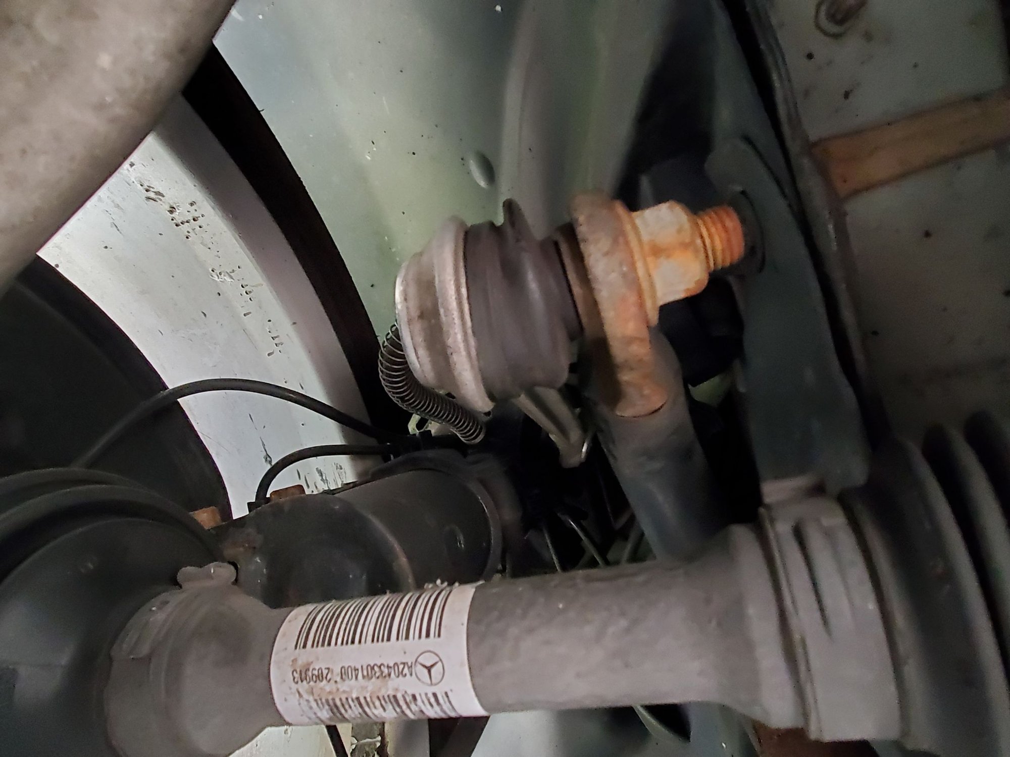

Still waiting for the new link to get here. The noise is noticably getting worse.
Mostly hear it at low speed. It does not sound like how my previous failed sway bar links sounded. Previously the old worn links sounded like a metallic tinking 2-3 times in a row when going over bumps on the highway. Would be a loud tink followed by 1-2 more quieter tinks, link the joint was bouncing. This time its more of a solid metal sound, reminds me of when you grab ahold of the middle of the cv axle and push and pull it towards the wheel hub.
I also noticed there is no logic to when I hear the noise, ill go over bumps expecting to hear the noise and nothing, trying to replicate it happening is hard. One thing i did notice is if i hit a bump with the left tire and the right tire is not going over a bump I will hear the noise. So the sway bar link makes sense, bump on the left side pulls up on the sway bar which pushes up on the right side link.
Instead of jacking up the car I drove it up my ramps, went underneath and played around with everything. Same as before, the left side link is on there solid and cannot move it around at all by hand. But the right side link I can grab it by the bottom and easily rotate it with my fingers.

this is why im trying my best to diagnose the issue. Figure start with the obvious worn part and cross it off the list. i could always remove the link altogether but im not that motivated at this time, can wait for the new link to get here.
I was searching around and found a photo of when the link still looked good. To me for the boot to be squished in im guessing the ball and stud part has moved more to the outside.

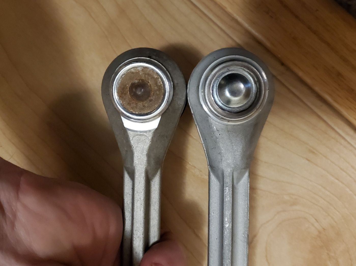

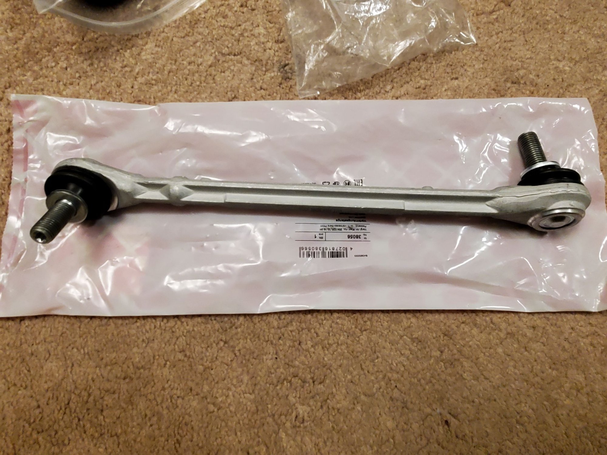

Finally just got the link and about to install it. looks different from the ones in the car. I noticed it has a T40 now instead of a 6mm hex. The boots look different. label says assembled in Germany.
I always wondered how everyone installs them, writing side out, so the ball looking thing is up top?

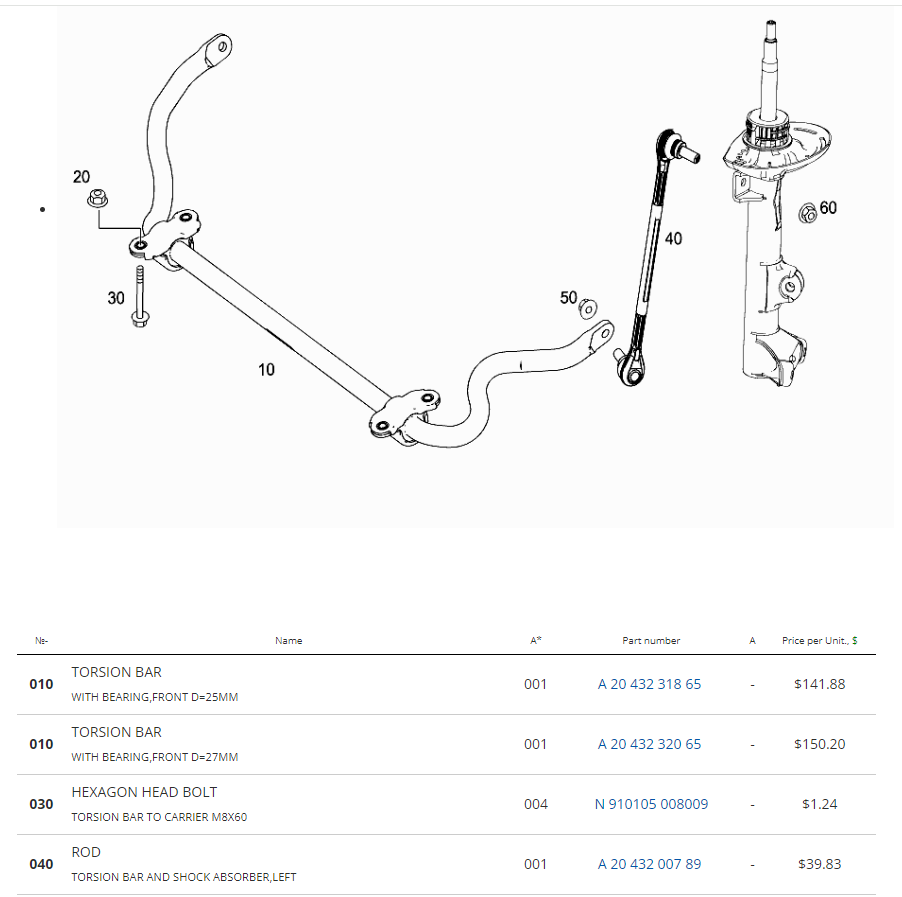

suspension sway bar noise.... BUSHINGS!
This week I am tracking the front noise maker regardless of good links... I think its the undersized sway bar bushings that get pinched... then the spring bar gains direct metal to metal contact.
Perfect setup:
MB does not sell $10 bushings separately from $200 sway bar
Earlier I've realized that Front+Rear SB Links share the same side-to-side job. So bad front SB bushings call for rear ones as well!

There is an open tear in the bottom boot that I never noticed until now. No signs of grease coming out. oddly enough the bottom ball joint isnt making any noise but the top ball joint makes a popping noise when I manipulate it, pull the threaded part in and out. So it is clearly worn and failed.
Side by side they new and old links appear to have not been made the same, there are slight variations. I will say I am not too confident in this new link, we shall see. I really would have liked to get Mercedes branded.
The threaded portion looks a little longer on the old link, i hope its not due to the washer looking part being pushed in. The Amazon links failed by that part being squished into the joint. Also the machining on the new link looks like it could be better. Reminds me of the hex spacer I recently bought for my brake lines and didnt use due to horrible machining.

I am with you this week on the front noise maker regardless of good links... I think its the undersized sway bar bushings that get pinched... then the spring bar gains direct metal to metal contact.
Perfect setup:
Im always keeping my eyes open for a good price on a replacement front sway bar. I think it will tighten the front up alot. Lately it feels like im driving on a road with deep ruts in it, the car swerves. maybe this new link will tighten it back up. It is definitely failed,.

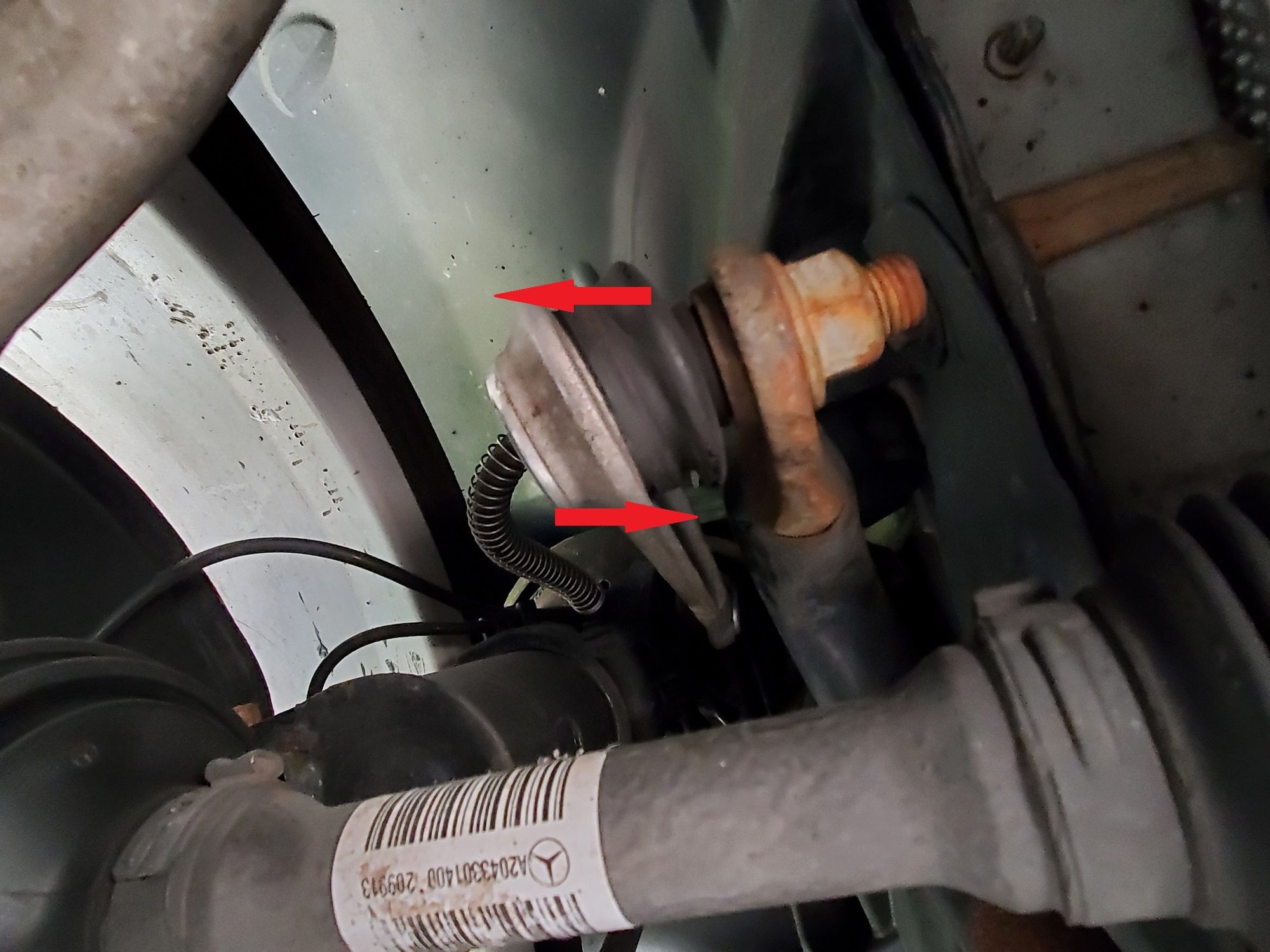

Looks like the sway bar is rubbing against the plastic trim in the wheel well. The bushing looks torn but still in one piece.
The nuts for the links are absurdly tight, have to be really careful to keep the T40 in the hole or else i can see it stripping easily.

Went for a long drive and the noise is now gone. Problem solved. It did sound pretty bad, like the axle was going to fall off.
I looked inside the bottom joint that had a rip in the rubber boot and amazed to see how little grease is even in there. It looks fairly clean, like there was hardly any grease to begin with. Theres no signs any grease had leaked out. With my previous MB branded links I remember how greasy they were and those boots were torn open all around and had plenty of time to have it all washed out from driving in the rain. I cant imagine not filling the boots full of grease, wonder if they were defective from the factory? And the rip in the boot on on the top with how its installed, clearly didnt drip out. I cant tell what the hair looking stuff is, some type of fiber, its not shiney like metal shavings would be.

On these links the ball joints are offset since the sway bar ends and the bolt hole on the struts are offset from each other though looking at the links and picturing installing them both ways I do not think it makes a difference and they articulate the same either way. Theres really no clear direction on which way to install them, with the wheels pointed forward they fit in perfectly. I looked on Pelican Parts at there article and just installed them the same way they have theres, install the ball joint end that looks offset from the bar on top to the strut.

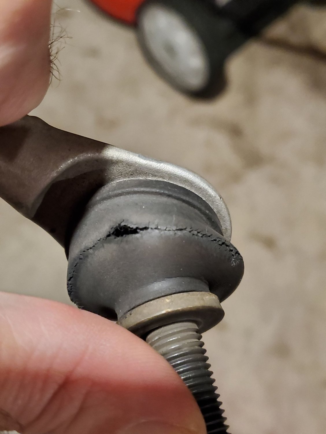

I think its finally time to replace the drivers side sway bar link.
I'm pretty disappointed in these Febi sway bar links. Even the replacement passenger side link has cracking all around the boot. I think most of the issue is lack of grease inside the boots. Can see the boots are completely sunk in.
Nice weather is starting so im beginning to do maintenance on the car again. Changed the oil and filter the other day now im going around removing the wheels and inspecting everything. Give the brakes a cleaning. inspect the cv axle boots i had replaced last fall and they look great. I'm happy to see the corrosionX XD rust inhibitor is still on and survived the harsh winter. Drove thru some pretty harsh blizzard snowy conditions and the coating hasnt washed all off. hardly needed to touch anything up. It does leave a greasy dirty film but its better than rust.

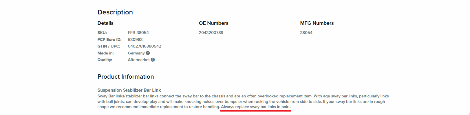

I was reading thru the listing for the sway bar and noticed they say always replace in pairs. I wonder if FCP would have let me buy both links and then return both used links even though the drivers side was still good at the time? With the drivers side now making noises and boot clearly torn do I replace both sides, the passenger side already has torn boots on them.
