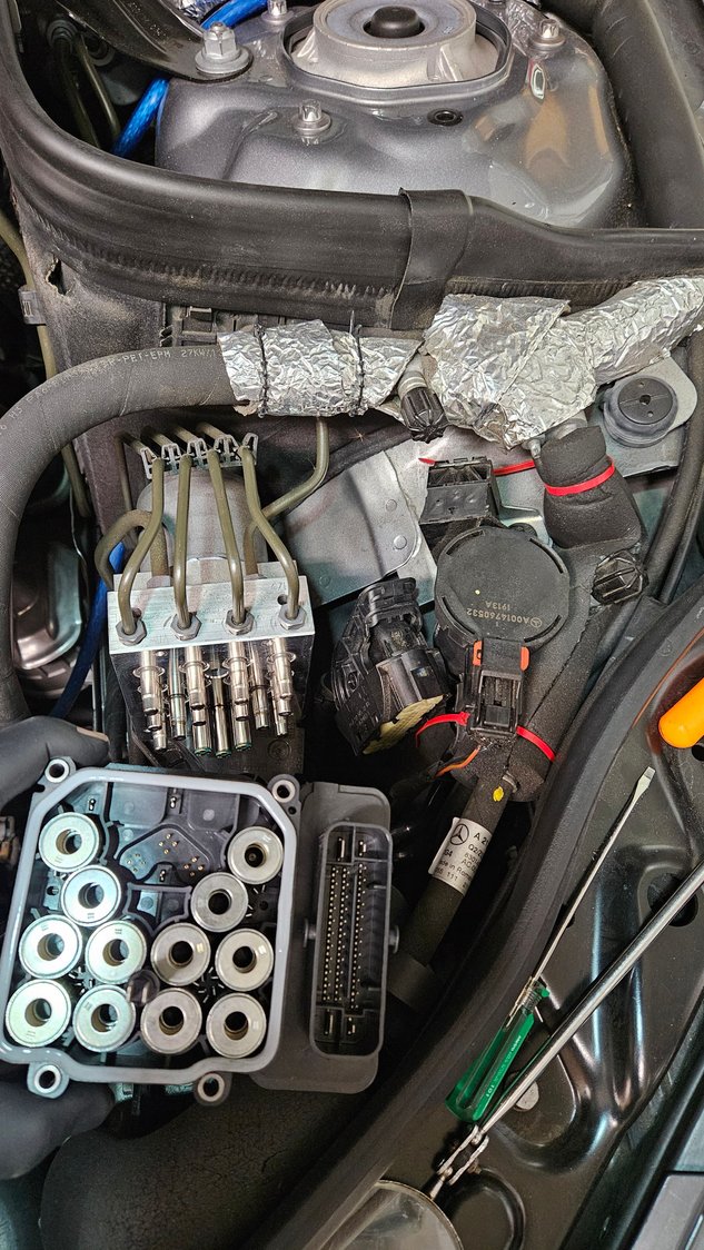

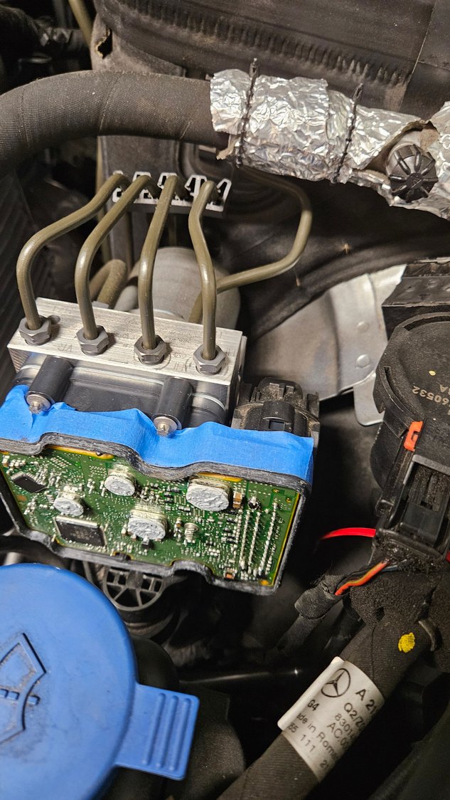

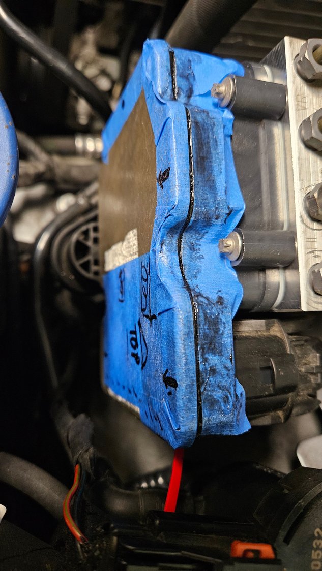

ESP is one hell of a provider of timing chaos - Many nearly all chassis modules query wheel speed from ESP: ECU, TCU, EPS, ISM, SCM, even headlights modules do.
Bosch ESP is a state of the art VIP module that impacts the entire chassis performance silently without fault from day-1.
Solderless connection are undersized to develop poor then really poor connections under coil pulsed current spikes.
parting control side
away under 5mn
away under 5mn
Loose pins collection 👏
engineered to be reliable for some time
PCB overall birds eye view
loose pin opportunities
input pins
input pins
soldered and coated better than new
going back in
going back in
installing
installing
back home forever.
back home... sealed forever.
If you can't solder electronics, choices are limited to coding a used or new solderless unit.
The solderless pins are nearly ok except under perfect-storm conditions when CAN bandwidth is degraded.
> Free Temporary Fix...
While ESP transient faults are in "stored" status you can try to Reboot whole chassis and ensure good chassis voltage.
Crazy ESP module has the potential to trigger unexpected "limp modes" and braking issues when it bugs out the ECU/TCU...

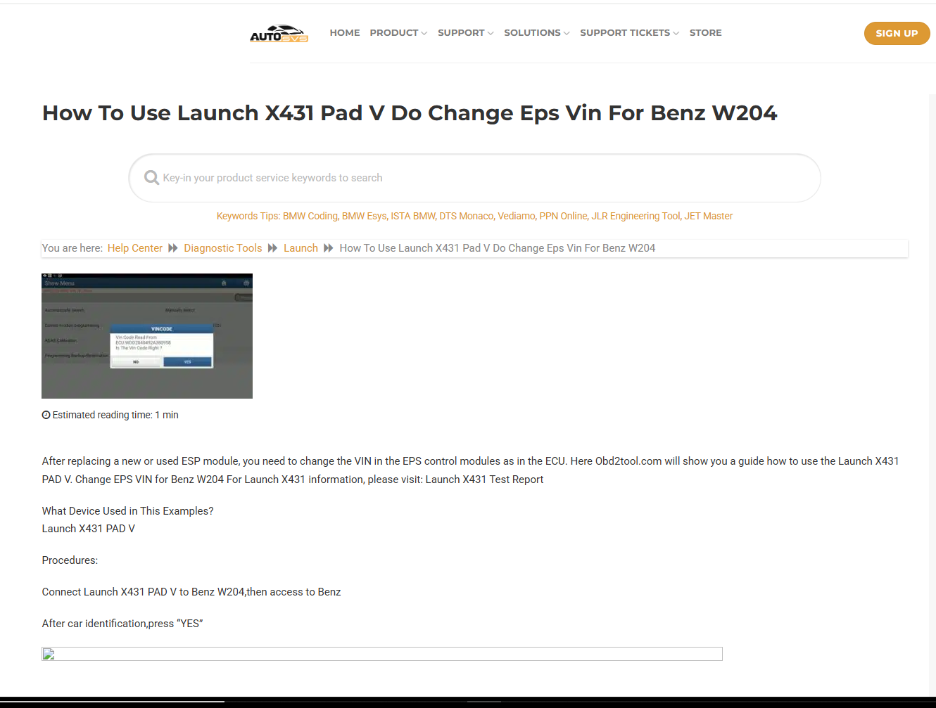

From searching around it seems a used esp control unit can be installed but the VIN has to be changed to match the car. Is the Launch obd scanner capable of changing the VIN, in the description it claims ecu coding? I tried with my Foxwell NT530 and it does not seem to have that feature, it shows me the VIN but no option to change/update it. I dont think it can code at all. Wonder if someone with a Launch can check, see if it will let you change the vin in the ESP.

I came across a youtube video of someone changing the VIN of the module but it was with a $1,000+ Autel scanner. Im trying to see if the $150 Launch can do it.

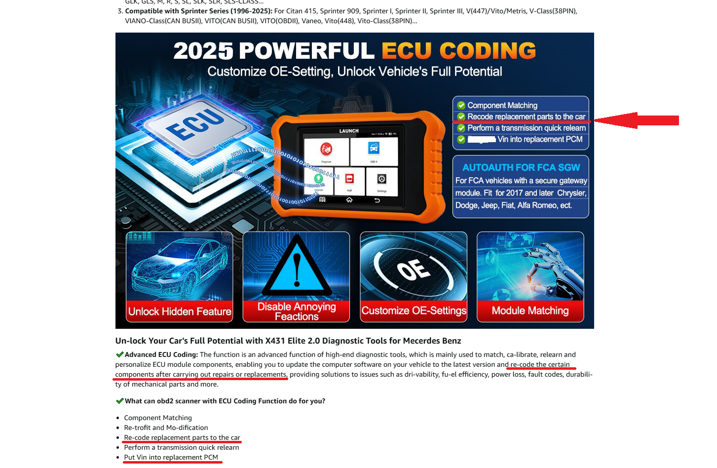

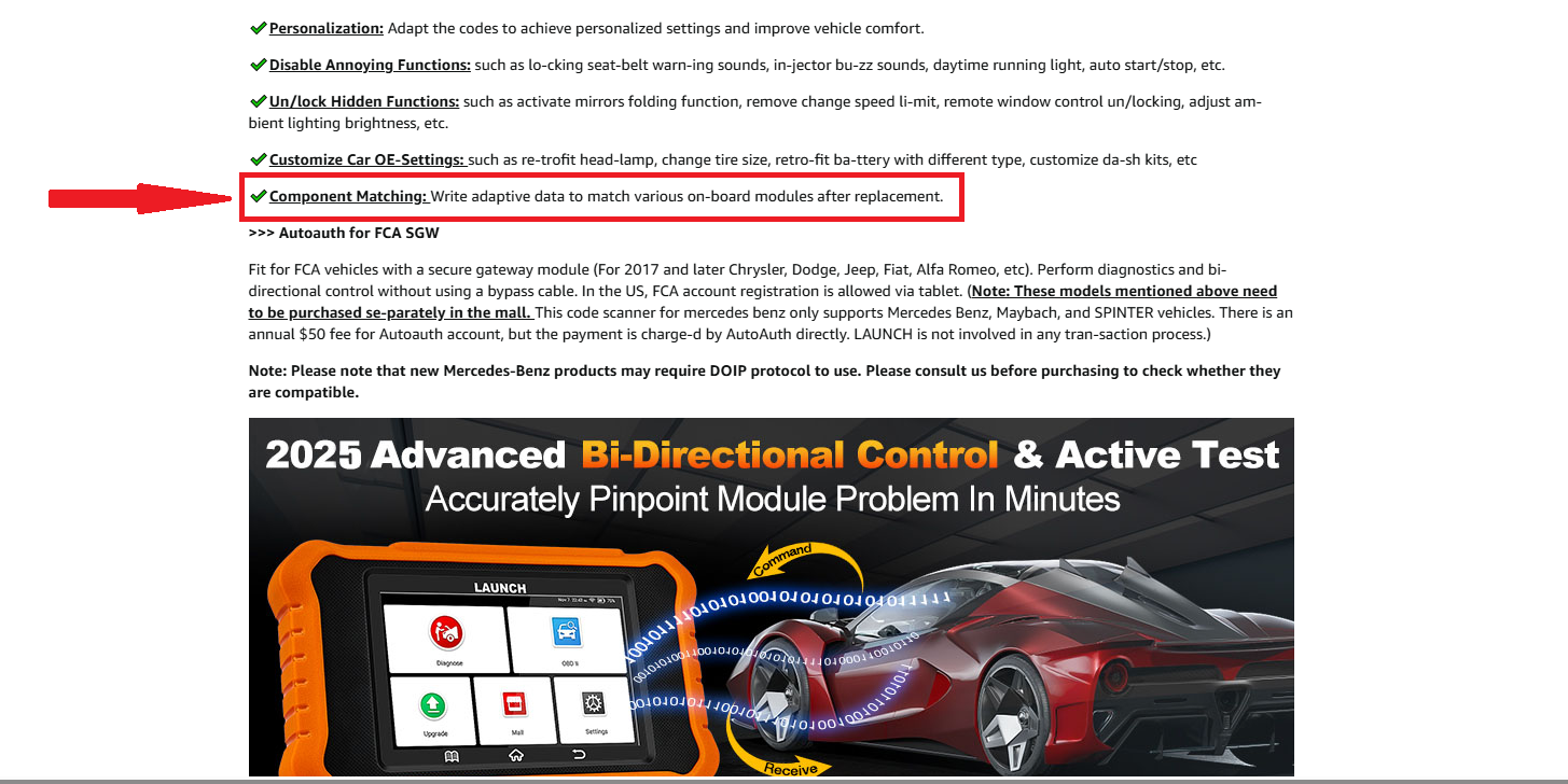

This is why im wondering if the Launch Creader can change the vin on a used ESP module. This is the description from the $150 one on Amazon, $108 on AliExpress.
Not sure which specific one this is referring to.

this looks good
