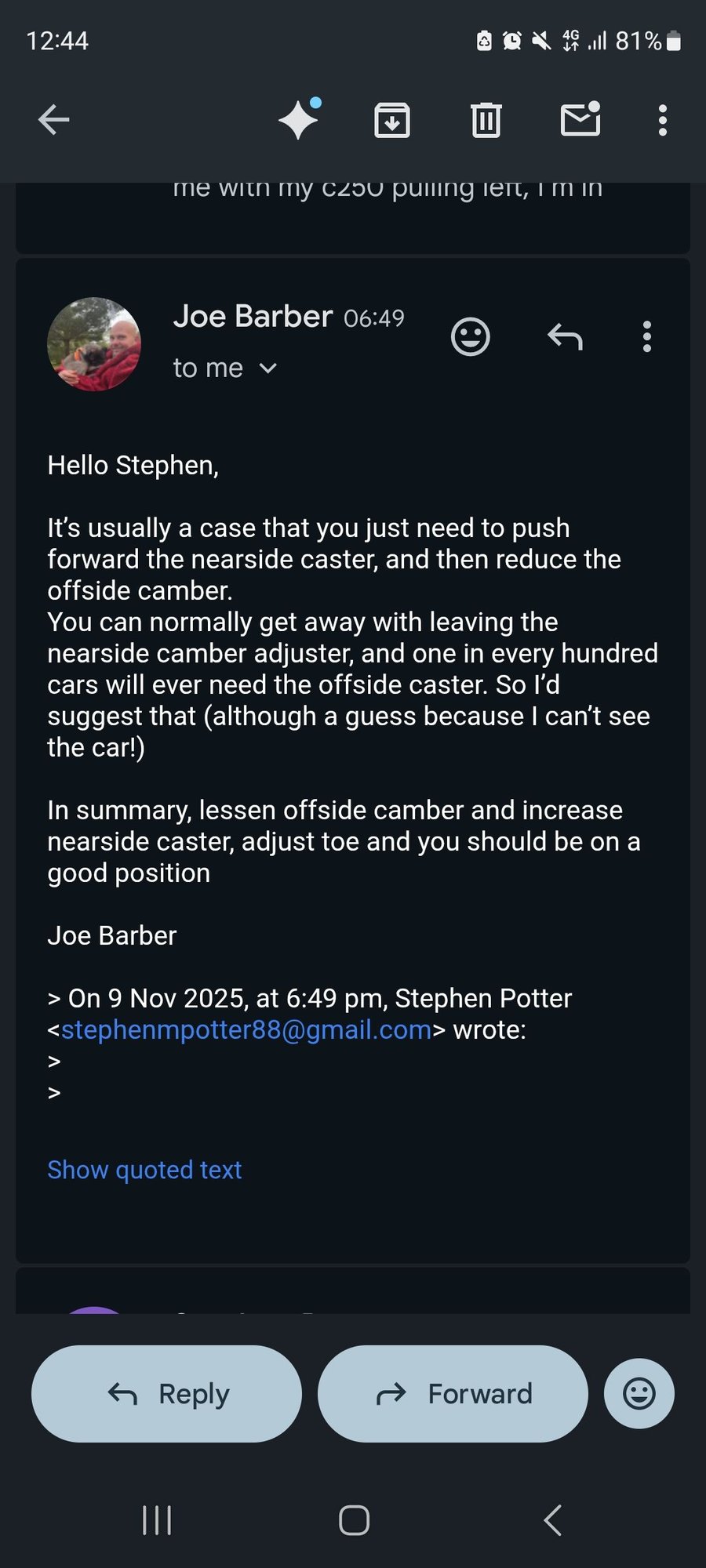

How to fix pulling left
I had the same issue on my c250, this picture explains how to fix it, I've had it done so I know it works.
