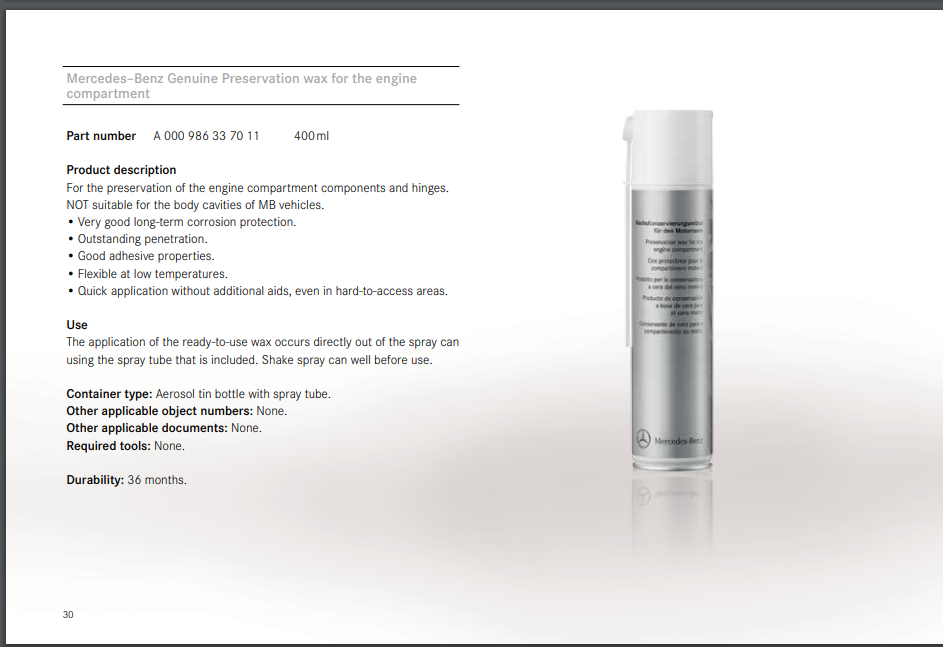

Came across some interesting info on some Mercedes chemical products.
https://www.w124performance.com/docs...nformation.pdf
Seems the wax I was looking at is for the engine bay.

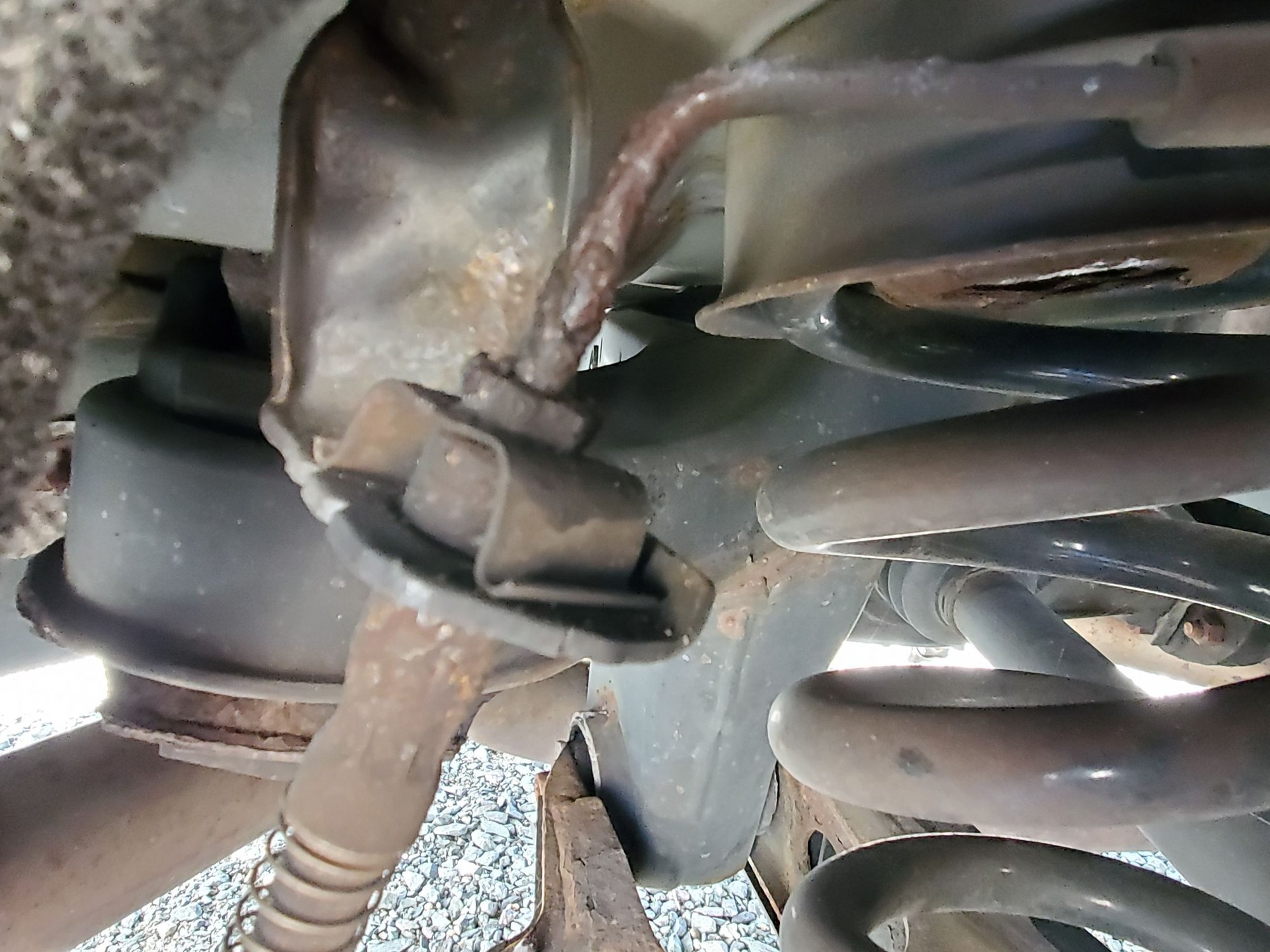

Heres the rear passenger side brake line before I replaced it recently. I got really lucky and replaced it just in time, I think with me just touching the line to remove it caused it to crack and start leaking fluid.
Line was so rusted I couldnt unscrew the fitting and had to cut it and break it loose with vice grips.
New nickel copper line.
The spring control arms are very rusted so I picked up a set of used to install when I get around to it. I think the rear axles will need to be replaced sooner than later.

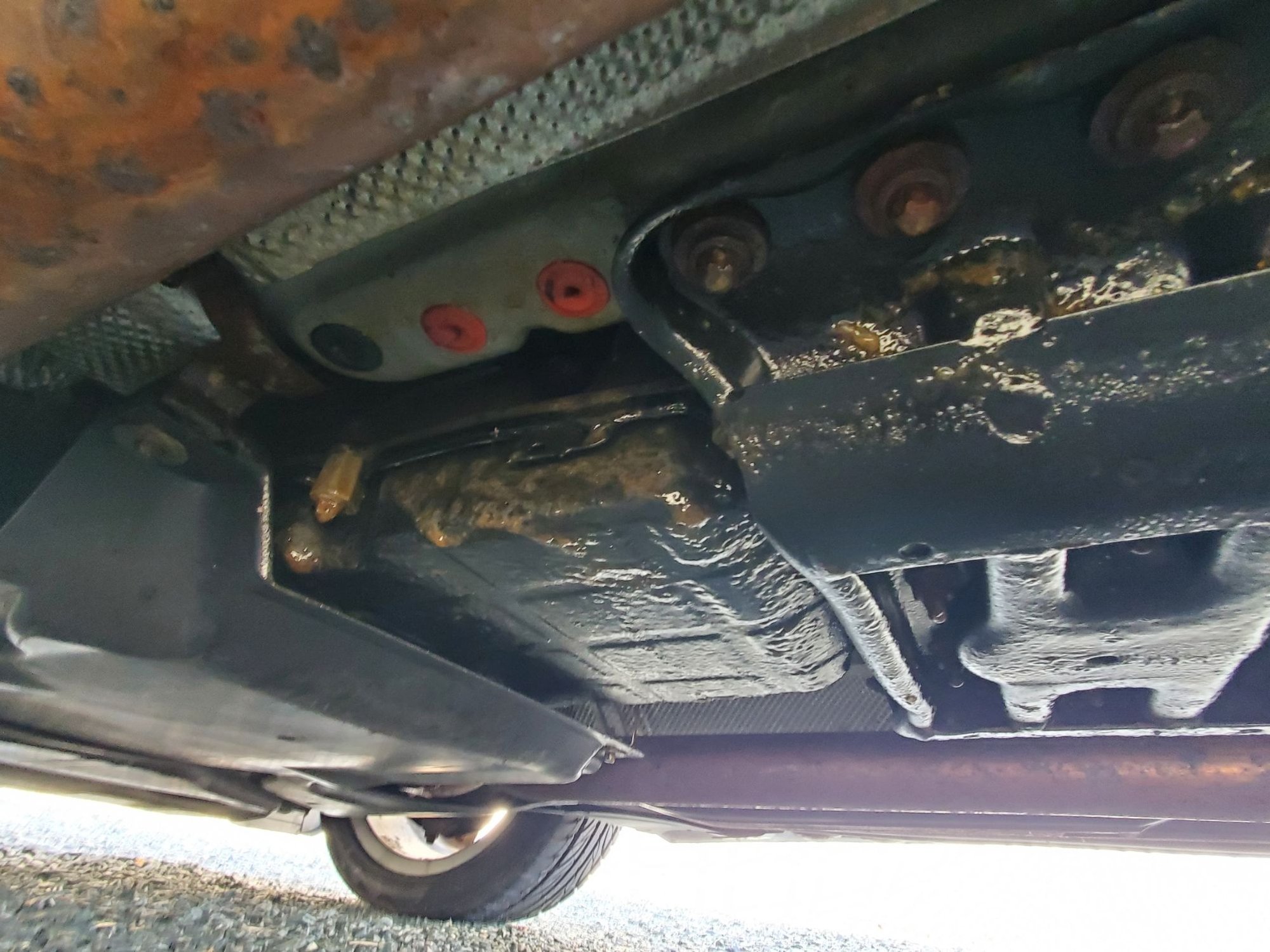

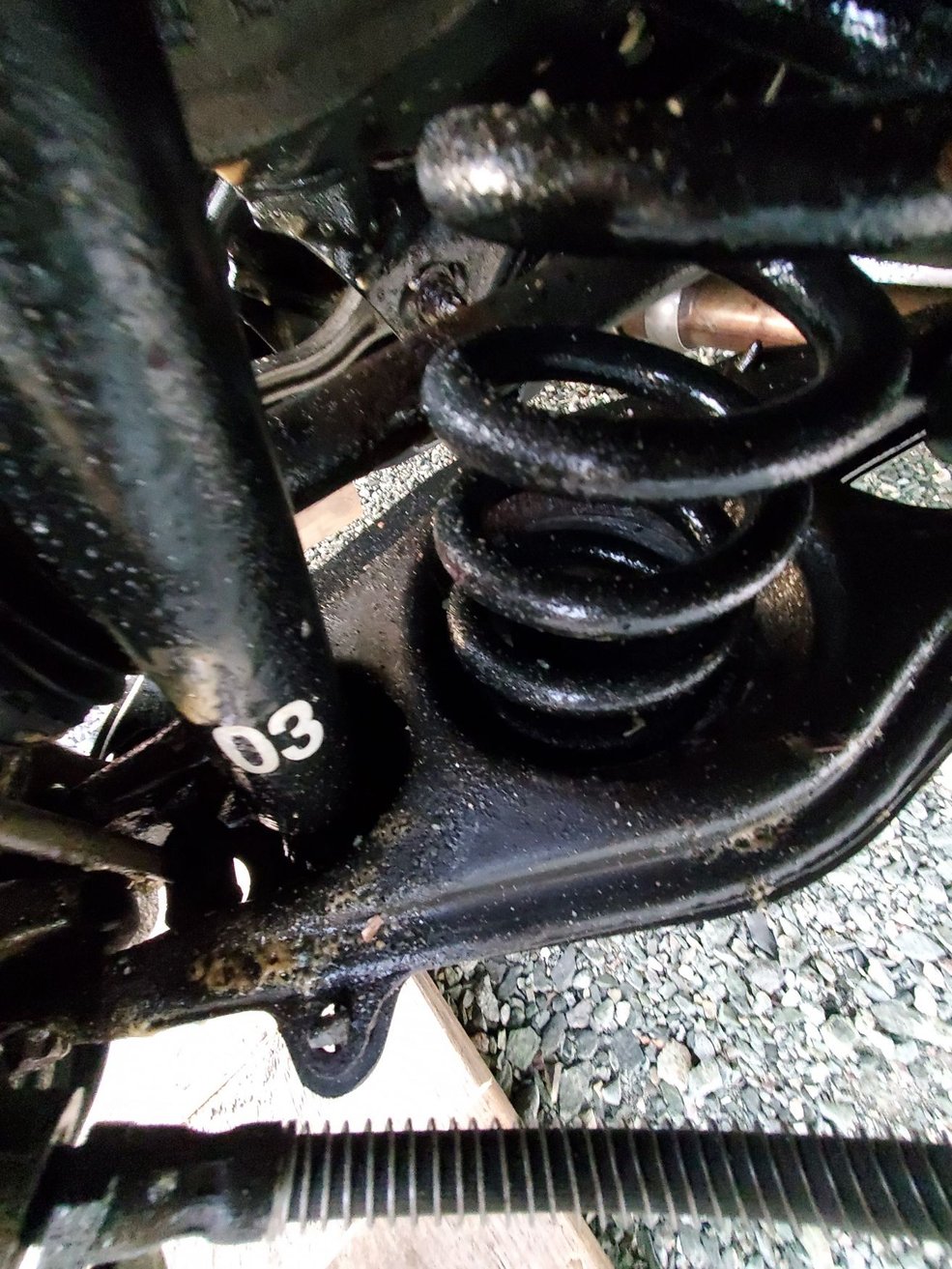

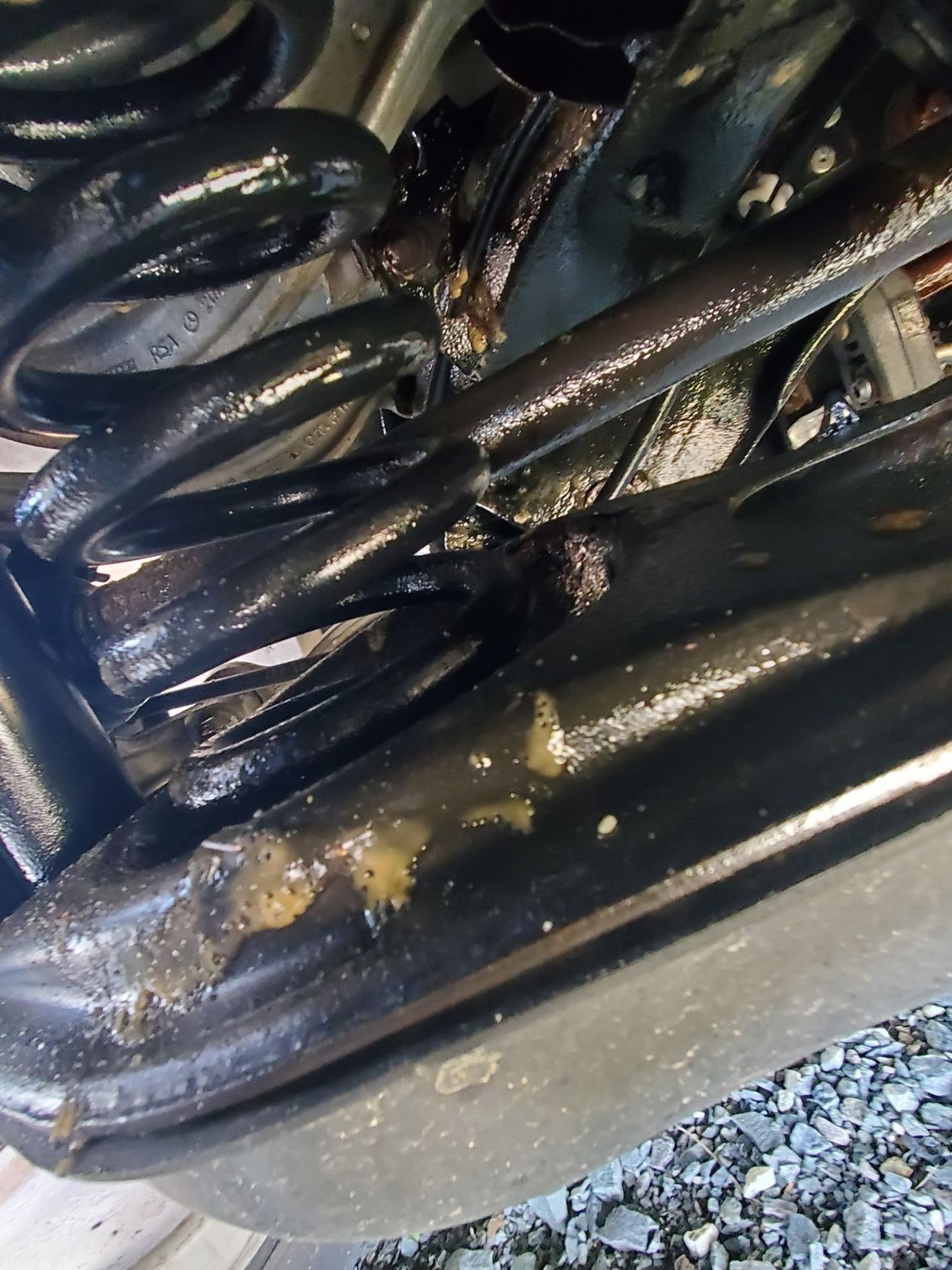

Sprayed one can of the Corrosion X HD and one can of the Fluid Film.
It seems that I got more coverage with the Fluid Film. I started with the Corrosion X by spraying the transmission pan then removed the rear passenger wheel and started spraying and emptied the can. I did spray everything inside my snowblower too. No issues with either spray cans.
Everything looks bubbly. I'll check it again to see if things even or level out. Its in the high 50's F right now and I put the cans in a bucket of the hottest water that came out from the kitchen faucet.
As of right now I would go with the Fluid Film from now on. Depending on how it lasts thru the winter. I still want to do the front so will get another can of the Fluid Film later today. I want everything to dry.

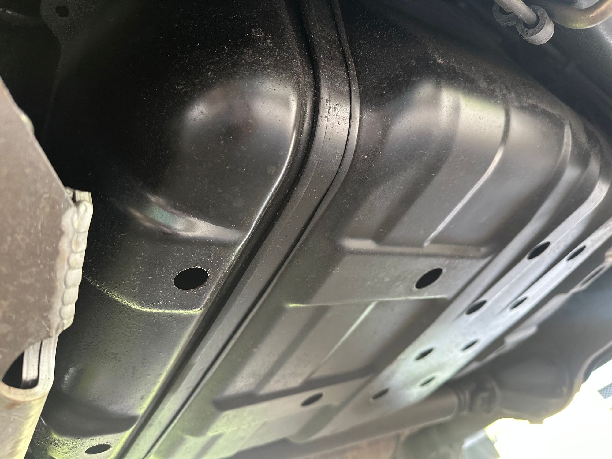

Below sprayed with the Fluid Film:

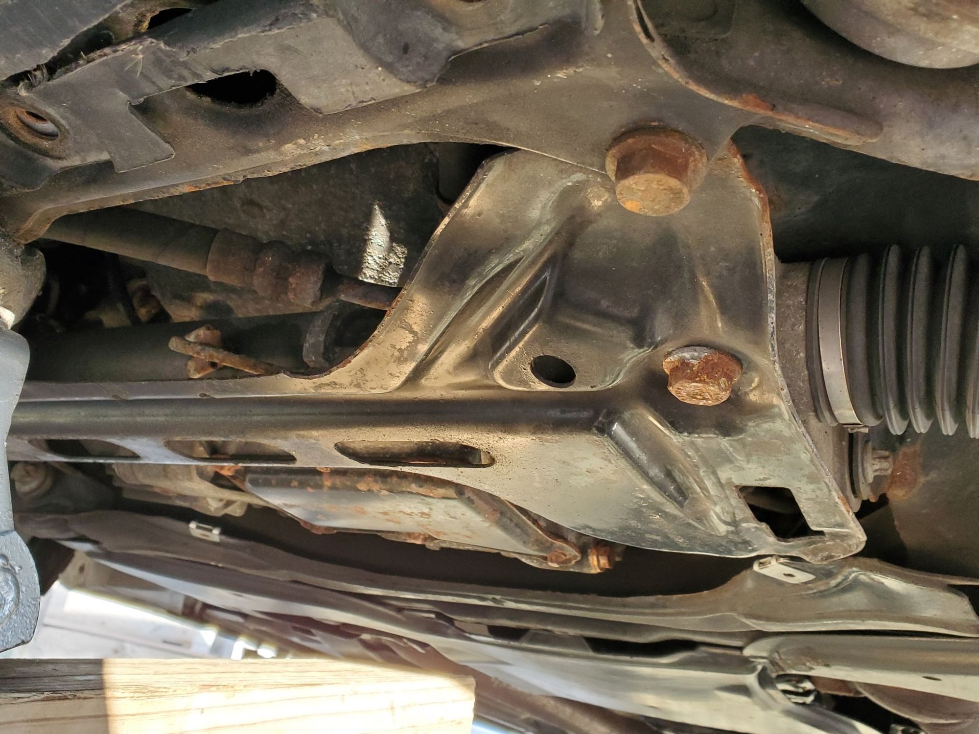

Some rust at the rear bumper under the car:
Started with the Corrosion X under the car, alot of bubbles. Hope it evens out.

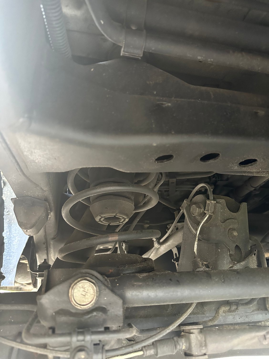

I noticed some holes in the subframe, used the Fluid Film straw and sprayed a little inside.

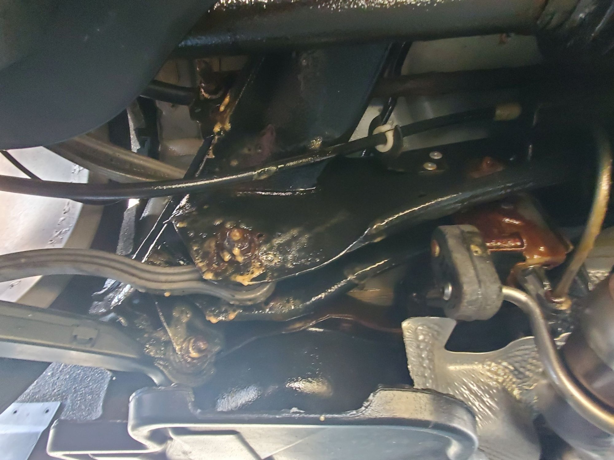

Corrosion X HD on the transmission pan and mount area. This will be good to keep an eye on since the pan was brand new and i replaced it only a few months ago.

All of these products that are thin that come out of the can do bubble off the solvent. It will creep and get thin and even and then once it gets covered in dust will get a satin finish. It’s always best to do this in warm weather. Warm weather also gets rid of the smell more quickly. Fluid film is a waxy product so yes, the underside will have a film on everything that is dirty when working on the car, but I think I’ve mentioned previously that a mechanic with soft hands will complain regardless of whether the car is rusty or covered in fluid film, and the fluid film is better for the owner of the car so just find the right mechanic that doesn’t complain about the job they’ve signed up for. Right now, Home Depot has cans of fluid film for $5.50 And it’s not easily seen because it’s listed in their clearance aisles. The first time I did my truck which is a full box frame truck took me about six cans to do everything inside and out. Every year thereafter, I use 2 to 3 cans for touchup.. I really can’t express this enough that an ounce of prevention keeps these cars in top condition for many many many years. The only warning would be to say not to get excessive amounts of the fluid film on any rubber seals that are not built to be exposed to oil such as headlight or body seals. I’ve personally never had an issue but vehicles with cheap seals may see some swelling after a long exposure. For small bolts or areas in the engine, spray some of the fluid film and use a small paintbrush or sponge to paint the film on to metal in tight areas

So far the side that I used the CorrosionX HD on seems to have alot of sand stuck to everything. Looks like its thick, like a wax but its oily when touching it.
The metal bumper support that I sprayed looks alot better. Before it just looked all rusty. Wish I had known about this area earlier to spray it.

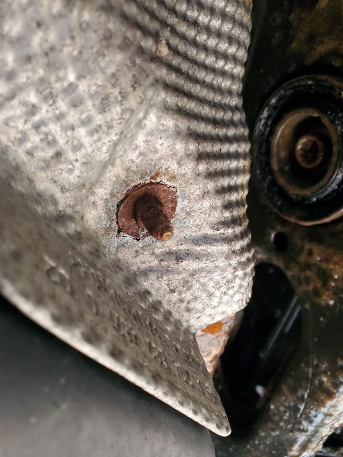

All the metal nuts holding the metal heat shielding on are rusted and the shielding is cracking around them. These things are $4 each to replace. I tried the plastic nuts used in the wheel well liners since I have a big bag of them and they seem to be holding up.

Side I used Fluid Film on does look thinner compared to the CorrosionX HD, which it probably should.

I picked up some Surface Shield and sprayed a little in the rear again. Pulled the drivers side wheel well liner to spray the hard brake lines. Seems to spray on smoother and doesnt smell as bad as Fluid Film.
Now im pulling the front wheel well liners to inspect the brake lines and spray a little surface shield. i have a feeling that the drivers rear brake line has been replaced at some point since its in better condition than the passenger. Im trying to locate the sunroof drain, thought it emptied out in the area but cant find it. I can see the drain for below the windshield.
