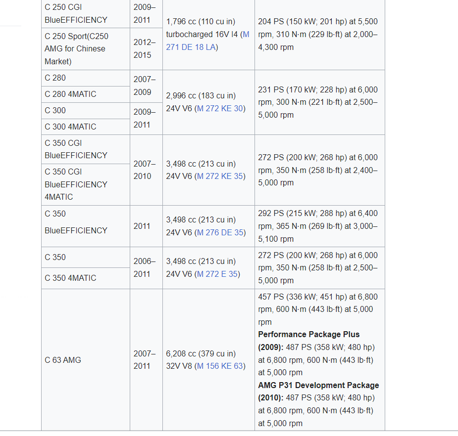

I dont really know so looked on wikipedia: https://en.wikipedia.org/wiki/Merced..._C-Class_(W204)

Thanks, Tim.
Guess I could’ve done that too, but that clears up a misconception I had that some C 300s actually had the 3.5 in it.
I’d be looking for a C350 if so.

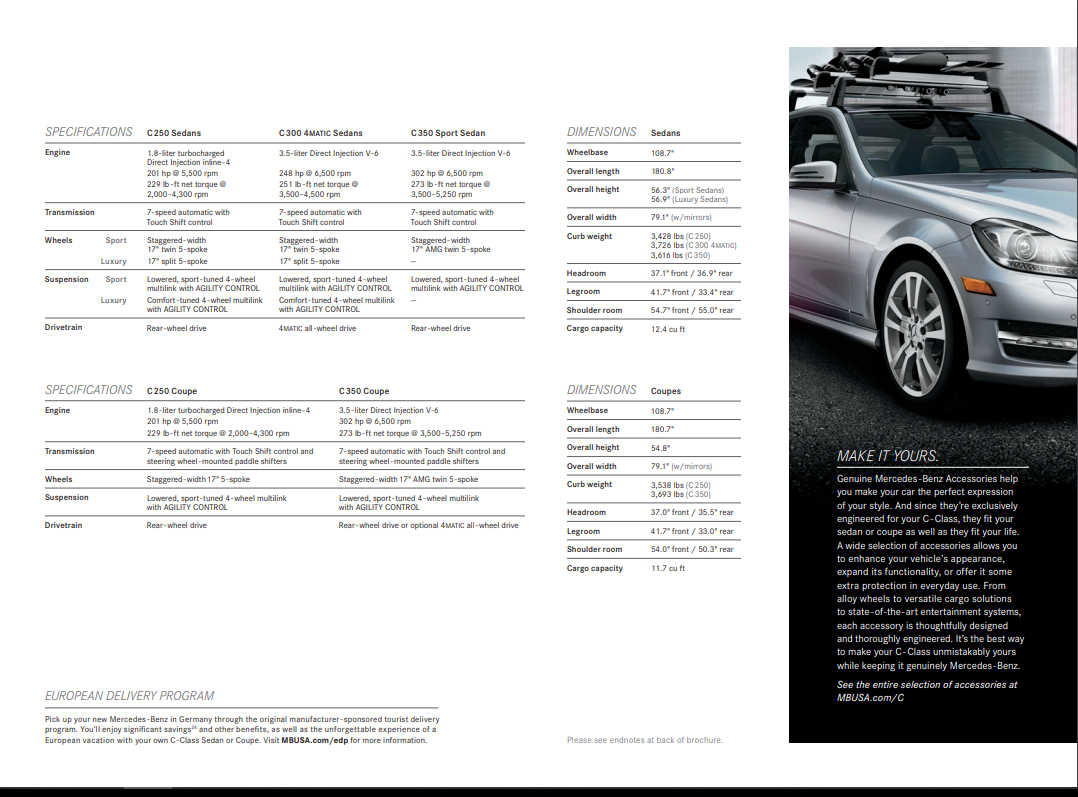

You can see all the different year brochures here: https://ragtop.org/mbbrochures/2013.html
I see 2013 the C300 4matic has the 3.5. Though you mention wanting rwd.
Thanks, yes - I'd like to avoid a problematic transfer case and train to RWD mastery and keep it simple.
I just read elsewhere on this forum that some 2012 c300s were upengined M272 E35s and de-rated, in effect an mis badged c350. This is very helpful, it was 2013 and the M276.
I'll just go find an 07-11 with the M272 e35 and make sure the timing gear isn't affected.
