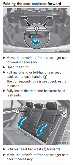

Curious, but does your rear seat backs fold down? If so, then you do have sensors.
That's actually a good question, all this time I thought there is no fold (or I just don't know how to do it). Likely it doesn't fold.
If they do, there are levers within the trunk at the top.
