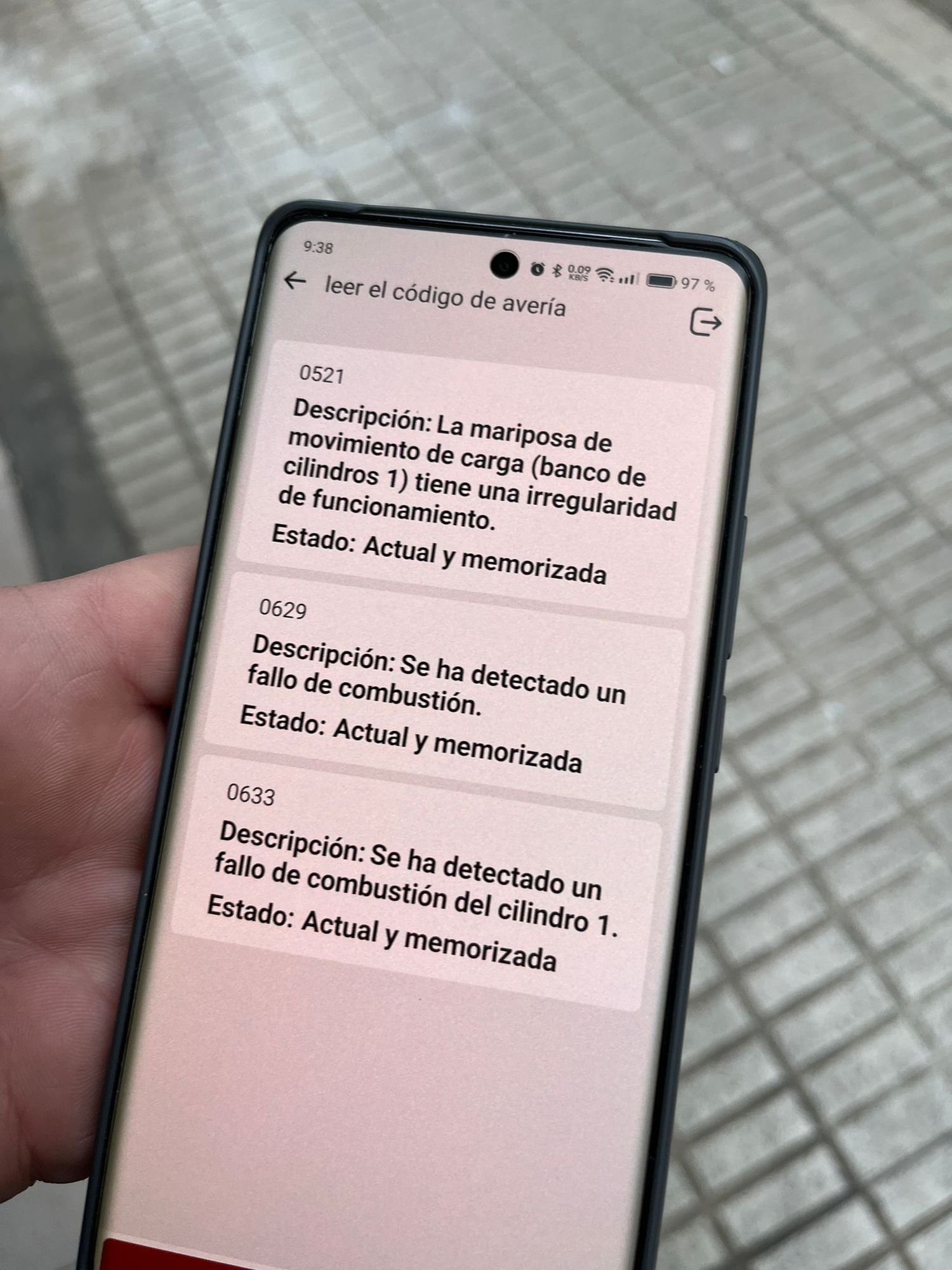

I recently ran into an issue with my car and I’d appreciate any advice you can give. The car started shaking slightly while idling, and shortly after, the yellow check engine light came on. I ran a diagnostic scan, and these are the codes I got:
  • P031: Misfire detected on cylinder 1
  • 0521: Irregularity in the intake flap operation for cylinder 1
  • 0629: Combustion failure
  • 0633: Combustion failure in cylinder 1
Given these codes, I’m not sure where to begin with the troubleshooting. Does anyone have experience with similar issues? Here are a few thoughts I had but would like confirmation or other ideas:

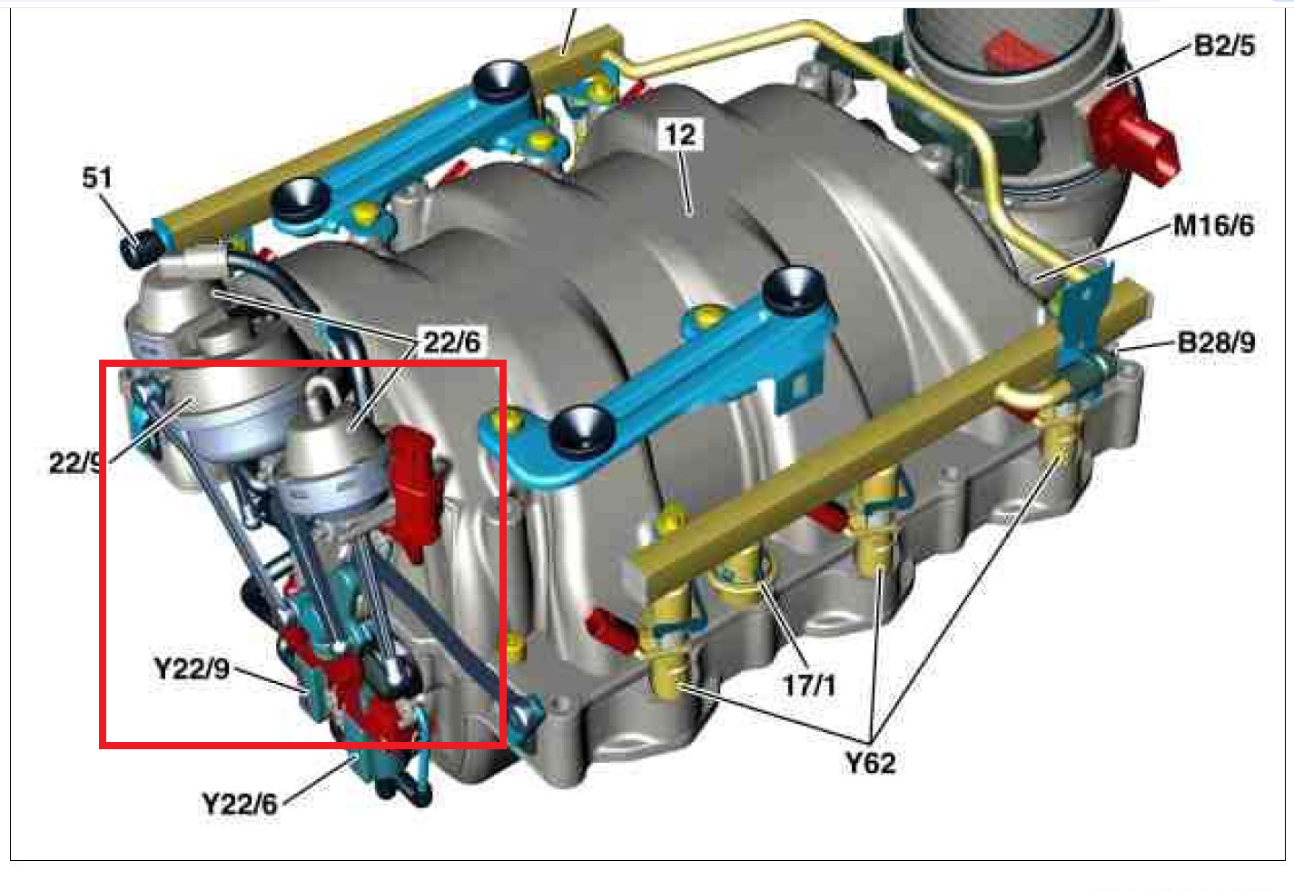

From my quick searching around i would inspect the front of the air intake and look at the levers that operate the flaps, see if any are broken or popped off. Shown in the red square below:
For the misfires you may want to check fuel injector 1.

The root cause appears to be your intake plenum flap disturbing airflow.
Address this first.

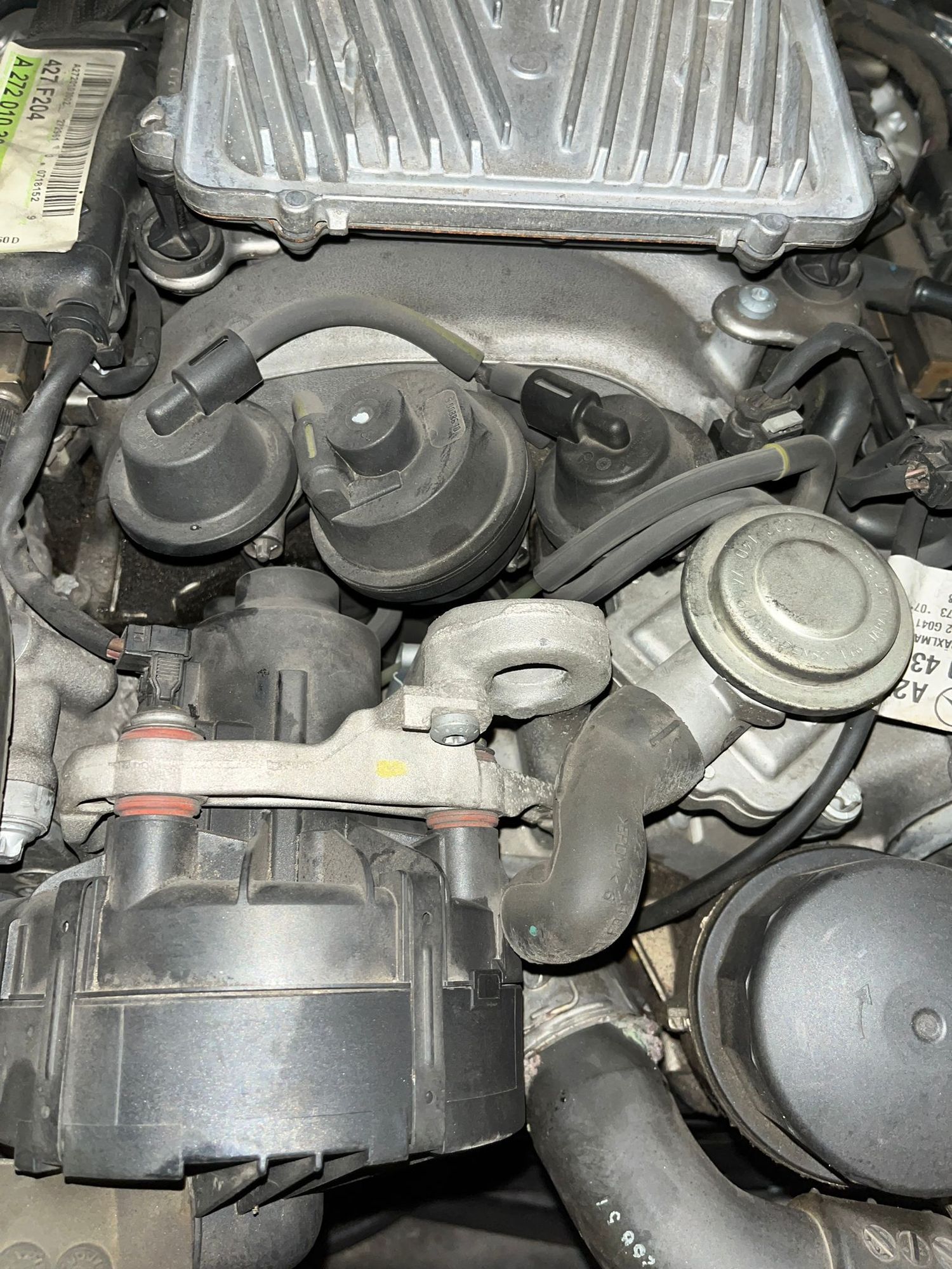

I've tried checking the intake piece but I can't see much. What I have been able to observe are oil leaks in that area.

If you take off that secondary air pump, you will see it all. Remove the hoses, and I believe it’s 3 T30 screws holding it in plus an electrical connector. That should allow you to see all the rods. The oil leak I’m not too sure on, hopefully someone else on here has an idea. It sounds to me like your intake manifold may be contaminated with oil but I’m not sure.
You could check the PCV on the rear of the engine and see if there’s oil in the hose leading to the throttle body. If there is, replace the drip pan and centrifuge cover. Easy job, just remember that the drip pan bolt is reverse threaded, so you have to twist clockwise instead of counter.
Also, it looks like you may have a leak at your upper radiator hose going to your thermostat. Clean up that crusty coolant and see if it comes back, or if it’s an old leak.

You should be able to use a flashlight and look down to inspect the front of the intake manifold. use something like an o-ring puller or dental pick and run it along the levers to check if they are still connected. But i guess you can remove the secondary air pump if its in the way.
I replaced the oil filter housing gasket without messing with the secondary air pump. To get the thermostat off I bought a 1/4" drive E10 socket and used a 1/4" drive extension to get the top bolt off. It is a very tight fit, a 3/8" drive socket wont fit without removing the pump.

Today I took out the air pump and checked the black plastic part and the levers and everything seems to be fine, although I don't know if there could be something wrong inside.

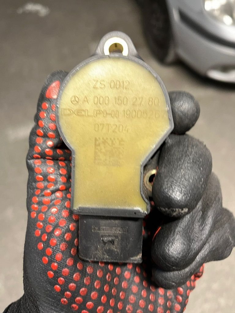

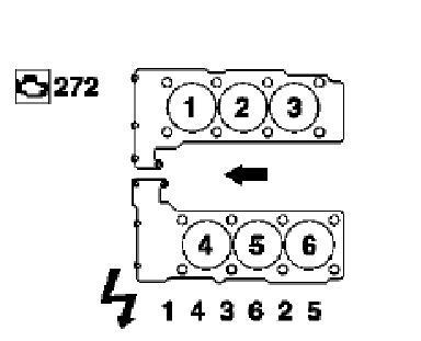

I bought a diagnosis, and I changed the coil from cylinder 1 to 2 and the fault was transferred to cylinder 2.
So I think the coil must be defective so I'm going to try buying a new coil, any recommendations?
I had these that I think are the standard ones with 208,000km
Greetings and thanks again.

Delphi GN10235 is what I used for replacement, they’re original equipment. It’s the same as that but just without the Mercedes logo. They’re pretty cheap on RockAuto

Hello everyone,
I’m very happy to say that I have finally solved the problem!
It turned out to be the ignition coil, which failed at 200,000 km.
I have already ordered the remaining five coils.
I was lucky because the issue could have been with the intake or even the ECU, which would have been more complicated and expensive to fix. Fortunately, this was a much simpler and cheaper solution.
I’m sharing the steps I followed in case they help someone else:
  1. Replace the spark plugs – In my case, it was time to do so.
  2. Check the intake mechanism – By removing the air pump, you can verify that it’s working correctly.
  3. Swap the ignition coil location and run a diagnostic test.
