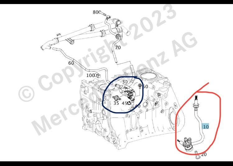

The part of the system you refer to as “Some valve pipe below the intake manifold” is referred to as the WOT system in the parts manual. I’m assuming this means wide open throttle, too. It’s got a check valve and maybe what is an accumulator in the line. I never had to service it on any of ours, but I suspect it only has a function under certain conditions of crankcase and manifold pressure. The parts don’t look expensive, but it’s difficult to get to.
Awesome thanks.
I suspect the issue is somewhere here:
The intake manifold has to be removed to access the valve. The check valve can be purchased as an assembly with all the associated hoses. One of those hoses is hard plastic, which tends to break when you remove the manifold.
