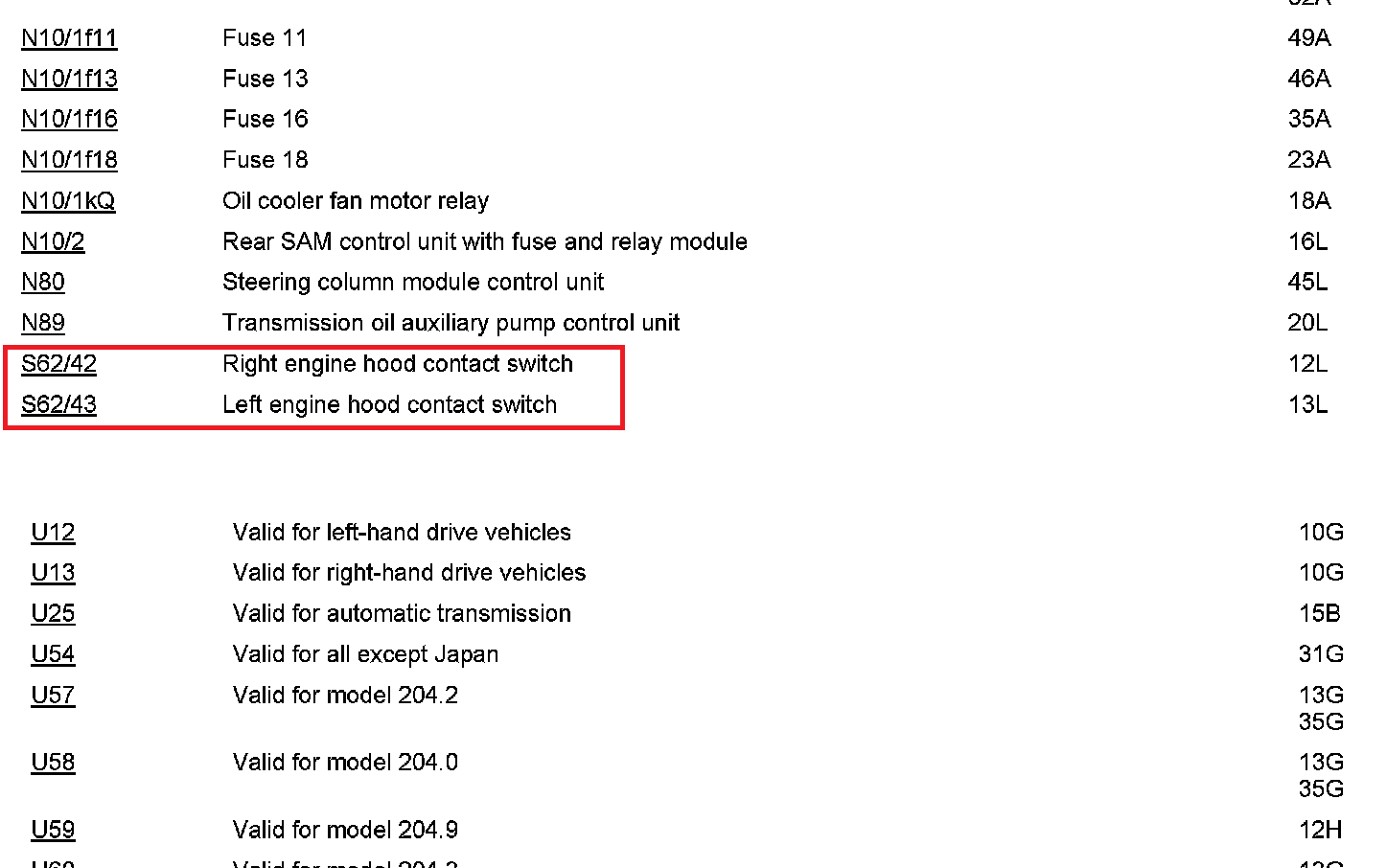

I would get out my multimeter and test the connectors at the sensors. Im not really sure how they operate, im guessing closing the hood closes the circuit. There should be two wires coming from the connector. The ignition may need to be turned to on to test.
Check for power. If no power check each ground wire for continuity.
I looked up the wiring diagrams. Its for my 2010 but should be similar or the same for 2012. Brown wire is the ground, each sensor has different ground locations. I believe the right sensor + goes to the front SAM (N10/1) or to the front Prefuse (F32), the left sensor + goes to the rear SAM (N10/2).
Not entirely sure. The diagrams are confusing.

Here's something to try maybe?
