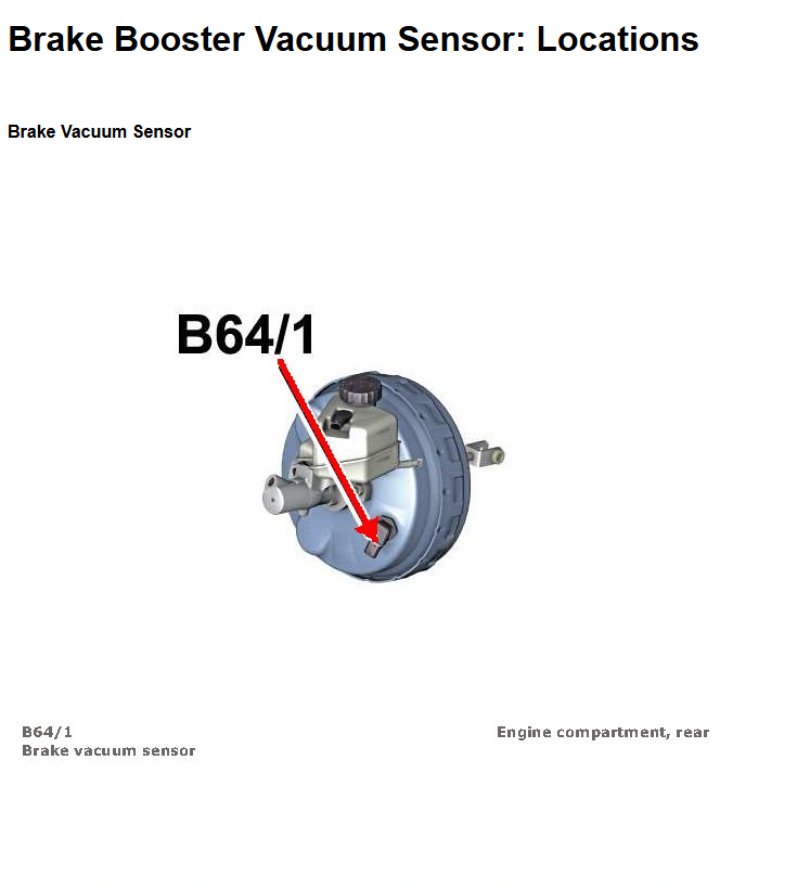

If it is low/no vacuum im surprised an abs.esp warning doesnt pop on. I see there is a vacuum sensor on the booster.

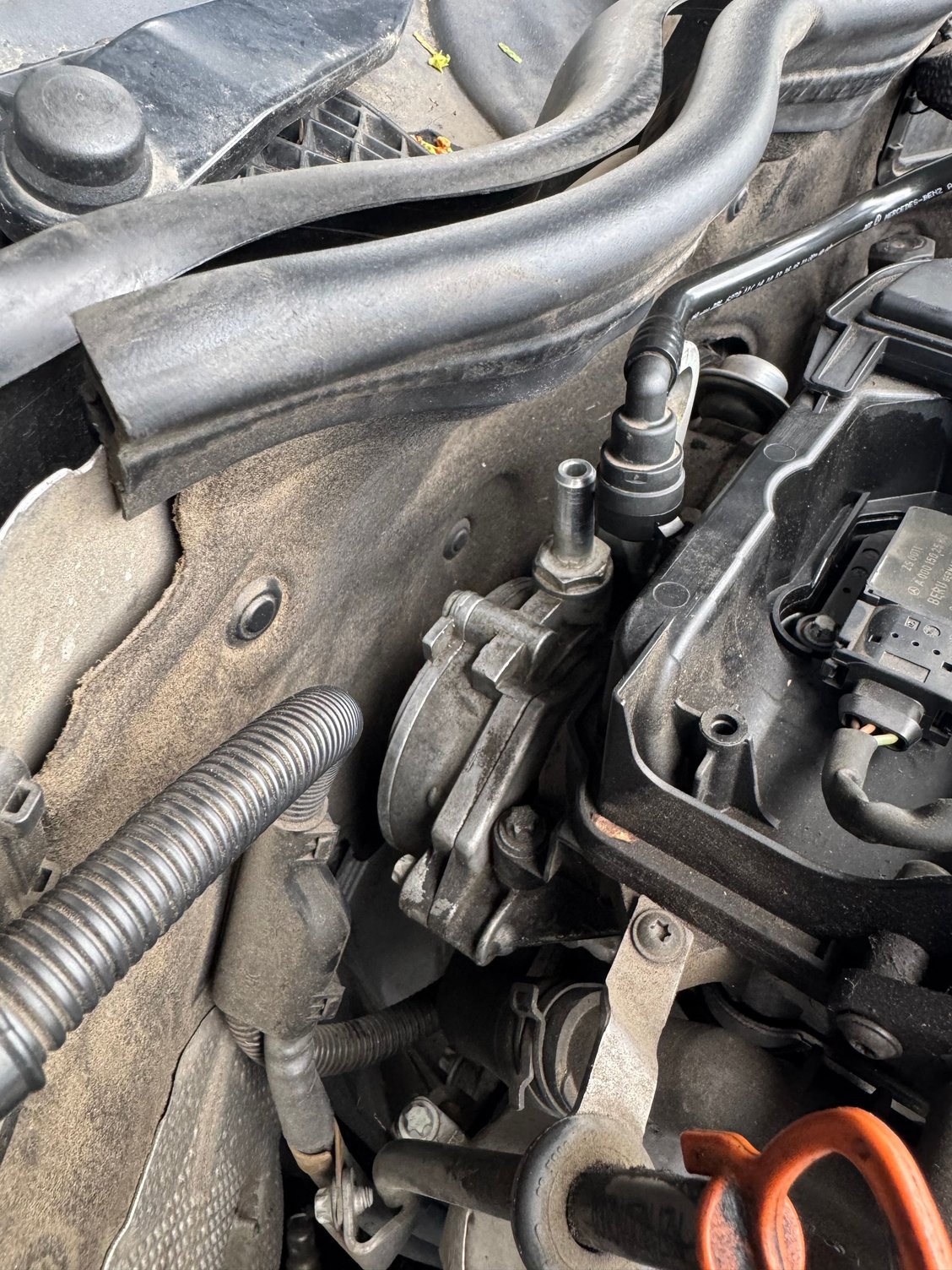

okay guys so I was able to get the house off all the way inspected it no damaged I turned the car on and put my finger over the vacuum valve and didn’t feel nothing at all so I’m thinking it’s gotta be that right? I also noticed the big plug part that goes into the break booster sticks on a bit I tried to push it as hard as I could and it wouldn’t budge I think it’s suppose to be like that

to clarify I took the hose off and turned the car on didn’t feel anything and inspected it nothing wrong with it I put it back on I just thought it the vacuum was broke the AC wouldn’t work at all but it does I’m new to working on cars and wanna try to fix it myself before taking it in to the dealer

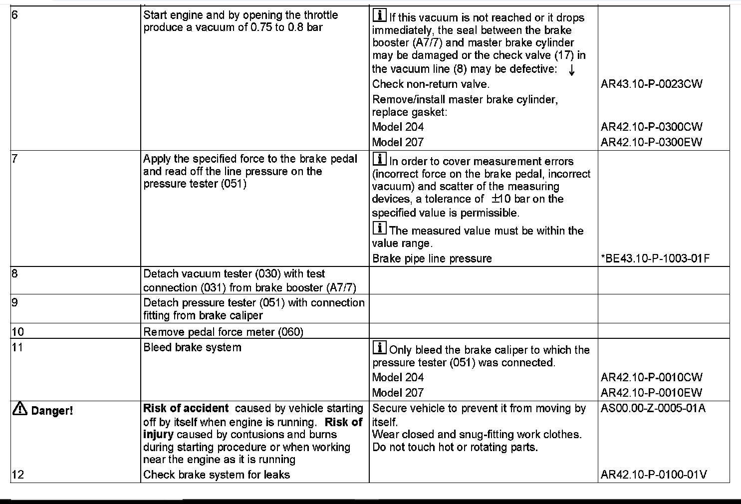

I would try to follow the procedure noted above. I got it for the M272 engine but dont see why it would differ for other engines. It says vacuum to the booster should be around 0.75- 0.8 bar under throttle. Thats not alot, around 14psi. Not sure how much you would feel it just using your finger. And thats from the booster port, the other port is smaller and not sure how much pressure that is rated for.
I would be scanning the car first with my scanner for any fault codes. Then I would probably buy an inexpensive pressure gauge and try to see what the vacuum lines show at the booster.
