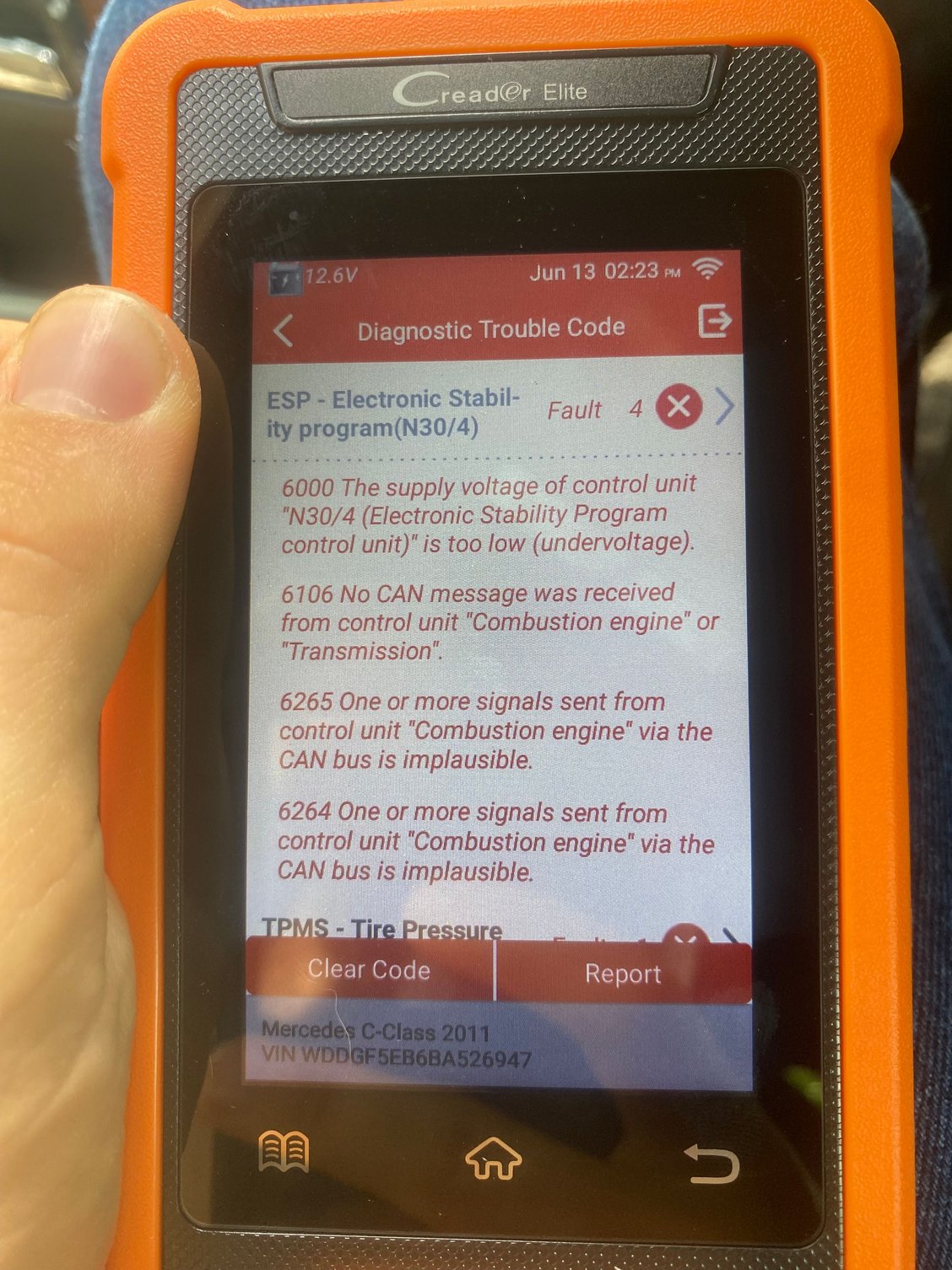

Made a new tread to see if anyone can see what these codes are. I know about the lean code cause I made a previous tread about it (https://mbworld.org/forums/c-class-w...ml#post9176364) it explains what I have done with it and updated but a guy recommended me another scanner called launch and I'll post the code on what I got here again so I think it might be a vacuum leak or something but I know I put the intake manifold on properly.
this is an 2011 Mercedes-Benz C300 and the work that been done with it below.
This is the codes found:

Did you have the battery disconnected? Have you tried clearing the codes and see which ones return?

EXTREMELY LOW VOLTAGE
ESP + ECU + SAM + .... are reporting voltage below 8.5Volt.
Ask yourself: WHY/WHEN/HOW that event happened: while driving or parking ??
Low voltage kills lead-acid batteries. Keep them well charged up
