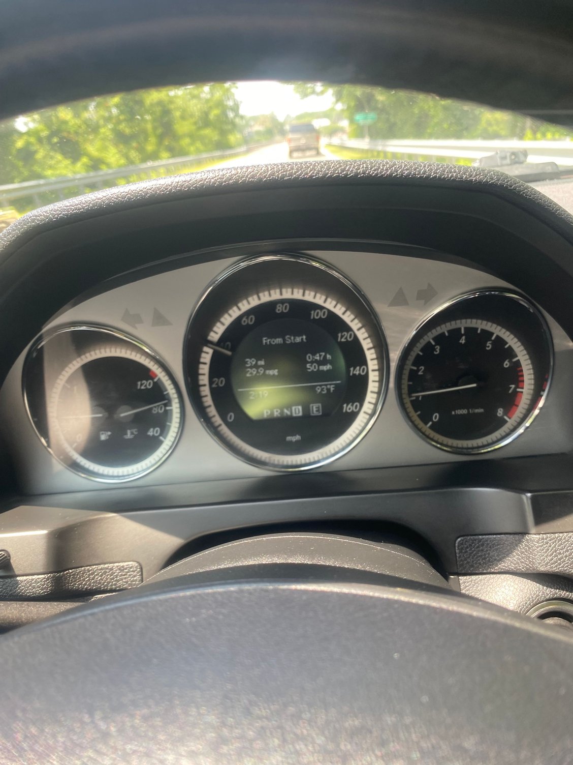

Ok so update I was looking around in the engine to see if there was going about the June 1st to make sure I can make it down to the airport (family and I currently on vacation) and found that I forgot the hoes that connects between the MAF sensor and throttle body (I thinks it called the crankshaft?) and that help with it from dropping as much.(kind of forgot cause it been a few day) but I do have a few questions like I use cruse control a lot so when I turn it off like letting of the gas is it supposed to go down a little to like for example from 1900~ to 1780~ at like 60~ mph? It was like this when I bought the car and I thought it was normal but honestly after look more into the car I’m not sure. My second question is what is the fuel economy on this engine supposed to be? Online I’m being told 24-26 mpg another said 30.4, and based of buying this car was saying 17 city and 21 highway. I get it based of your driving but some days I’ll will get like 31 mpg and then other days 23-25(I do live in a the middle of nowhere with a bunch of old people around so idk I just would like an idea of what I should be getting) I’ll give more updates when I get back from vacation.

I have the M272 with 160,000 miles and I drive normal, no speeding around or racing the engine. Around town the average MPG will be around 19-22. Cruising on the highway 25-28. Thats combined miles driven from start.

Ok I got ya, I’ll send pics of mine when I get back cause the only time I would get 23~ is when it’s raining or something. Any other time it about 27-29~ though I do remember one time I was heading home from a friends college and was getting like 31.4 but also and check engine like that bank 1 was rich. So idk what to really expect out of an V6 lol

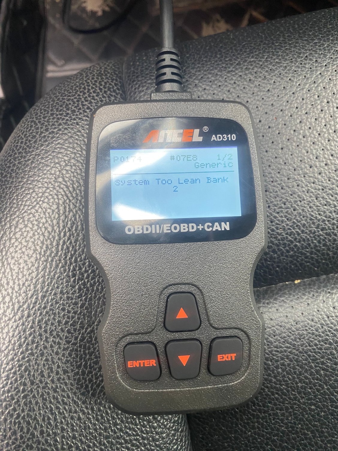

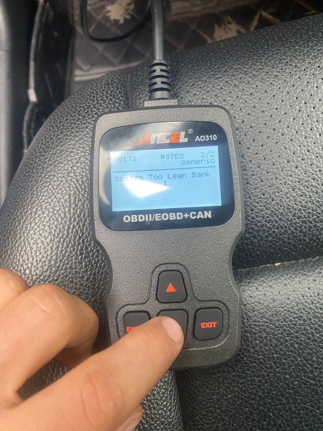

Ok I got you. probably will try that out and I also had gotten that Launch diagnosis. i'll show you what I get when I check my car today.
also I drove the last few days and yesterday and got about 28-29 but later yesterday I got the same code again that it was too lean.

All right here’s what I got from the launch diagnostic:
