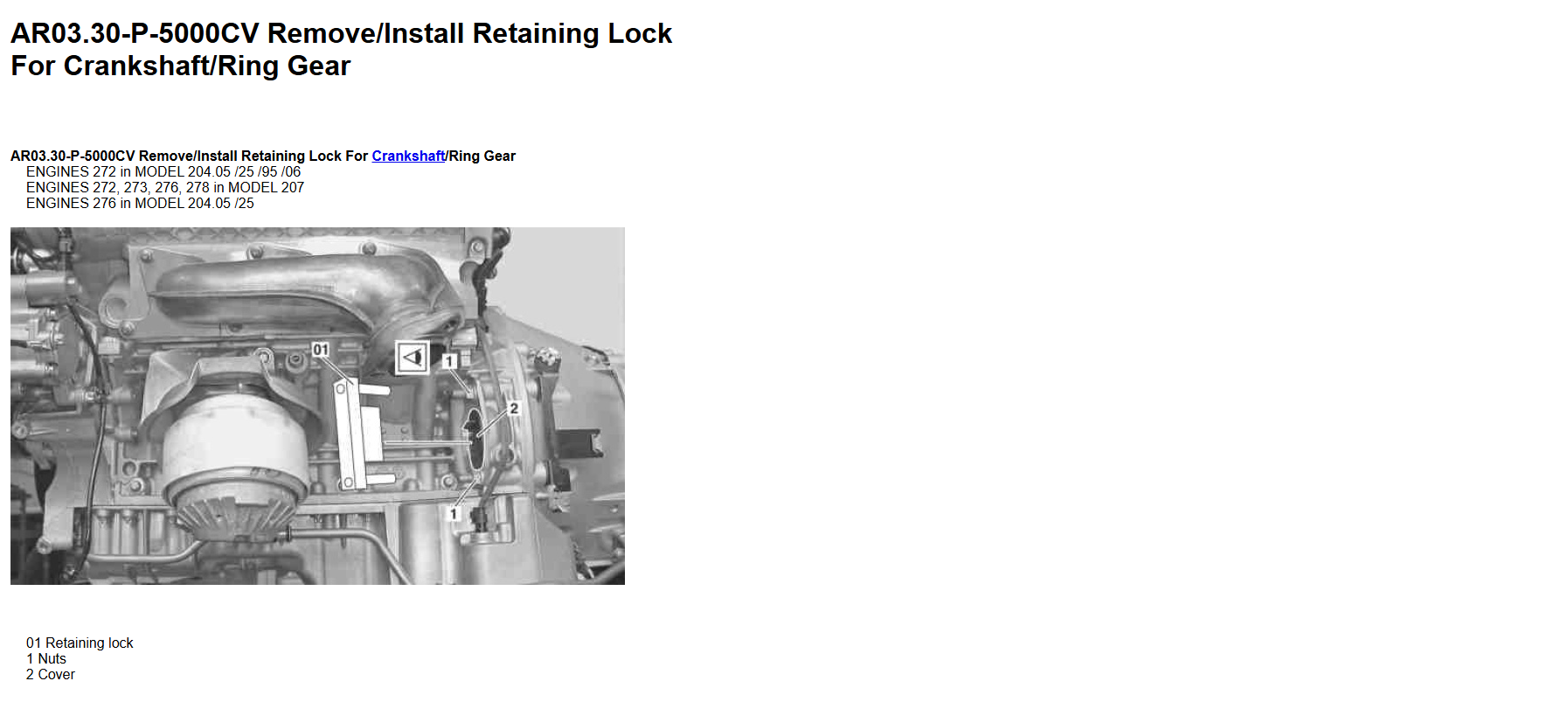

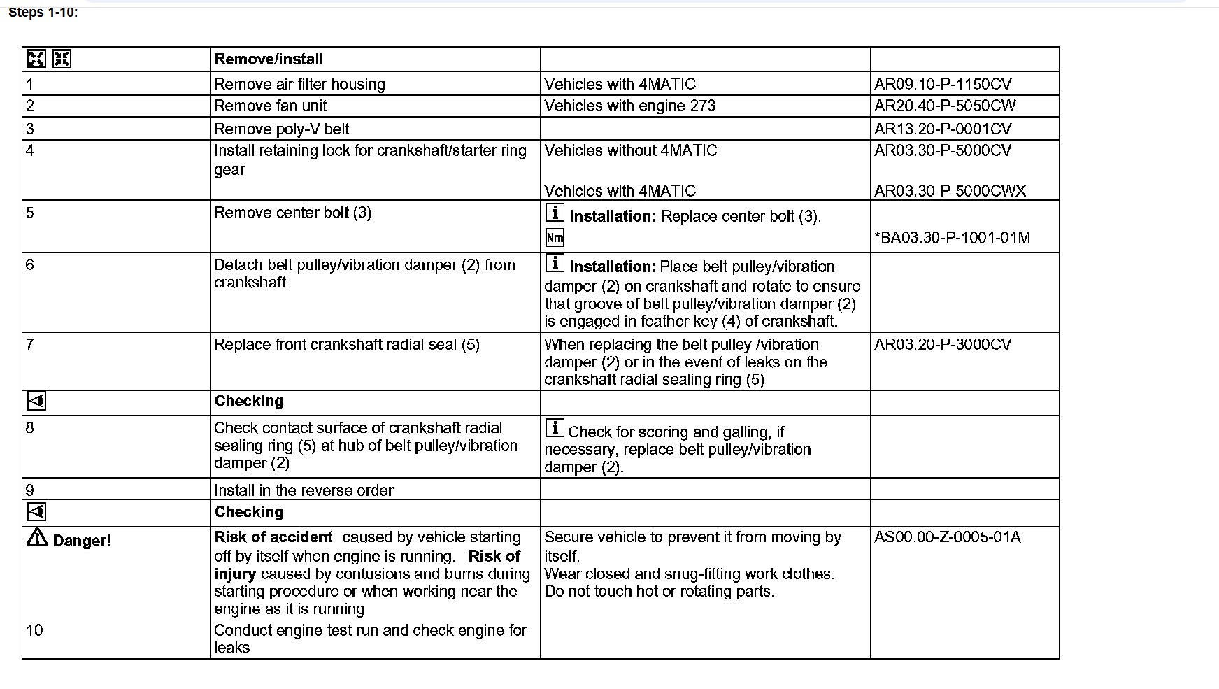

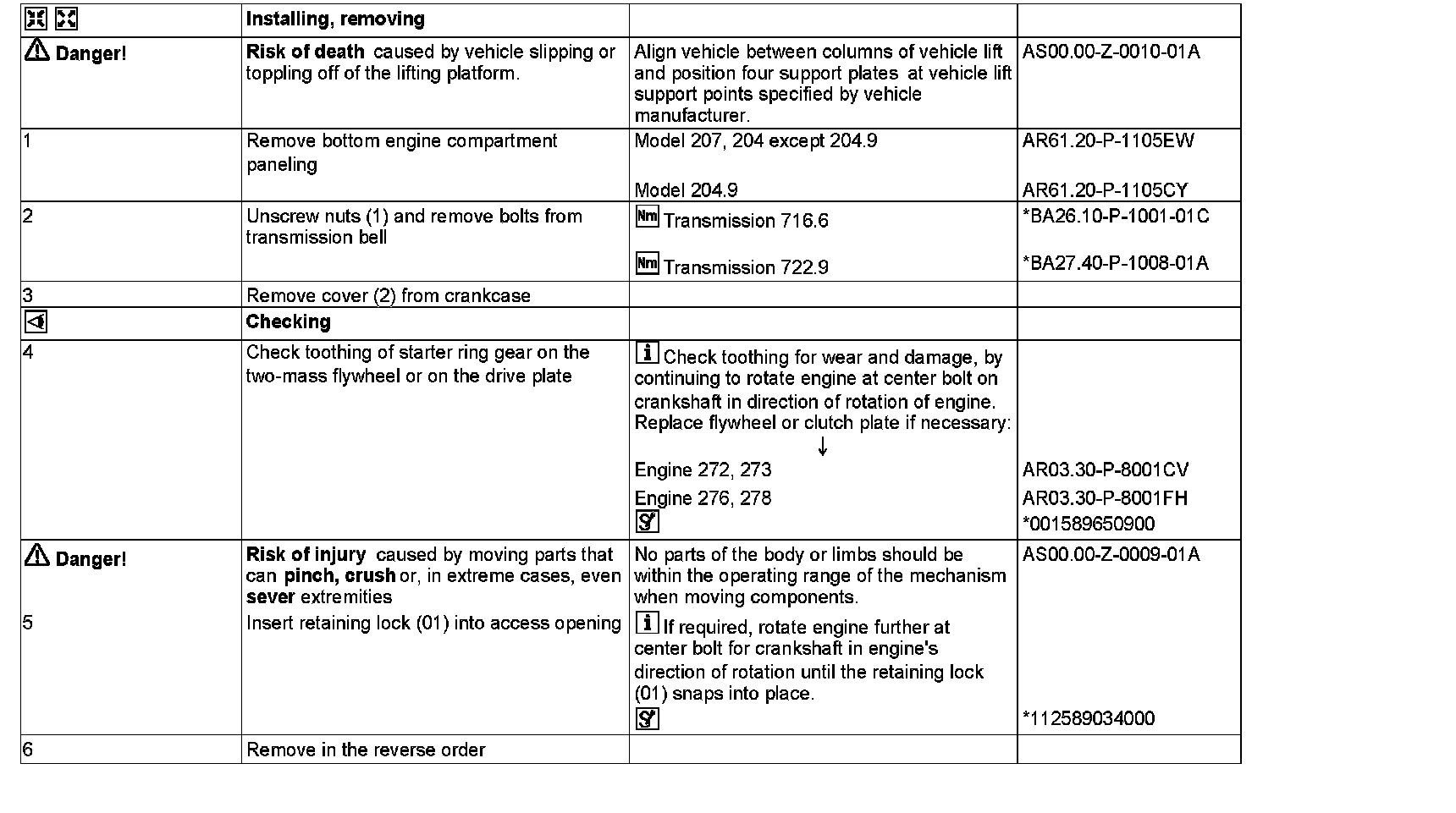

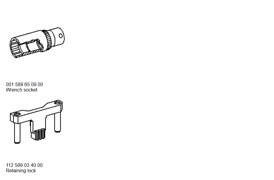

Will have to look at your specific crankshaft pulley and see which holding tool you will need. Some pulleys allow for the tool to hold the pulley itself, or if not theres a part you install to hold the flywheel at the starter.

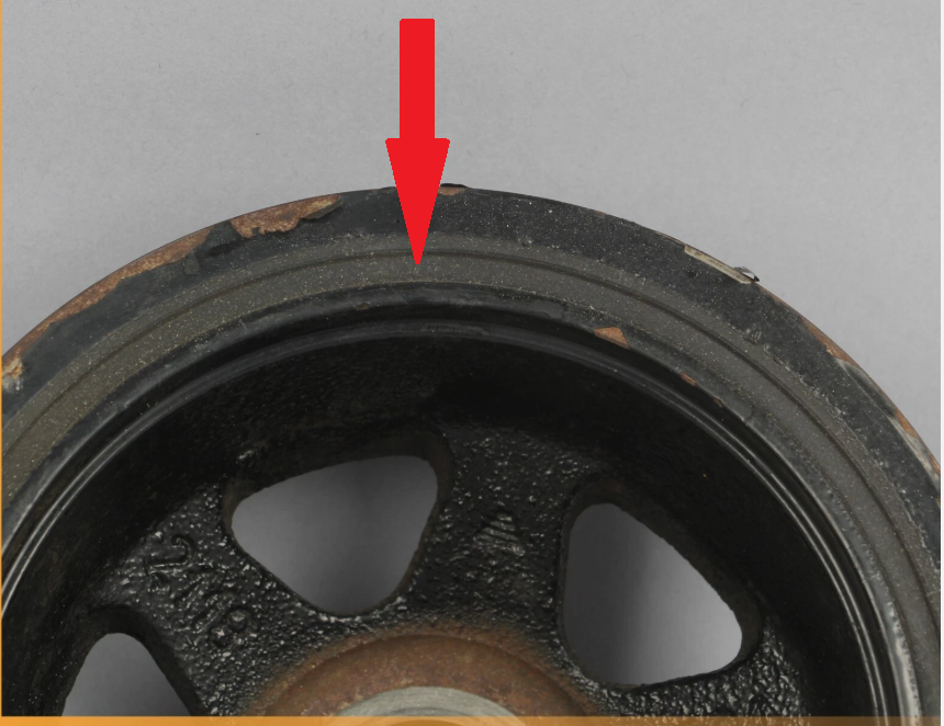

How does the pulley look? Awhile ago I was thinking my pulley was bad and wobbling but seems it was an allusion with the rust on it and some areas of paint removed. I cant find it now but I came across how to inspect it, basically check the rubber for cracks. To see better i stuck my phone down in there and snapped a bunch of photos to look at on the computer screen. Turns out it was in good condition.
Not second guessing the mechanic just want to be sure since it does look like a pain replacing.
I was surprised at the instructions since my starter is on the left/drivers side of the engine. Maybe because its 4matic?
My pulley looks like the one below. Check the rubber for cracks.

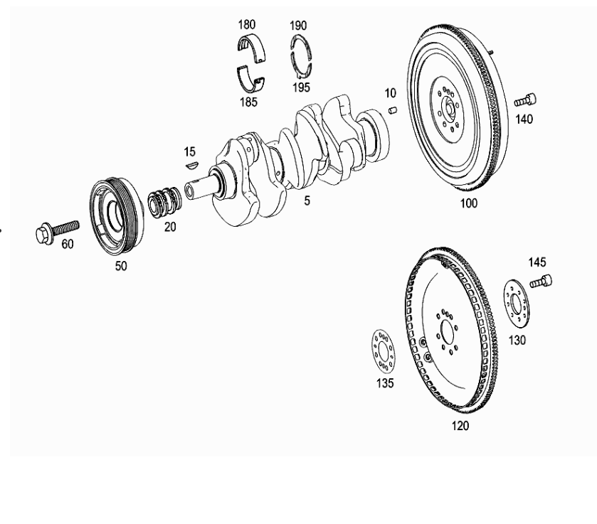

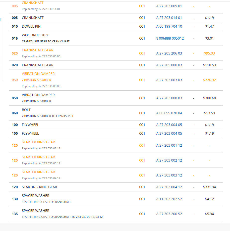

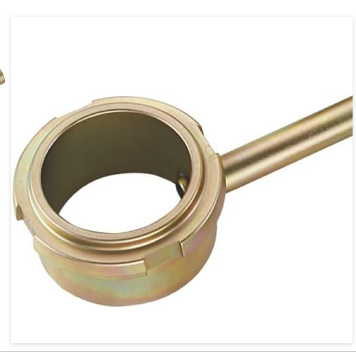

Do you have the 272.961 engine?
Cant really tell what pulley it is from the photo. I found part #'s for the 272.961. Pulley part# 2720300803 or 2730300803

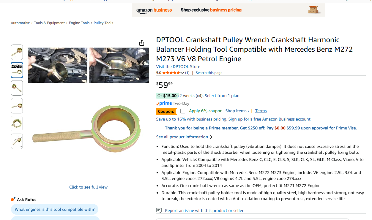

Looks like they have the tool that will hold the pulley.
