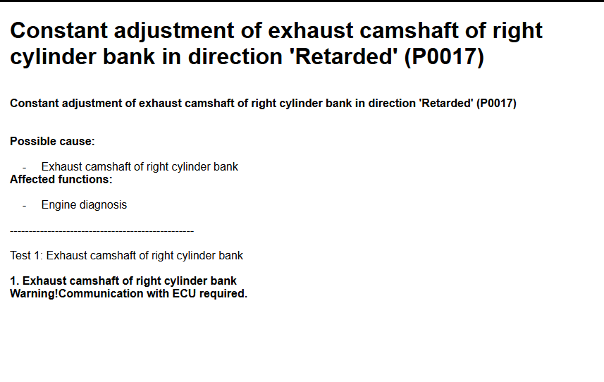

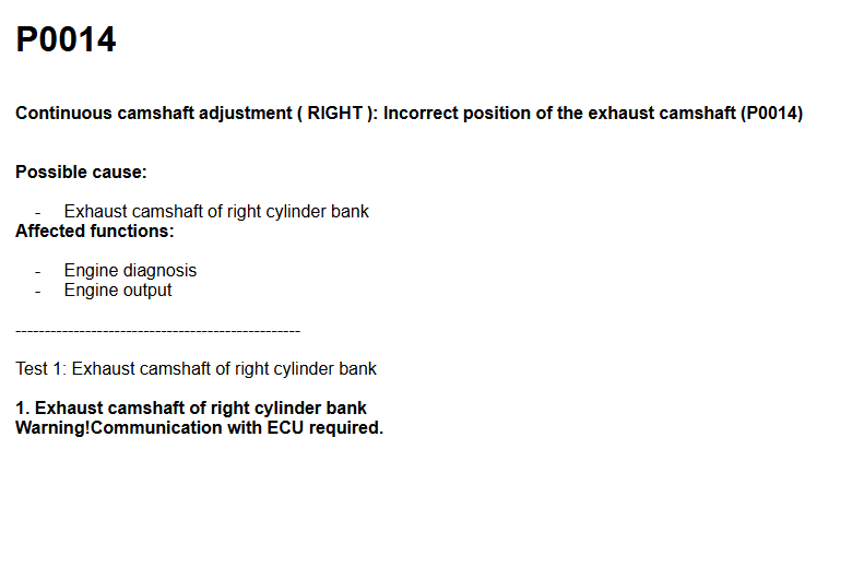

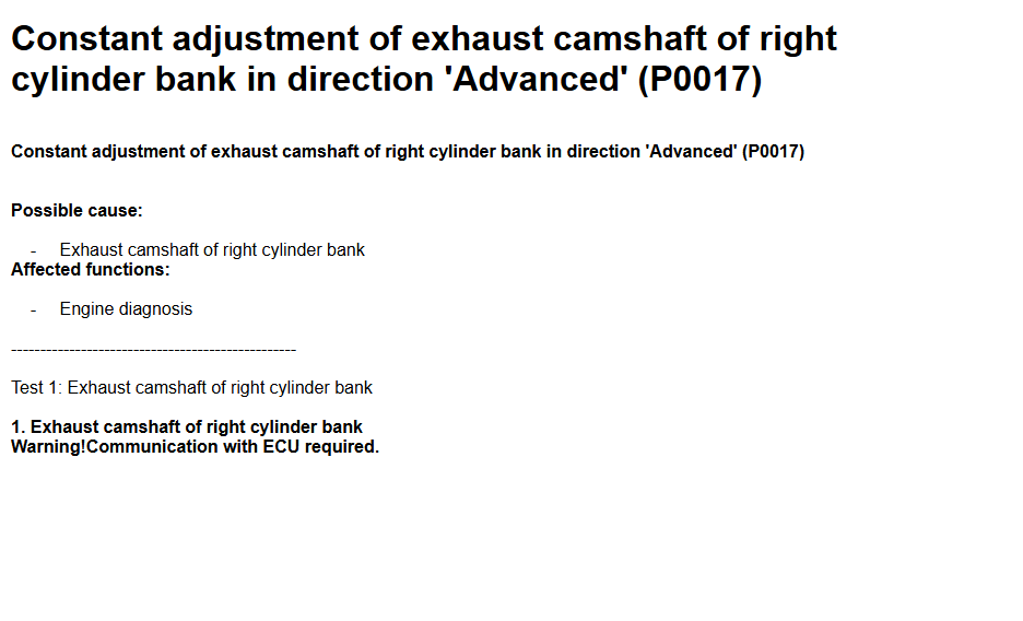

Here is the info I was given:
Mercedes fault code P001477 on the M271 engine indicates that the exhaust camshaft (cylinder bank 1) is not reaching the commanded position. This means the engine control module (ECM) is not able to adjust the camshaft to the desired position, likely due to a malfunction in the camshaft adjuster or related components.
Mercedes fault code P001762 on the M271 engine indicates an implausible exhaust camshaft position relative to the crankshaft position, meaning the timing is likely off. This can lead to rough idling, shaking, reduced acceleration, and loud noises from the exhaust. The issue often stems from problems with the timing chain, camshaft adjusters, or potentially a stretched timing chain.
All of the parts relating to these 2 codes have been replaced more than once.
Is it possible that my ECU is bad?
