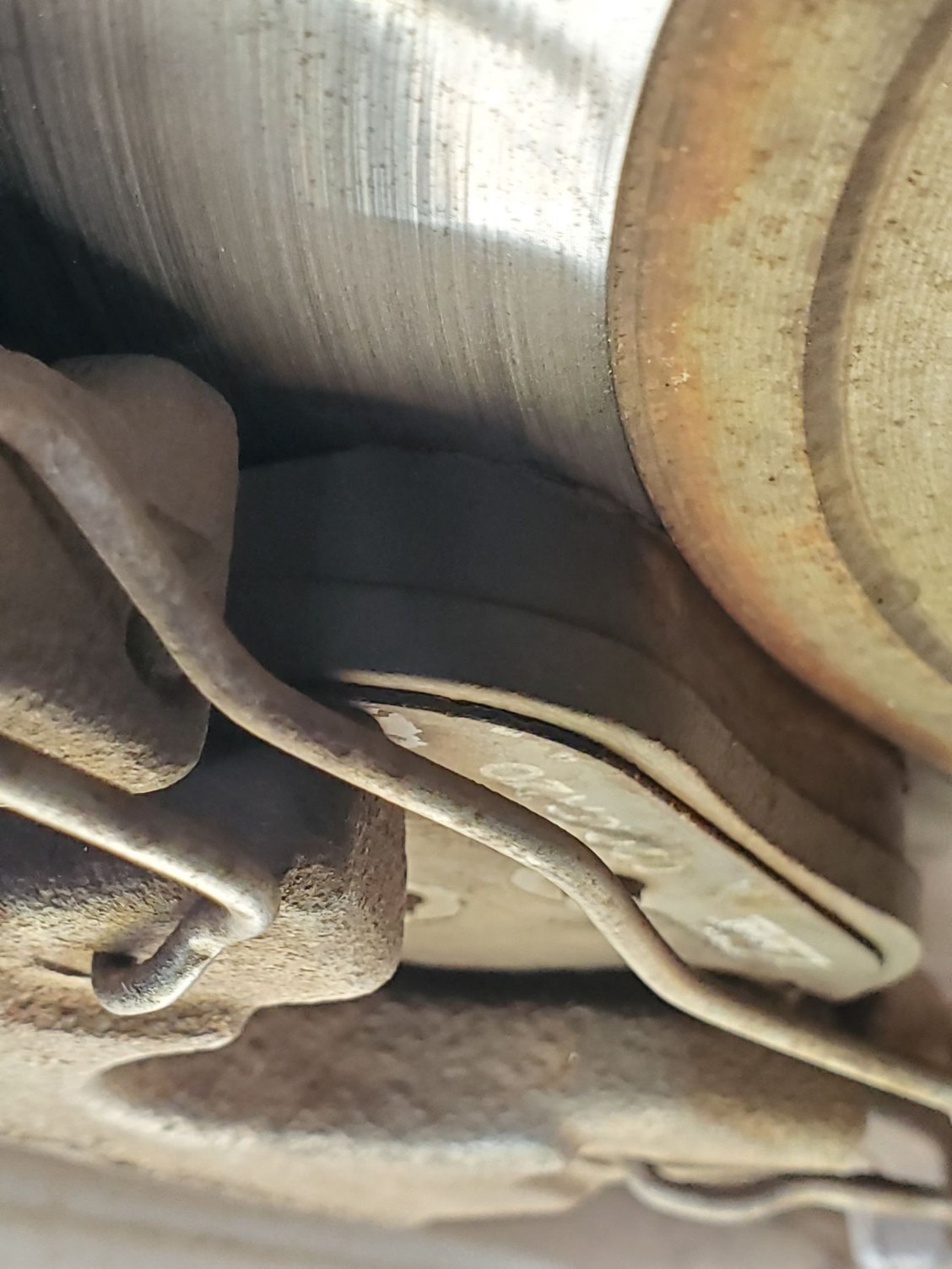

I replaced mine 4-1/2yrs ago and have around 32,000 miles on them now. I am surprised they are lasting this long given all the brake dust im cleaning off all the time. The brake fluid level hardly drops. I was thinking I would be replacing them around this time but theres plenty pad left. The rotors are wearing down but its nice and even so far. Im thinking the rotors will need to be replaced before the pads are worn.
