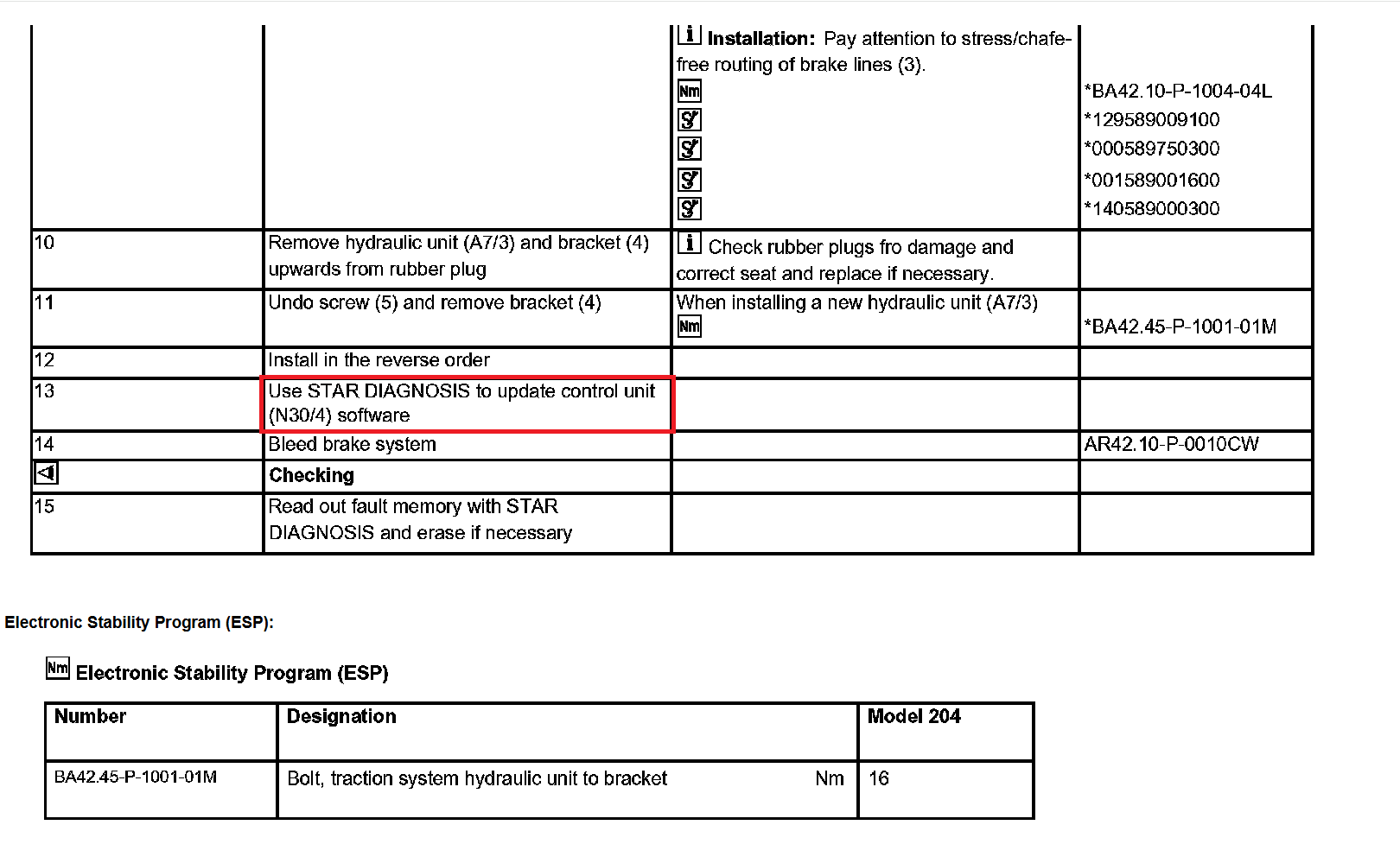

The manual says to update the software when replacing the esp. You mention changing the vin, not sure if that means updating the software.
yep that’s it. Update the VIN into the new abs modul, like flashing the new injector. If i don’t, the error codes would come back.
