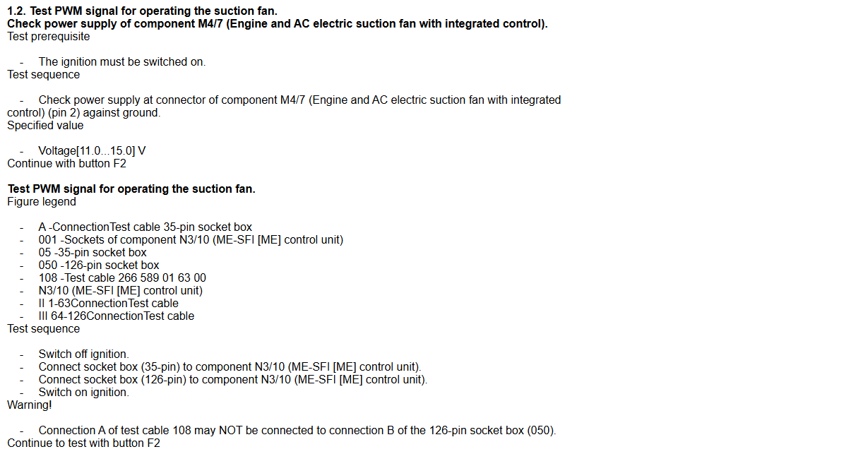

Those two codes seem to be the same. Wonder if it can be tested with an obd scanner.
