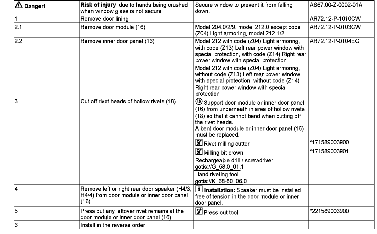

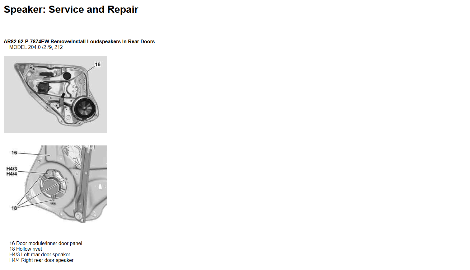

The only quirk with this DIY is I see that MB rivets the speakers in. Will I need a spacer? I don't have a 3D printer. What length of screws do I need?

I want to install a complete kick *** stereo in mine and this is just amazing. Rivet in the speakers? I guess you just have to drill out the rivets with a good high speed metal bit after punching them. Then replace with screws or bolts.
