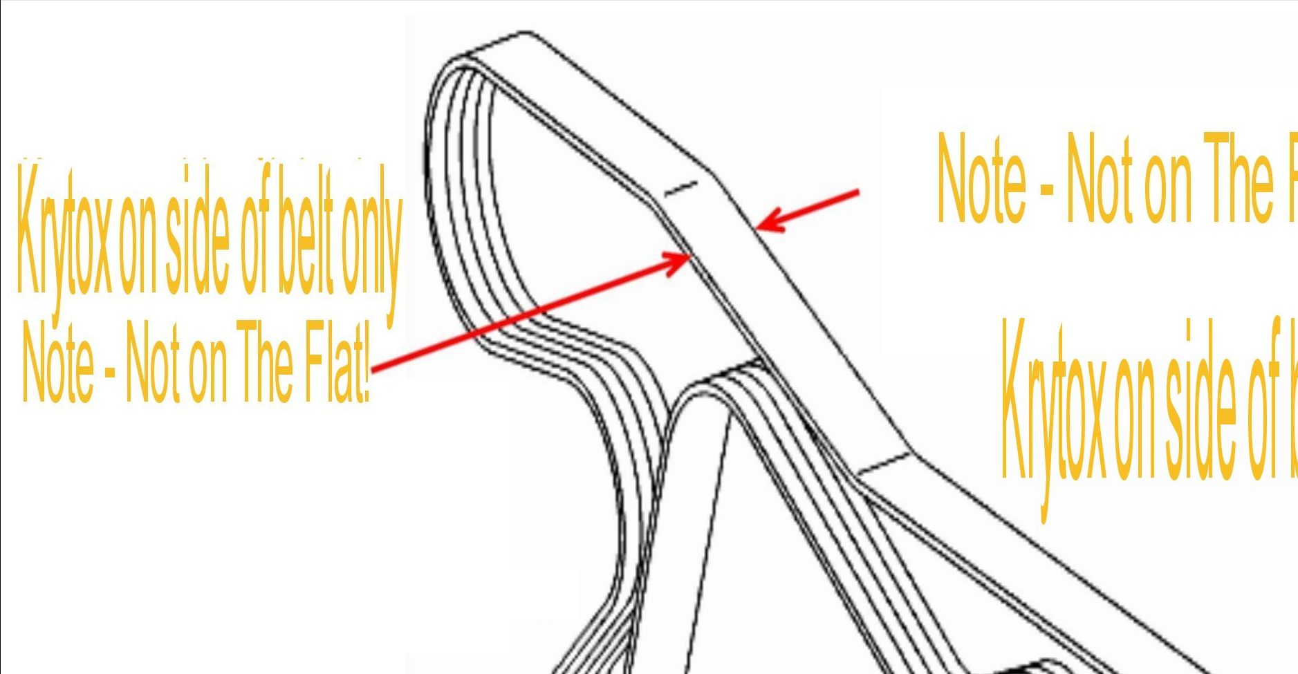

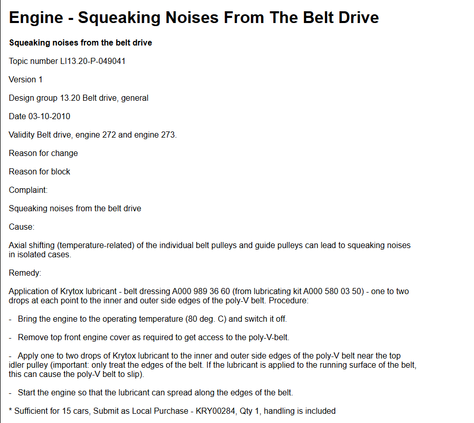

I"ll try to find a source for the Krytox lubricant. My mechanic told me he used to use a wax stick before but he has run out of it since he's retired ? Does it sound like a similar idea?

The krytox stuff is one of those very expensive products that comes in a small amount. Similar category to the MB sunroof grease they recommend. I believe the Krytox 0009893660 is Krytox GPL 105 lubricant. Seems used to lubricate the edges of the belt where it contacts the edges of the pulleys. I wouldnt run out and buy anything until you investigate further to see if you can find the cause.

MB does have a solution to a squeaky belt by applying a product to the sides of the belt, not on the flats.

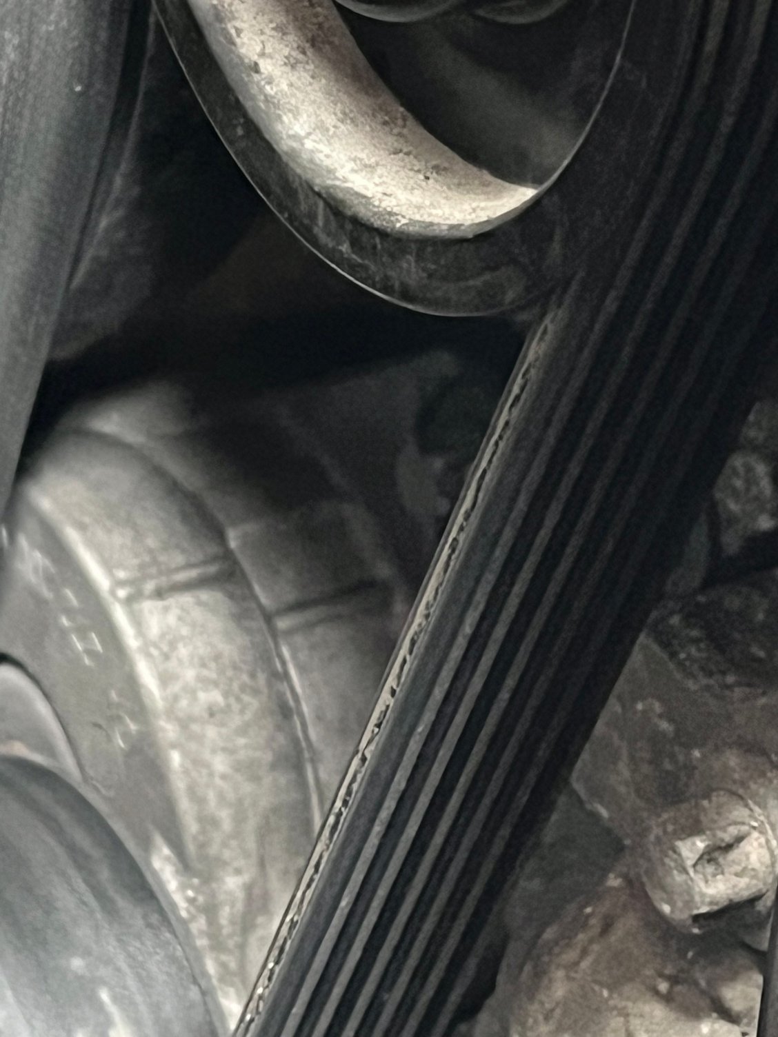

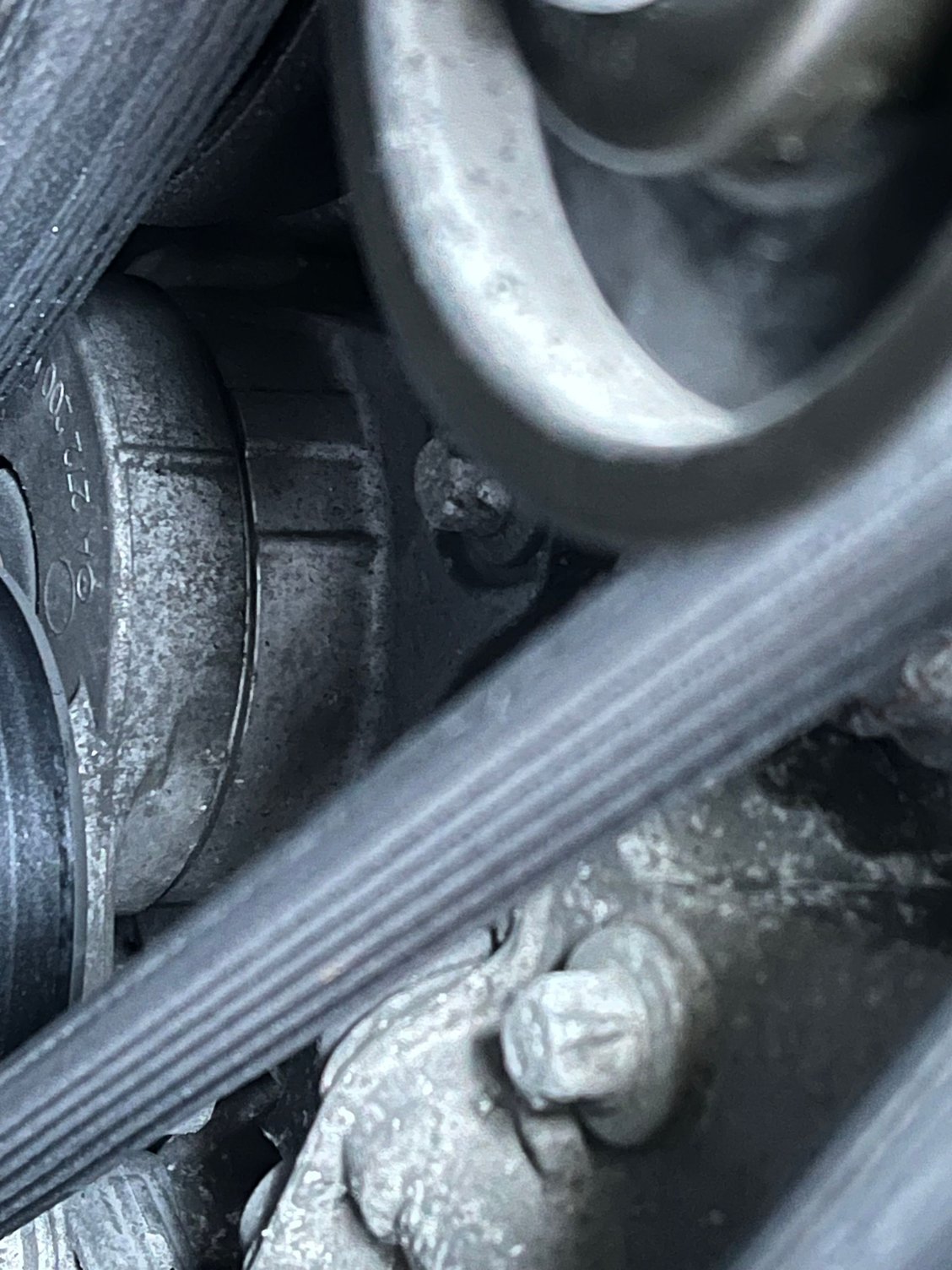

On the tensioner there are markings indicating how tight/loose the belt is fitting. Where does this show on yours? THANKS TIM,PICTURES BELOW
[img alt="Another of tensioner markings
"]https://cimg4.ibsrv.net/gimg/www.mbworld.org-vbulletin/2000x1504/img_7139_e63266907c33becbc7283f27cf84af4a910f04a7. jpeg[/img]
Took pics this am. Temperature in garage 6.5 C ,outside 6C=42.8 °F.No squeak this start. Tensioner marking normal? Thanks
Took pics this am. Temperature in garage 6.5 C ,outside garage 6C=42.8 °F.No squeak this start. Tensioner marking normal? Thanks
THANKS TIM,PICTURES ABOVE

The marking on the tensioner looks great to me, all the way to the left.
Could be a moisture/condensation related issue. I wouldnt be too concerned unless it gets worse.

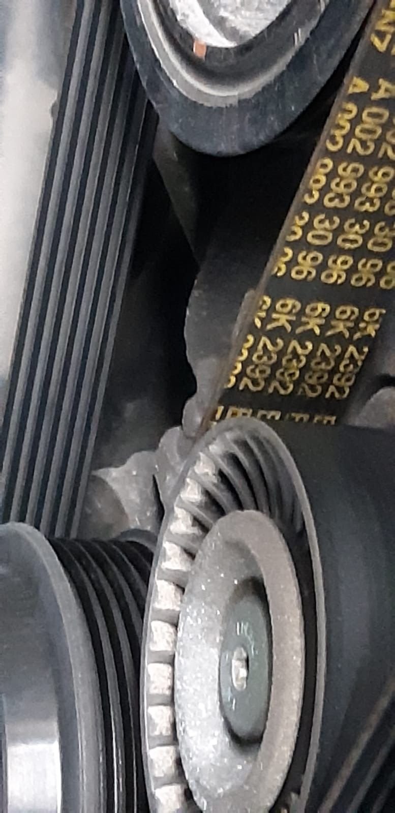

Update: changed back to old Mercedes belt. It feels thicker and more supple than the Mexican made Gates belt. The Gates was very firm almost hard.No more squeal now in cold with factory belt.. If I do need anew belt in the future I’ll get a Continental 6K2397 from Europe ,hopefully it’s the same quality as the Genuine Mercedes 6K2397 sold by FCPgroton.picture of old belt and tensioner mark
