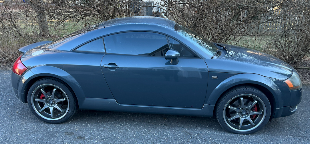

Audi was a different story 20+ years ago. The Audi TT225 quattro is an icon. I still get compliments on it.
