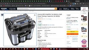

Thanks Old Piggy I was thinking about the fumes too and prolly a sealed battery would be best. I've also come across this Battery/Capacitor combo that may fit my needs but I've got to do some reading about these.

FYI - My grandson used a 1Farad capacitor + 24F battery + isolator in his pickup. Before installing that, the sub amp was killing the alternator. You probably don’t need the isolator.
My granddaughter uses only two 1Farad capacitors without the extra battery in her W206 supplying a 1kW amp and two 12” subs.
Me, I just listen to the 60W radio in the head unit.
