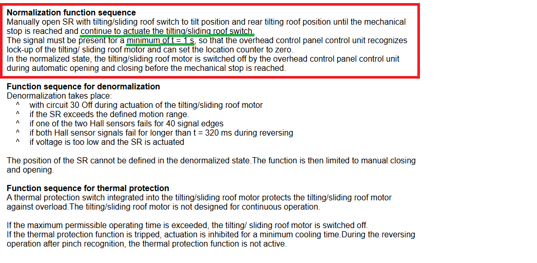

Sunroof goes back just fine and tilts up just fine, but starts and stops when closing from open and closing from tilt.

Can try reseting the sunroof.

I've tried that multiple times and it still does the same thing. I’ve read that the overhead control panel could be bad. I’ve taken it out but didn’t see anything that would explain the symptoms.
