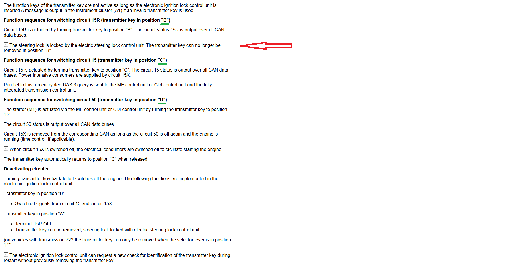

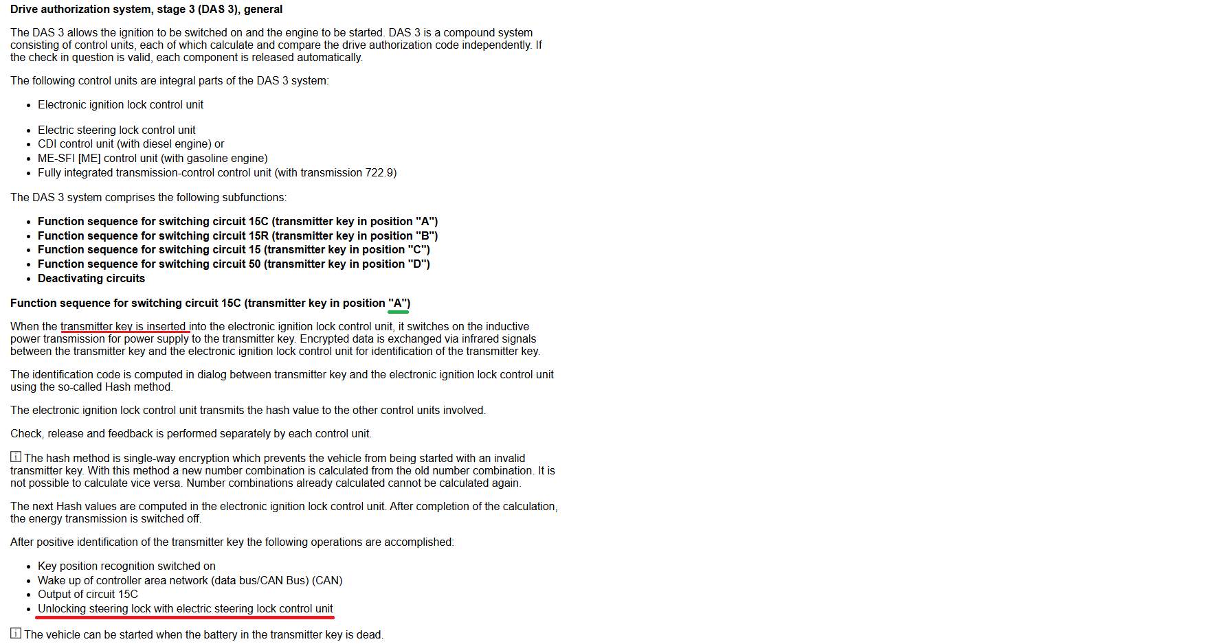

I was reading thru the DAS functions. Specifically the as of model year 2009 functions as I cannot find a later version in the 2014 model year manual.
It says that after the key is inserted and recognized the steering lock will unlock. Then it goes on to say that when switched to position B it will lock again. Seems odd to me, not sure if this is a misprint and they mean the ignition switch locks the key in, or if the steering lock does indeed lock again.
In all my years starting the car i never noticed noises coming from the steering column or noises at all though I never specifically listened for a noise or sound. I meant to earlier but totally forgot to.
Still I dont see an issue if the car is turning on and starting fine. Can always scan the car and look for any stored faults having to to do with the steering lock function that it may have picked up.
Obviously do whatever you are comfortable with. Not sure how you would diagnose it further without any other symptoms.
Thank you so much for sharing this, very insightful stuff! I have done your earlier tip of cleaning the key fob to no avail, and no fault codes stored either. I'm guessing this is just a slight mechanical hiccup that I'd have to wait and see if it gets progressively worse. Though, it is a very odd situation indeed since there's absolutely no material online talking about this.
