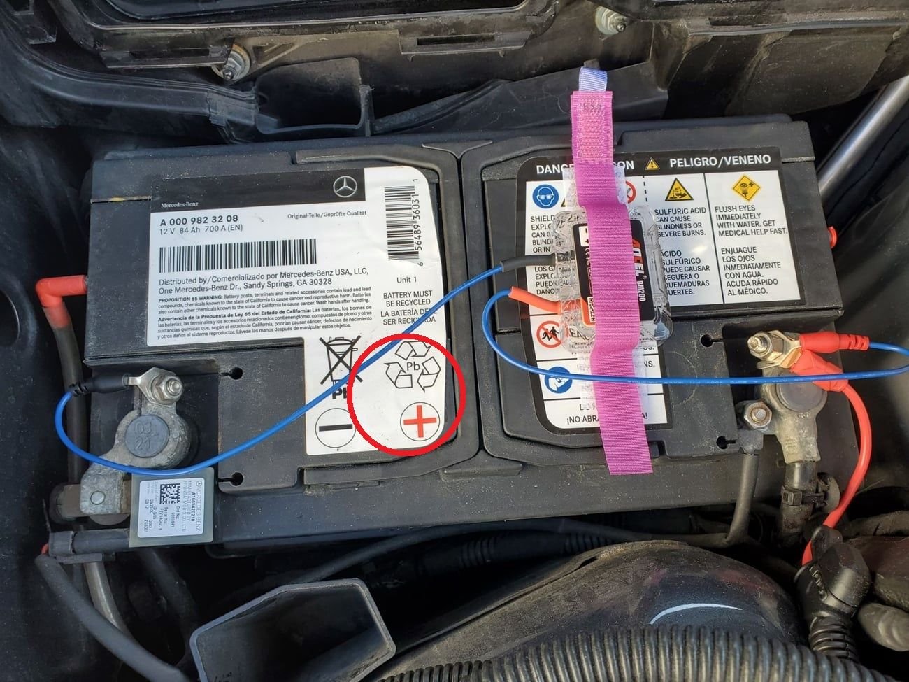

Just documenting my experience with the current battery in my W204. I dont put many miles on this car, drive it on the highway maybe once a month, mostly around town a few miles a day, can go 1-3 days without driving it.
Around 4-1/2yrs ago the battery in my W204 stopped holding a charge. Drove fine after using a battery booster to start it but then wouldnt start again without the booster. The battery in it was a genuine MB battery 0009823208 and from the manufacture date was 7yrs old. So I bought an exact replacement. Only when i got home from buying the battery did i realize it was already 1-1/2yrs old, probably sitting on a shelf somewhere. I learned my lesson after that experience.
The manufacture date says 03/21 on that battery post. Fast forward to last month where I let the car sit unused for 6 days and it wouldnt start, cranked slowly a few times but was pretty dead. Started right up with my battery booster. After that I noticed weak turnover when starting. Last Thursday i hadnt driven the car for 3 days and it wouldnt start again so jumped it and it drove fine. The next day I put my charger on it. Didnt drive it all weekend so today for fun I put the charger on it again and checked the voltage. It was low, resting only 12.4v, then after unlocking the voltage dropped to something like 11.6v.

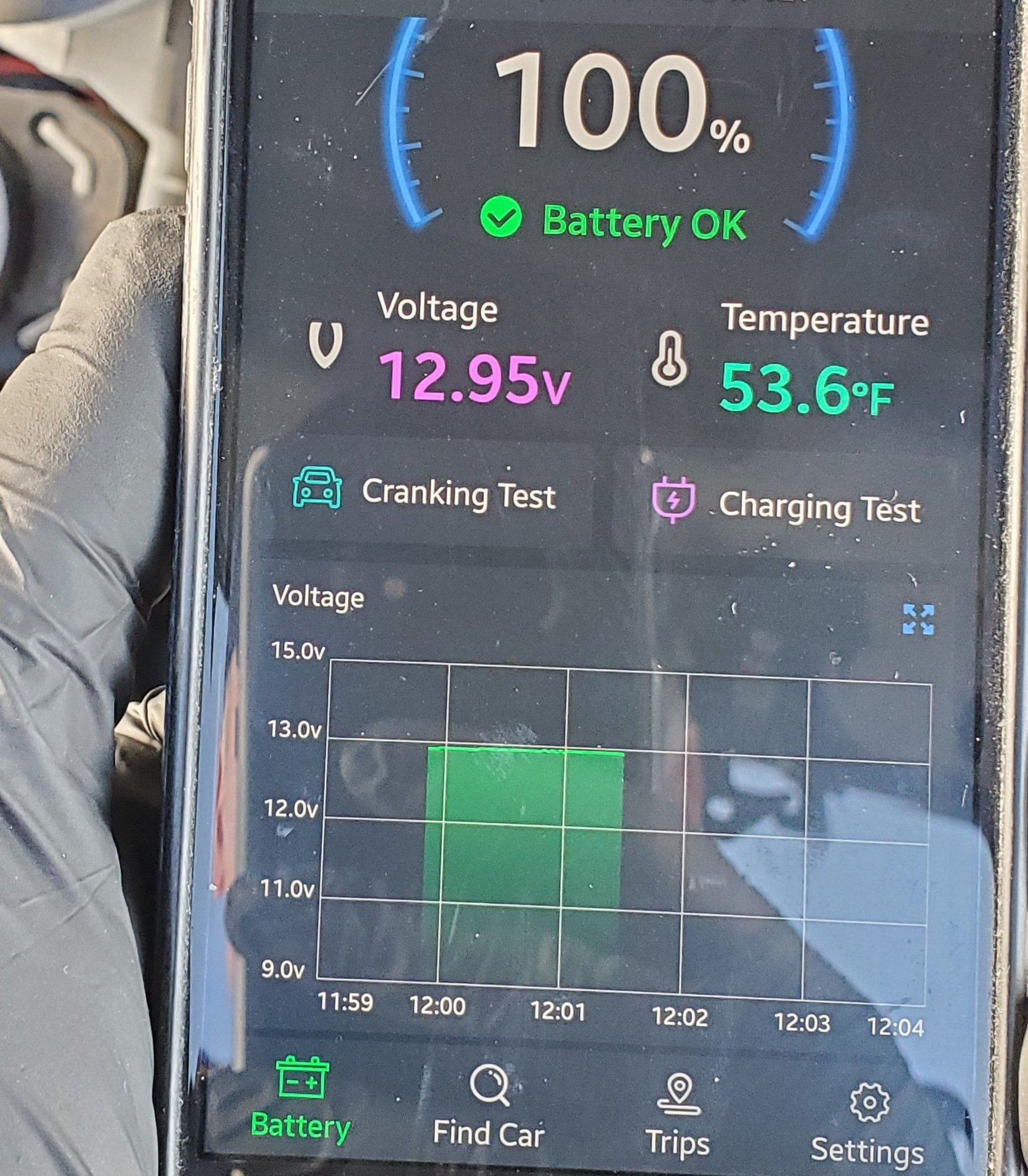

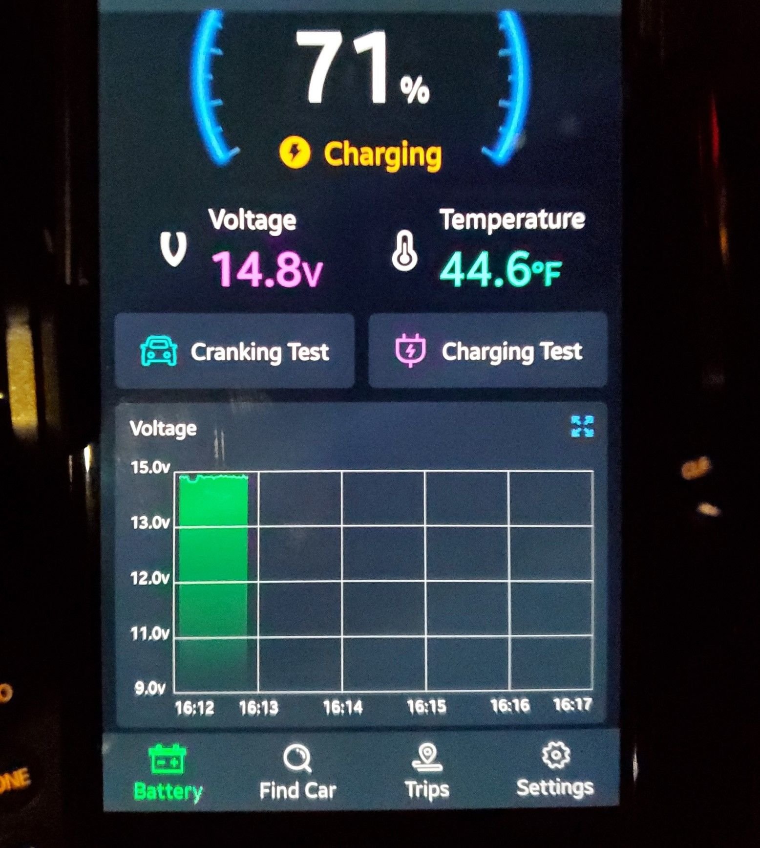

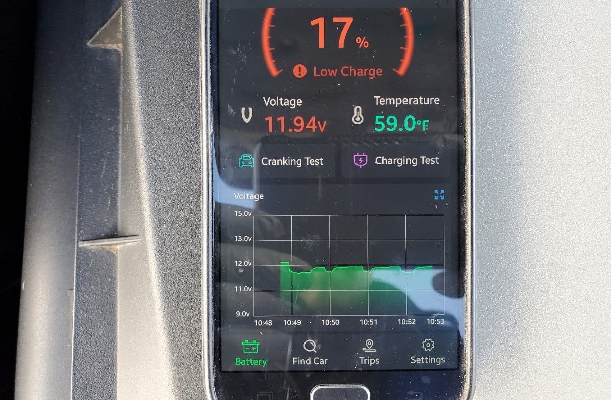

Thats when I put my Ancel BM200 battery monitor on it. It lets me view the battery voltage from my phone app. When charging was done it was showing around 12.4v, but then just locking up the car the voltage dove and only went back up to 12,2v. Decided to take a drive and see what the battery was doing. So I unlocked the car and the voltage dropped way down to 10.9v, im assuming this was everything turning on, I have the foglights set to turn on when unlocking. Get in the car and it wouldnt start. Ridiculous. When driving the voltage was up around 14.8 so i can safely assume the alternator is working fine.
Heres the voltage driving around:

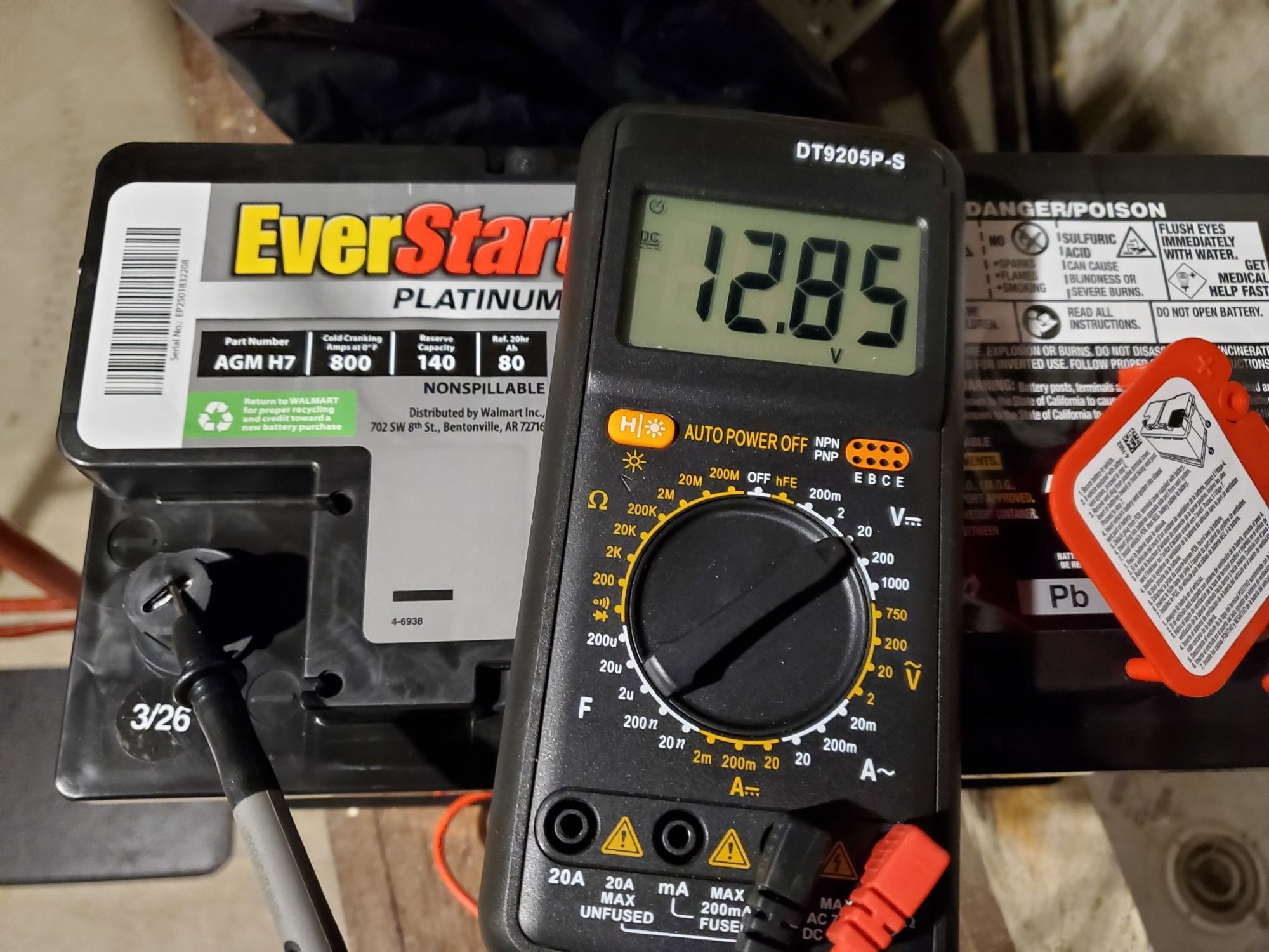

Best thing was the manufacture date, must have just left the factory this month. I checked the voltage with my meter and its showing 12.85v. I put my charger on just for fun. Right after charging it was showing 13.26v. Waiting until tomorrow to install it. One thing I noticed on the label is it mentions charging it at 13.8-14.6v. Thats a tiny bit lower than what I was seeing while driving around.
I want to see what it shows for voltage when its installed. Because when I first installed this current MB battery I was only seeing around 12.45v, at least thats what all my photos I took are showing. I remember it being an issue thinking I should have returned it for a newer battery and not one already over a yr old.

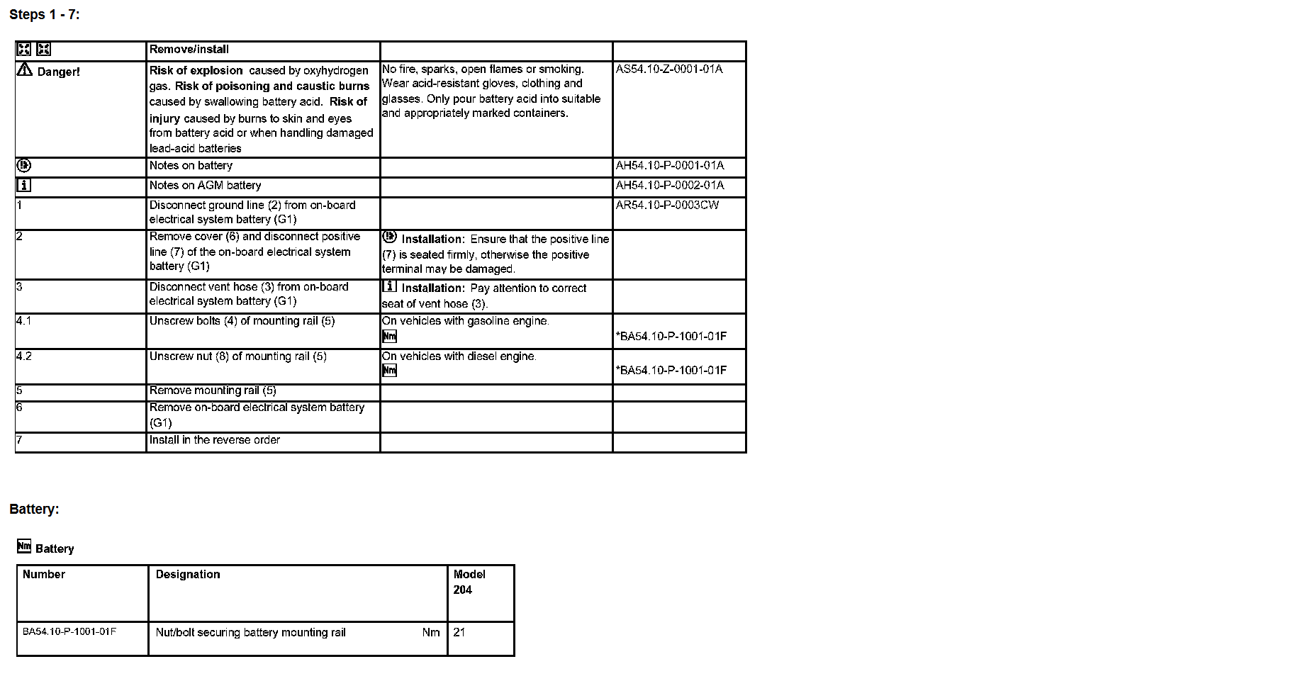

This will be the 2nd battery I installed in a W204 and havent done any additional steps. The service manual doesnt mention any type of coding needed.

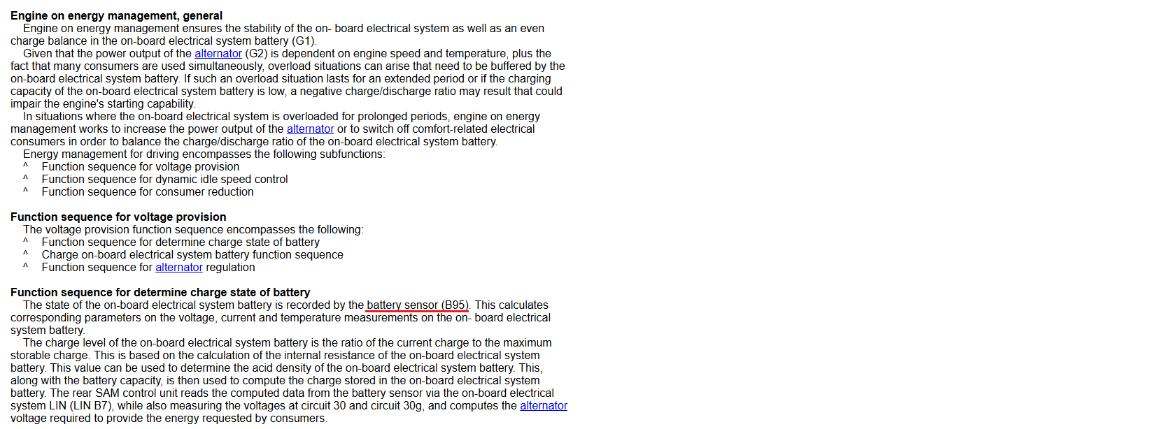

The W204 does have energy management which im still trying to understand. One thing im confused about is the manual mentions the car seeming to want to maintain the battery at 80%, but when i read about AGM batteries im finding they like being kept fully charged.
I've left the Ancel battery monitor on the new battery just to see what its doing. I'm not so focused on the monitor showing the SOC since im not sure how accurate it is to my specific battery. I'm just keeping an eye on the battery voltage, seeing short trips vs long trips, how its charging.

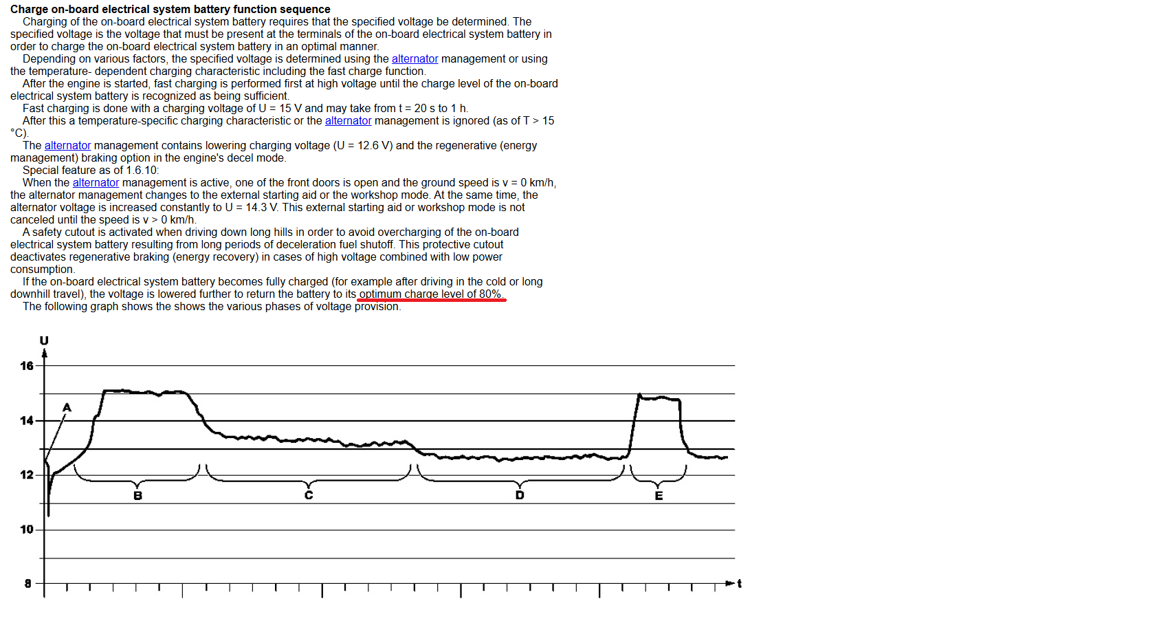

The manual mentions a fast charge at 15v which I have yet to see, probably because this new battery has not yet dropped below 80%.

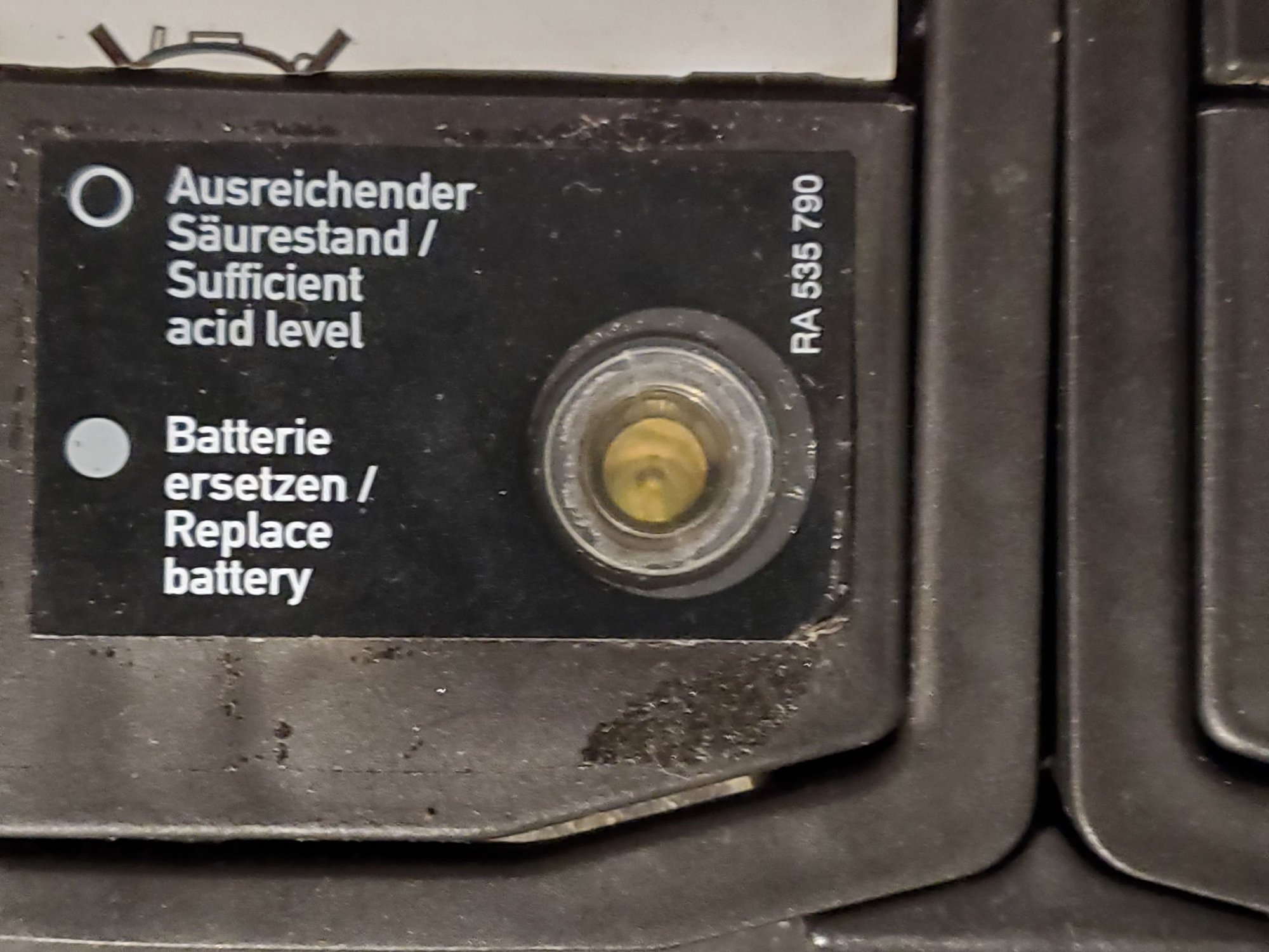

The MB battery has a little window that im assuming glows green if the battery needs to be replaced. But its not green. I'll have to look more into what its exactly for. It was actually covered by the label when I got the battery so I peeled it back to check. Wonder if the new battery has one.

I was moving the old battery around on a dolly and noticed the little light was coming on when I had it tipped back. Not sure if its a light or just a reflection. Also heard liquid sloshing around in it. Guess its just triggered by detecting a low level of acid inside.

It’s just a reflection of the bottom of a little tube when the acid level drops below it. Very simple and reliable.

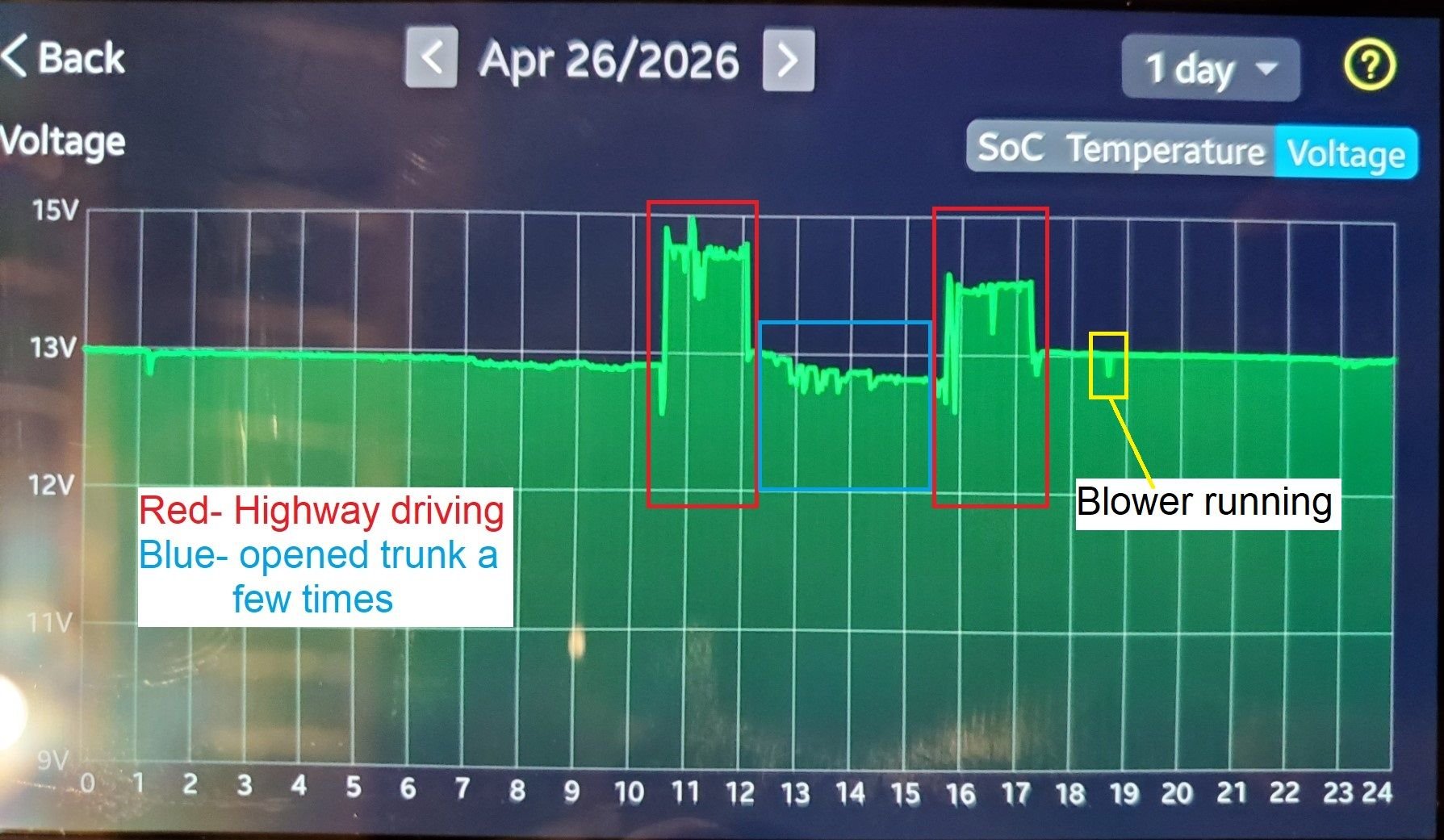

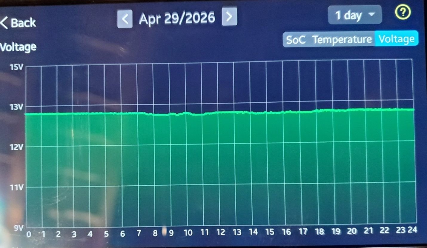

I was just looking thru the saved history on the battery monitor and saw something interesting from last weekend when I took a trip to visit my parents. Drove the same highways to and from, drove the same speeds roughly except for hitting some traffic on the way there. The charging profiles look different, voltages look lower on the drive back. Also noticed just how much the battery is drained from just opening the doors and trunk a few times not even putting key in the ignition.
Its also nice to see while the car is parked the voltage stays about the same unlike with the previous battery the voltage seemed to slowly drop every day.

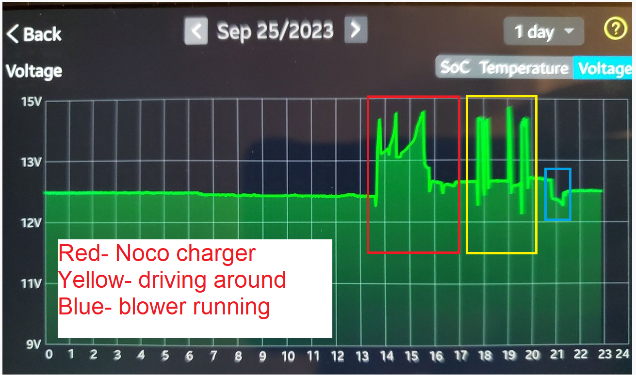

Something i just noticed when reviewing the saved battery info is how with the previous battery the voltage dropped and stayed lower when the blower ran after the car was parked. With this new battery I can see the voltage dip indicating the blower turning on and running but then the voltage appears to bounce back up to the level it was at before the blower turned on.
Unhealthy vs healthy battery, im assuming.
Previous battery back in 2023. Battery was around 2yrs old at that time.
New battery around 2 months old according to the manufacture date.
