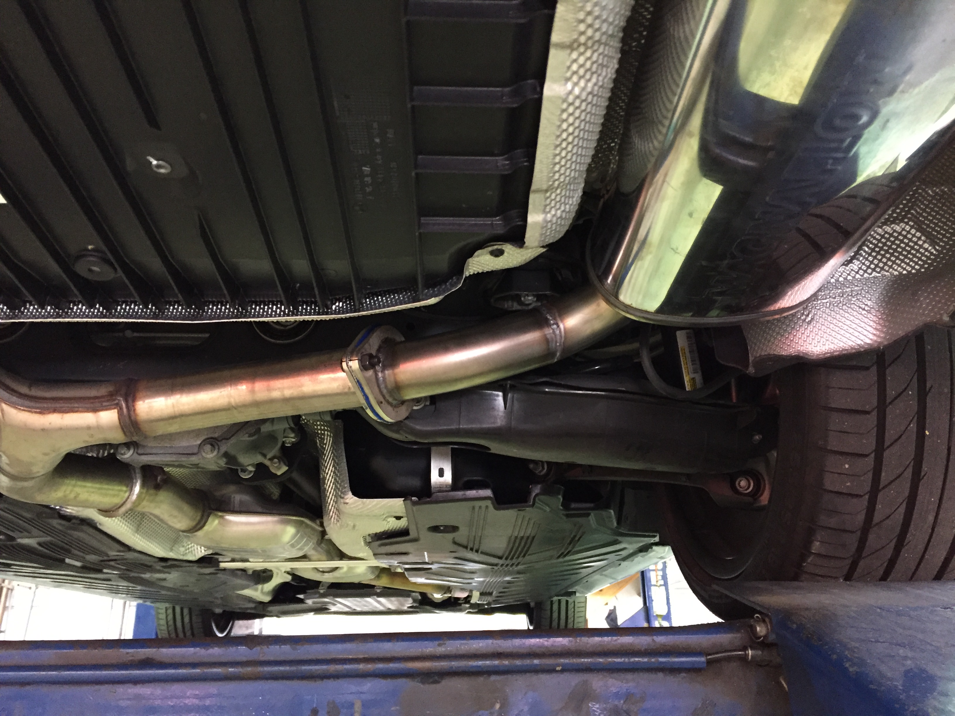

I also removed my mufflers and replaced them with some magnaflows..
I have the base note magnaflow are known for, the gearchange rasp is alot better, the low rpm mild grumble is there and the deeper rasp is a little there under load and higher rpm.. off load and at lower rpm you barely hear it.. perfect for me..
IT DOES NOT HAVE THE METTALLIC RASP OF FOR EXAMPLE THE ARMYTRIX SYSTEM.. some like that.. i do 2 hrs highway cruising a day so its not right for me..

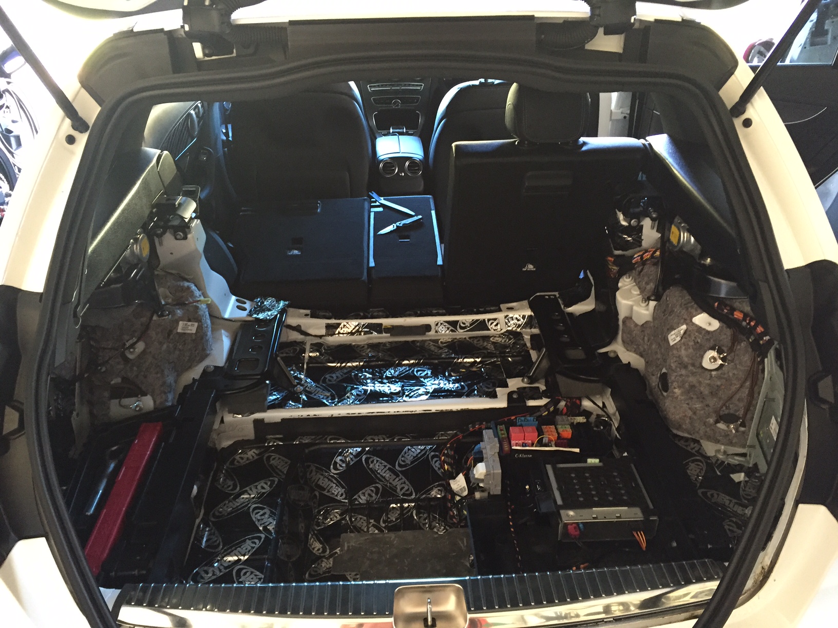

There was a tiny bit of drone at 2k rpm (100kmh) on the highway, but with liberal dynamat in the back end of the car thats 100% gone.. ie it was a resonance of the trunk / wheel well rather than a note of the exhaust so to speak..

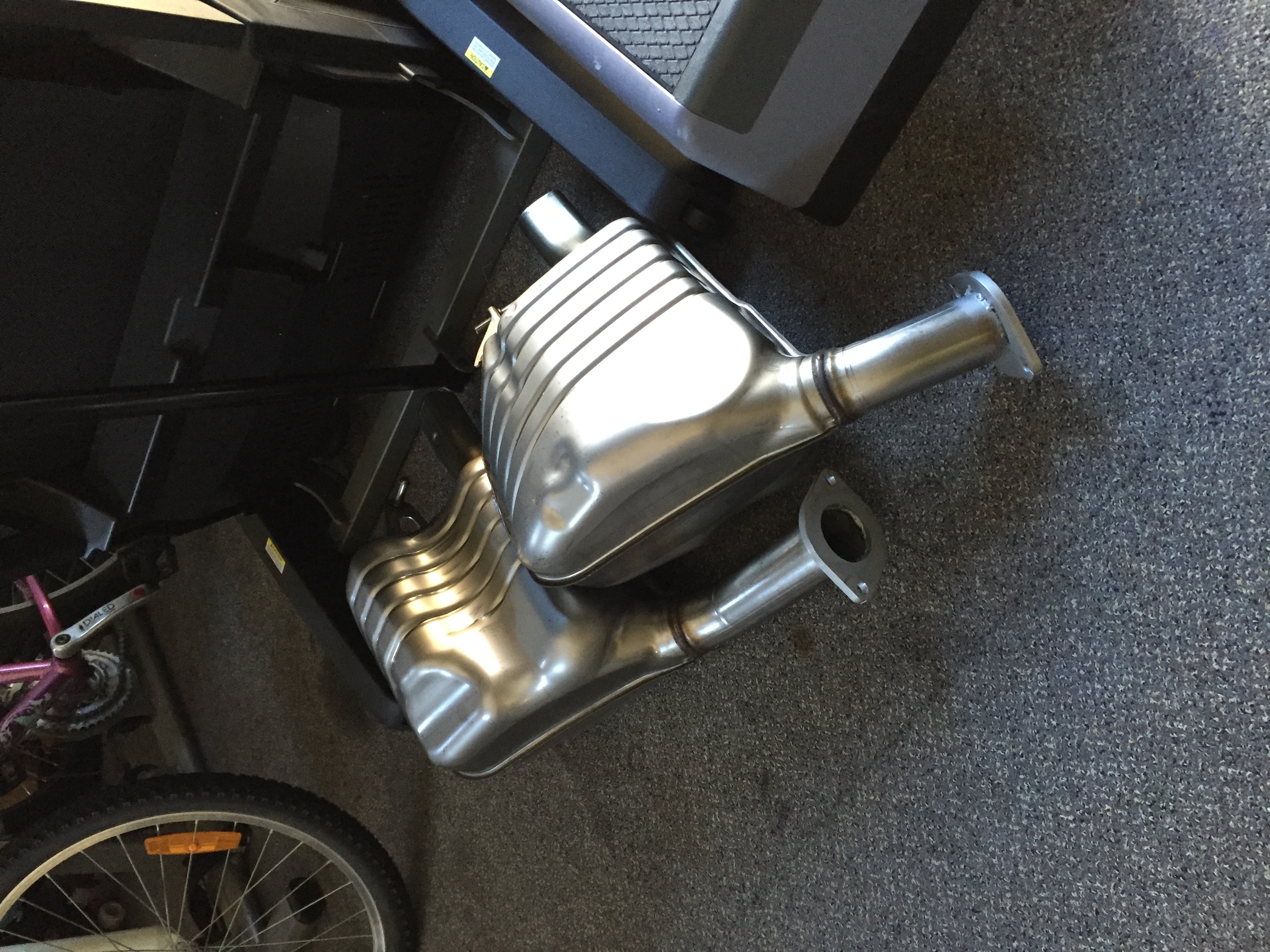

I also had the flanges added to the originals if i ever want to return it to stock.. i could also get a striaght through tube made to bolt on on one or both sides.. but i have to say the current level is ideal for me...

this is not on the c450 though..?

What size magnaflow mufflers did you get? Trying to figure out what size diameter the OEM exhaust is. Thank you

What size magnaflow mufflers did you get? trying to figure out OEM exhaust pipe diameter size. Thank you

Im also interested to know what Magnaflow part number you used. Or if you know what the exhaust diameter is.
