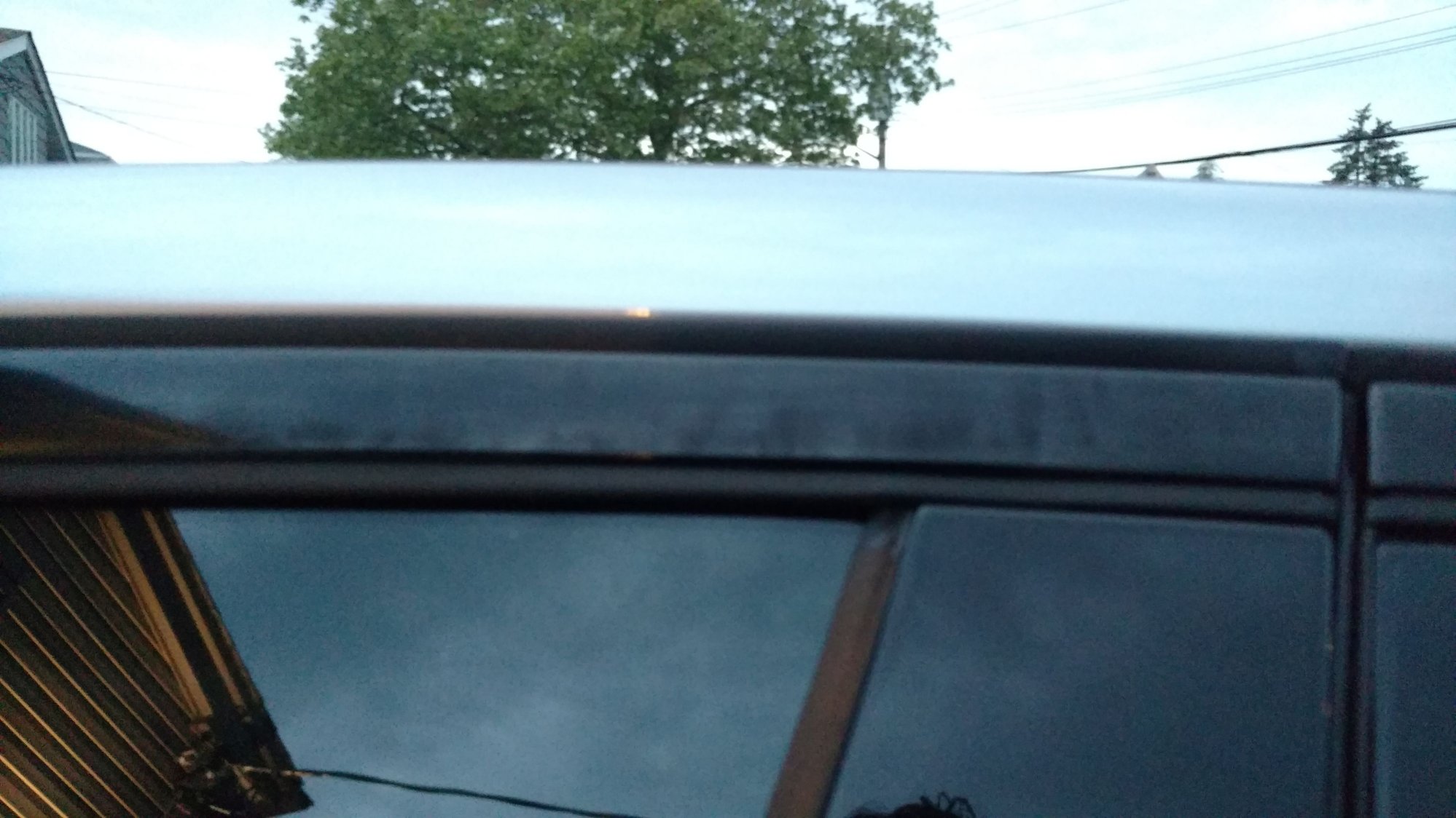

I am starting to notice spotting and discoloration along the top rails of the window frames. I think these are anodized parts but I'm not sure. It doesn't wipe off with water and a microfiber cloth. I also tried a little car wash soap to no avail. My grandma's SL actually has the same issue on the lower window frames.
Any ideas? Pics below.

I think it's just oxidation. Try hitting it with a mild polishing compound in an inconspicuous area. Something with a little bite to it. My 220 had anodized trim and that seemed to do the trick. Keep it waxed after it cleans up and it should stay clear.

My last c class had the same issue on the lowers.. it was a clearcoat layer delaminating.. polishing it will do bugger all IF its the same issue as its the delamination changing the appearance, not the top surface.
I have 2 sets of window trims on warranty through the life of that car..
It was exaggerated by the very harsh sun we have here.
And the last car was very infrequently waxed / protected (regularly washed though)
Suggest replace on warranty, then get into the habbit of using a durable wax / sealant product after washing..
Collinite 845 insulator wax is great product, low cost high performacne and durable, every 3 months or so would typically be more than enough.. there are of course a ton of others to choose from..
look on Autgeek online forum re using the collinite for best results and knacks etc..
All the best...

Yeah, if you can run your fingernail over it and feel the where the clear coat is missing or flaking that's a warranty issue. If it's just surface oxidation the polishing compound should take care of it.

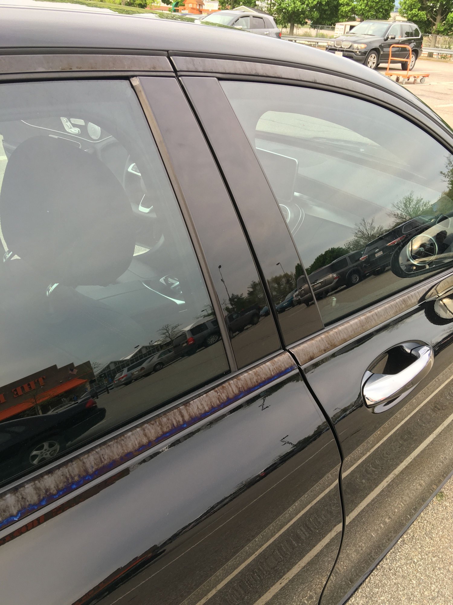

Can confirm that I have this problem as well. Car has only been washed in a touch-free wash and garage kept in New England (mostly driven at night, since I work from home). Dealer will be covering it under warranty:

Wow. Your pics really show the damage. I am looking at the same thing, but not as pronounced yet. My car is only 4 weeks old.

Wow! That's inexcusable. Hope the pieces they replace it with were processed differently.

Mine is a few months olds, took delivery in December of last year. Hopefully the replacement trim holds up

That looks terrible. Do you have the same on the front and rear?

Holy crap, Vertice! That's a 2016? I see a recall coming like the MBTex bleeding issue

Yes that is a 2016, straight from the Alabama factory to me. Hopefully it's not widespread, I haven't seen many others with this problem.

Yes, the same problem pretty much all the way down the side of the car and on both sides. Though it does seem to be a bit worse on the passenger (right) side.

The owners manual does state to avoid touch free car washes. It claims that the types of detergents used in these car washes can damage paint and or trim pieces. Personally, I avoid the touch free washes because they never get my car clean.

I saw that, but don't think it matters much. The black chrome on my old car held up fine after one touchless wash a week for term of the lease while at college. In the winter with my C I take it through the touchless and all is well, I don't have black pack though
