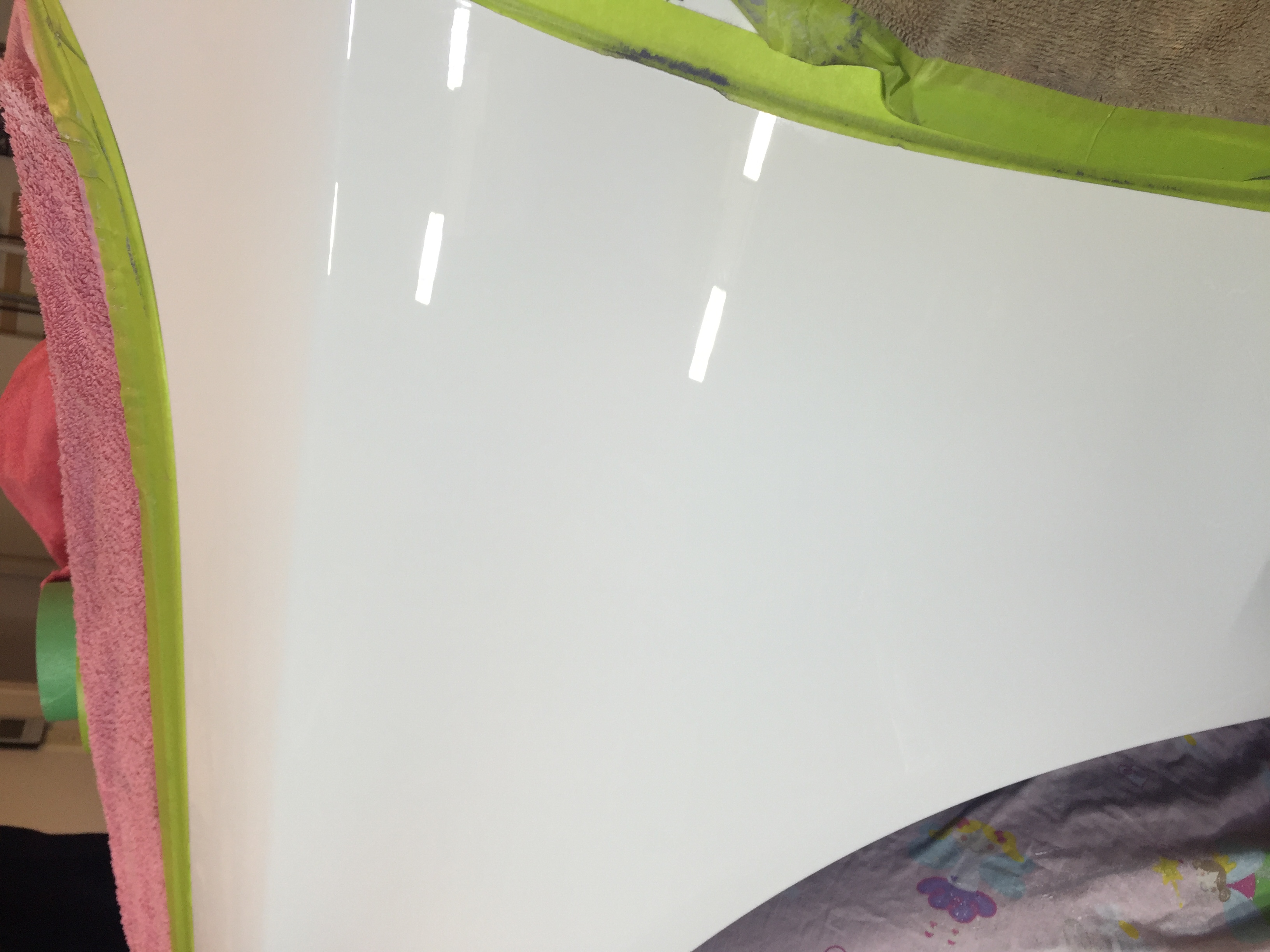

Process was:-
Car Pro Denim pads (5" 10 off and & 3" 6 off) with Juice Super C compound (SMAT) on a rotary generally around the 100-800rpm range..... using products such a Scholl S3 do work but are slow and gum up ans they are diminishing polishes.. not ideal for flatting.. Meguiars 101 also recommened.
Correction after flatting was using Scholl S3 (rotary Yellow and blue pads), S20 (DA scholl blue spider pad) then Jewelling Rotary (black finishing pad)with car Pro Reflect..
LSP was with Poorboys White Diamond (applied with roatry), and Collinite 845 applied by hand..
I was aiming to get about 90% of the peel removed as I wanted to maintain as much paint thickness post correcon as possible..

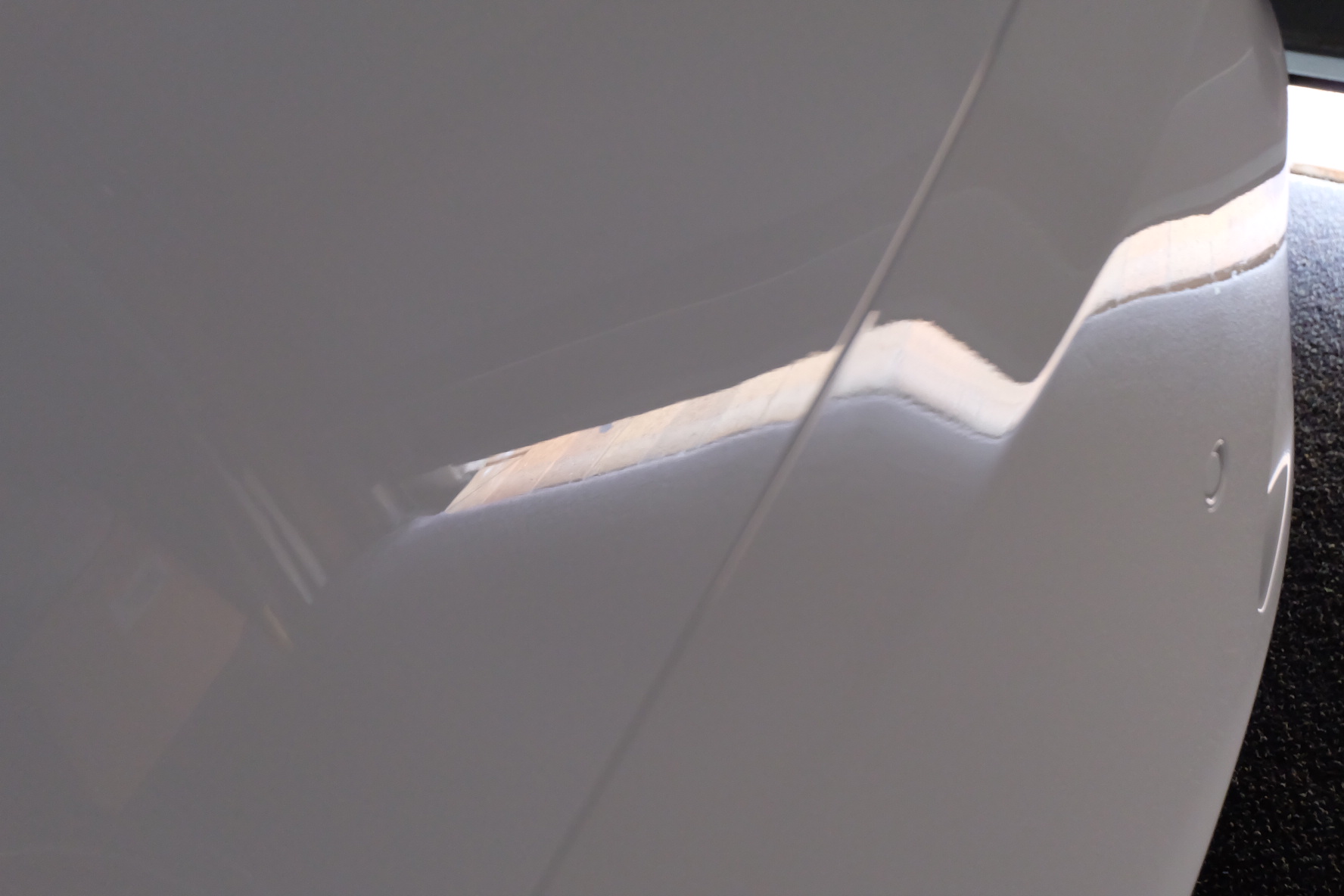

First image shows the improvement in the sharpness of the reflection.. not perfect but again I was trying to preserve paint thickness...
I'd only go flatter still on custom paint where i ahd additional clear to start with..
My car is factory (German) polar White. It is a single stage white (not clear coat for those unfamilar with paint tech). And certainly in my case is very very hard... (as in ridiculously hard.. )
Be warned this process is VERY labourious and time consuming on such hard paint eg. 3 hrs rr qtr, 4 hrs rear door, 5 hrs fr door, 10 hrs bonnet..
All in this wil have consumed 50 hrs and perhaps $300 AUD in materials..
(the denim pads get faily flogged...) getting this done professionally would be in the order of $2500.. (a huge saving I keep reminding myself..)
Wet sanding (2k, 3k, wool rotary then foam pads etc...) may be quicker but on such hard paint the scratch removal after flatting takes so long the intial benefit is lost.. be warned.. (this is not the case on softer paint so is likely the way to go..)
The key question is would i do it again.. the answer is NO, not on this paint.. on softer paint it would take half as long so the answer would be yes.. visually its a big improvement.. even at only 90% removal...
Hope I have encouraged those on the edge, and put off those who thought about it but weren't clear on what is involved..
