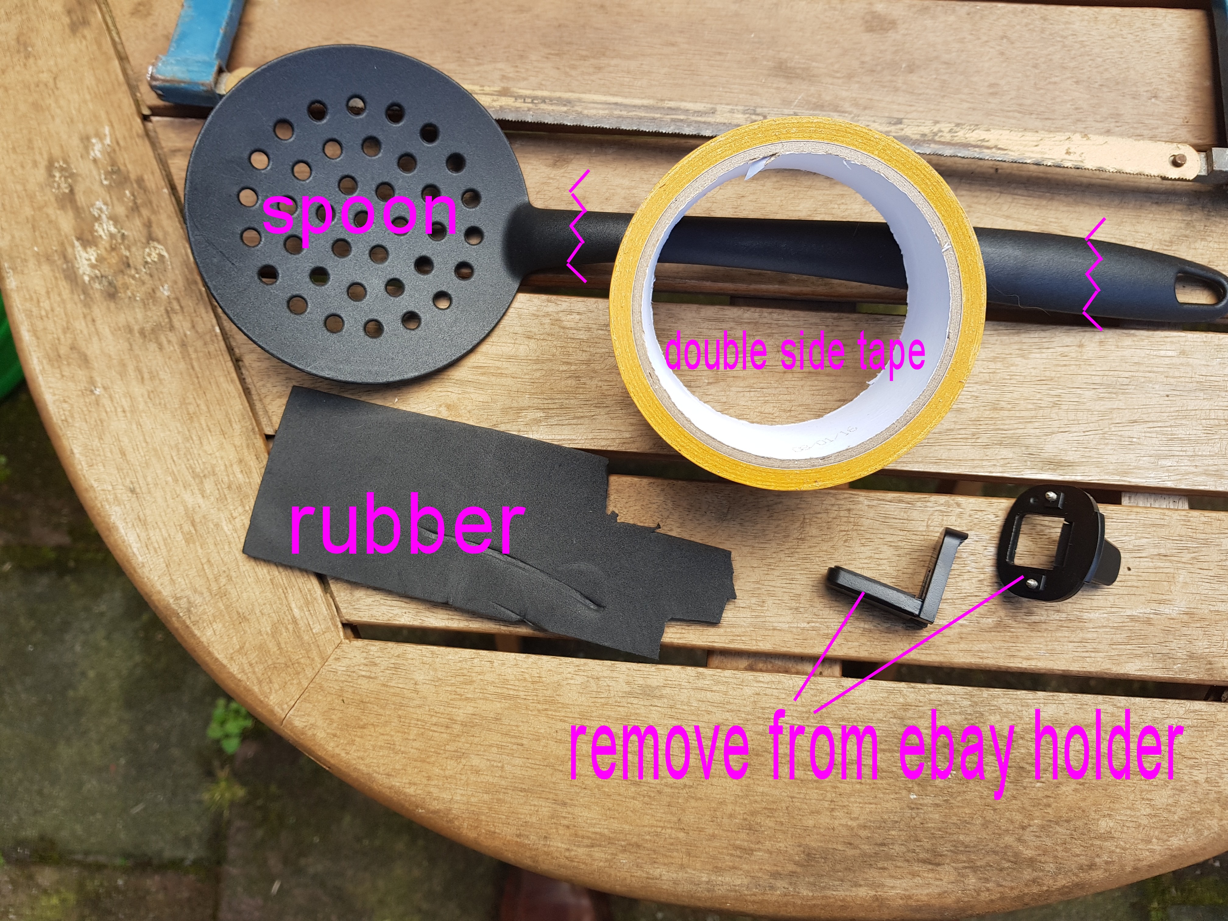

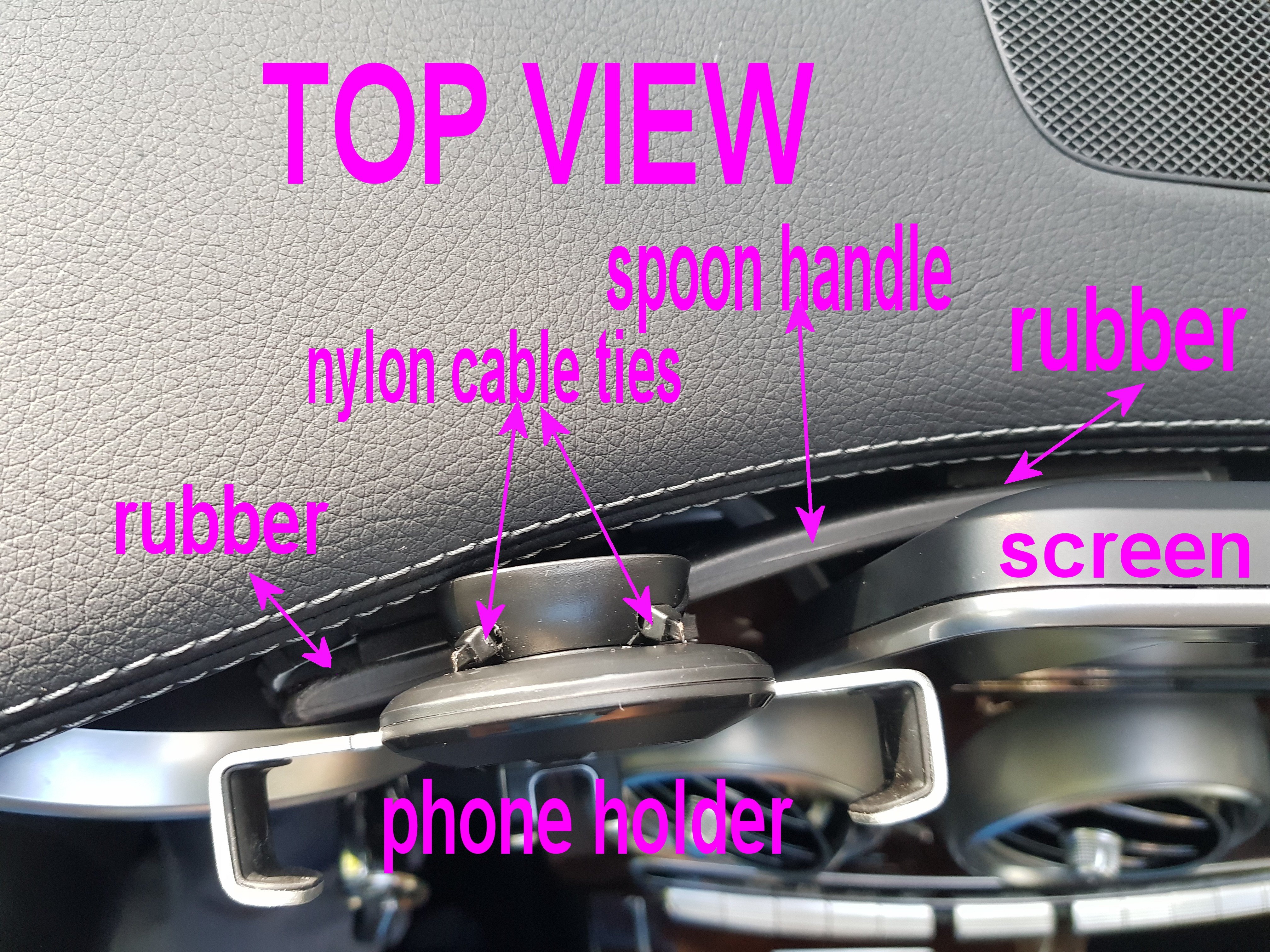

Good solution for the phone mount Mercedes C class W205.
I want to share it because it is simple and it is clamped in position, without drilling or gluing to car parts.
1. I bought on Ebay
Gravity Automatic Locking Car Phone Holder for iPhone 7 6 Plus Samsung S8 Huawei
http://www.ebay.com/itm/Gravity-Auto...72.m2749.l2648
2. The spring clip were removed from the back of the holder (by removing the black rubber, and unscrew two small screws)
3. I Cut a black plastic spoon handle, and then fixed rubber sheet with double side tape.
4. The spoon handle is clamped between back of the screen ans the dashboard (at the right end). At the left end it lays on the clock housing (again with rubber protection).
5. The phone holder is fixed to the spoon handle by two nylon cable ties (I drilled two holes in the holder's fixation part) and some rubber between.
6. The results are on the pictures

Of all the kitchen-implement based phone mounts this one definitely has the biggest spoon. 😉

Genius! Now make sure the missus doesn't know what you did with her spoon...

Doesn't look like it will fit those with bigger nav screen.

car already come with navigation, this is a quick way to make your Mercedes looks cheap

Cheap look?
Not at all.
You do see the phone holder, but the structure and connections behind are concealed.
(Also, I didn’t glue, or drilled any of the parts in the dashboard, and the whole thing and could be removed without any traces)
