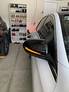

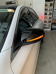

Here are some pictures of black mirror caps and side blinkers. I bought both of them from AliExpress and the quality on the mirror caps is like **** to say the least. On the other hand the blinkers work perfectly fine though it was a pain to align the pins on the passenger side but once I got that done they worked like a charm. The driver side mirror cap came cracked and the seller is sending me a replacement but with this whole coronavirus situation it has been more than a month and I still haven't got it so I Ended up installing the cracked one and obviously it does not fit flush on one side but it is tight enough that it won't pop off so I am living with it and anyway if I don't point it out then nobody can tell. The other problem with the caps is that they have at least one or two tabs that came broken but again nothing that can compromise the hold so I made it work basically by strong arming both of them. Attached are some pictures for your enjoyment.
Attached Thumbnails NEW Style Sequential Blink LED Dynamic Turn Signal Light For Mercedes Benz with BLUE-photo782.jpg   NEW Style Sequential Blink LED Dynamic Turn Signal Light For Mercedes Benz with BLUE-photo83.jpg   NEW Style Sequential Blink LED Dynamic Turn Signal Light For Mercedes Benz with BLUE-photo975.jpg
