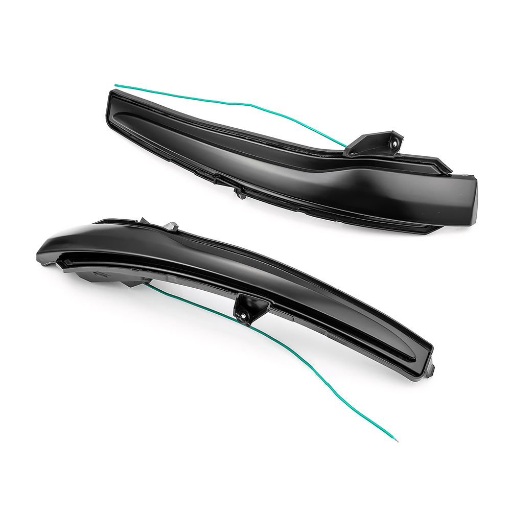

NEW Style Sequential Blink LED Dynamic Turn Signal Light For Mercedes Benz with BLUE light unlock. (video attached)
https://www.aliexpress.com/item/2pie...994516281.html
Green wire attaches to the mirror puddle light for BLUE light activation

I dig it. So the blue light comes on when the mirror puddle comes on? Could be kinda cool. You going to take the plunge @benzdude ?

Took off my mirror backs and replaced with carbon fiber and new signals. Very easy. I didn't remove the mirror, but just pried back and then pulled up. Came right off. Turn signals are pretty straight forward too. Doable including the splice into the puddle light in 10 min a piece.

I haven't received mine as yet, but It looks like one plug in connector, plus one wire tap to the puddle light 12 volt.

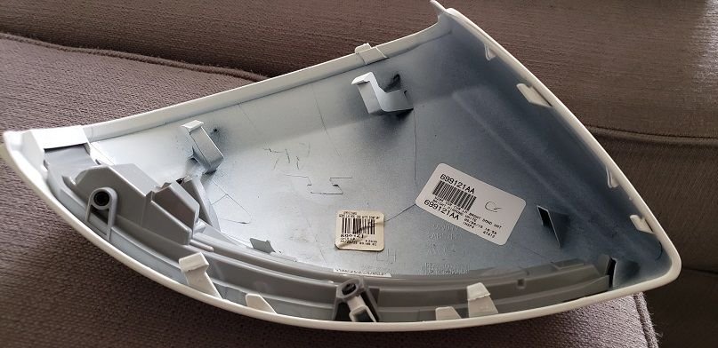

Any idea how to take off the mirror caps to install the side marker?

EDIT: With the mirror folded, start gently prying at the bottom, then work the top.

Here is a view of the clips and position. (drivers side cover)
