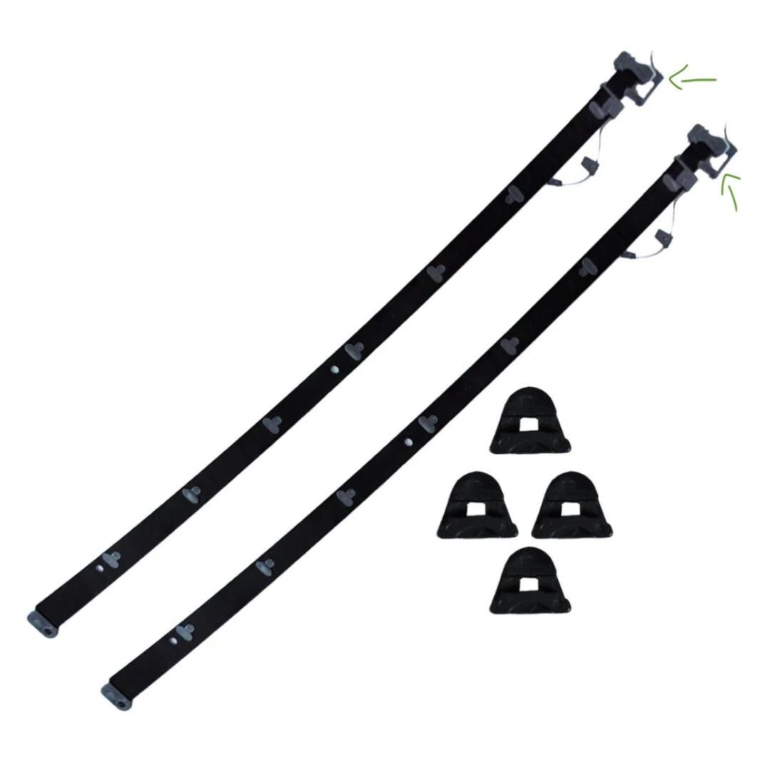

Hello,
You must have broken fixing guides.
Can you send us photos of your front fasteners at rail level.
taquettoitouvrant@gmail.com
Our kit is specially designed to repair this problem.
Best regards

Contact us on taquetoitouvrant@gmail.com
We will send you the assembly tutorial, at least you can see what we are talking about.
Send us a photo of your sunroof fasteners at rail level, and we'll confirm whether your guides are broken.
sincerely

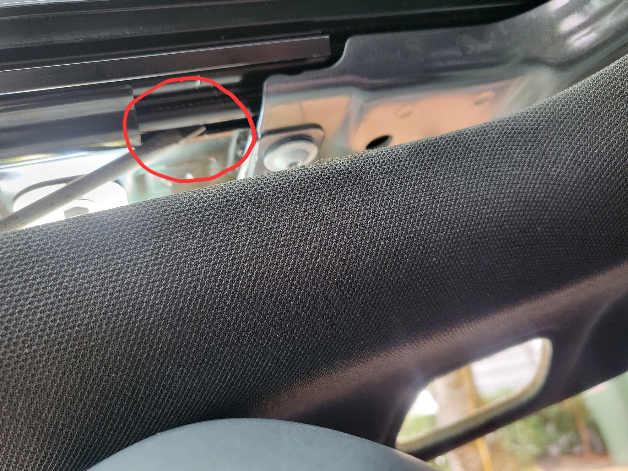

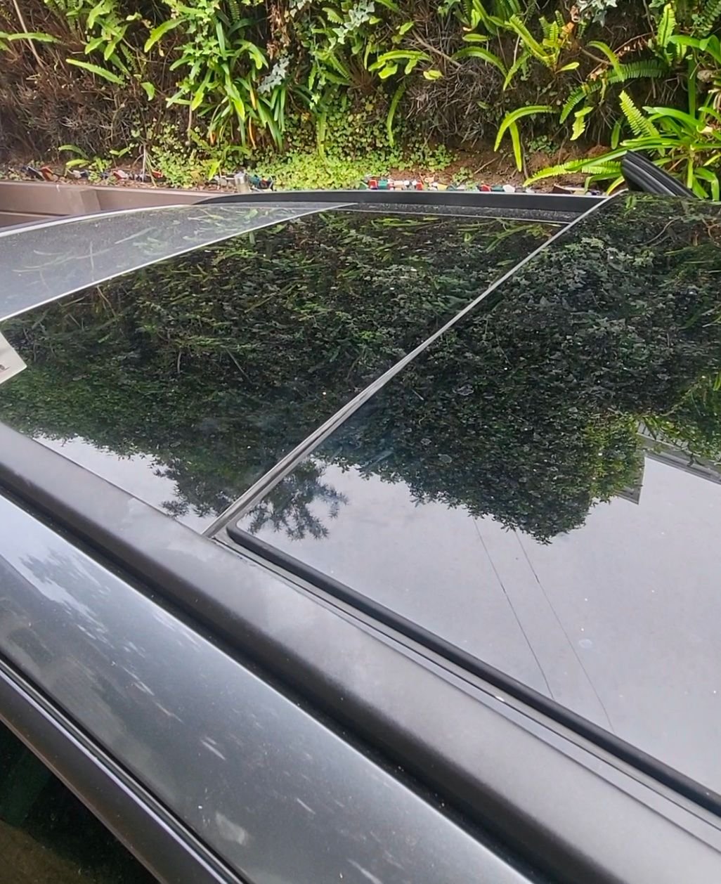

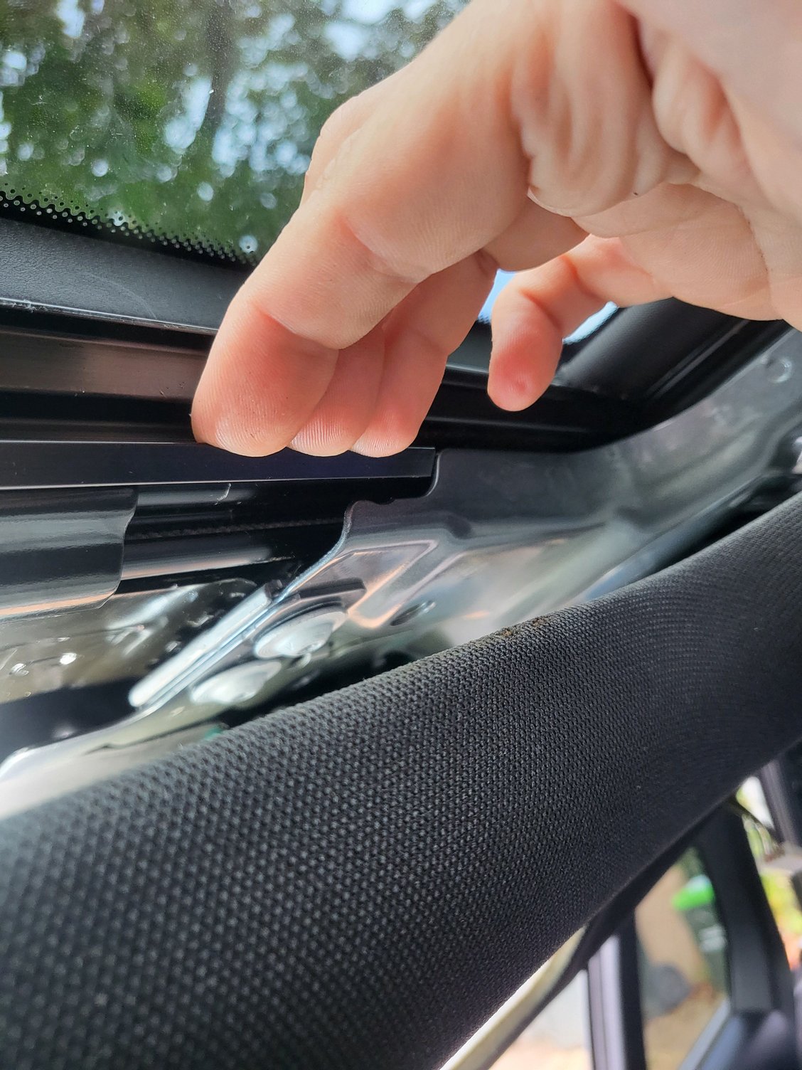

Help with panoramic sunroof.
I have a variation of a problem I know many have faced, and I hope someone out there can give me some ideas on how to fix this.
Rear drivers side is stuck closed (infamous 'A' plastic bracket I suspect)
I've tried all the obvious fixes I believe, including using an Allan key on the sunroof motor ( above rear view mirror) but didn't want to force it, so didn't push to hard.
My last attempt was too drop the lining slightly, loosen off the 2 torque bolts, pull down on the railing and the stick a screw driver in the crack, am I doing this right? will it help? ( was verbally told this might do it.
I have attached a few pics below,I fear I am getting near a dead end with this. Here in NZ it I could probably get a good used Merc for the cost of repairing this through a dealership.
Any help would be much appreciated. Thanks
