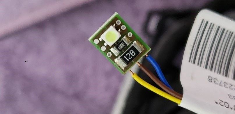

Mercedes Benz 3 color ambient led (shown below) blue = blue 12v+, Yellow = Orange 12+, Brown = Ground -

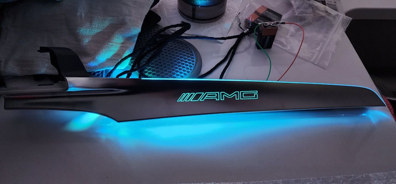

BEFORE
AFTER

Funny story. I took the 2 large screws out of the center console and the 2 medium screws out of the screen bracket for this install.
Then i spent 30 minutes wondering why the screen bracket screws would'nt screw back in, like before.
I was using the wrong larger console screws for the sceen bracket. Lol. *Sigh.
