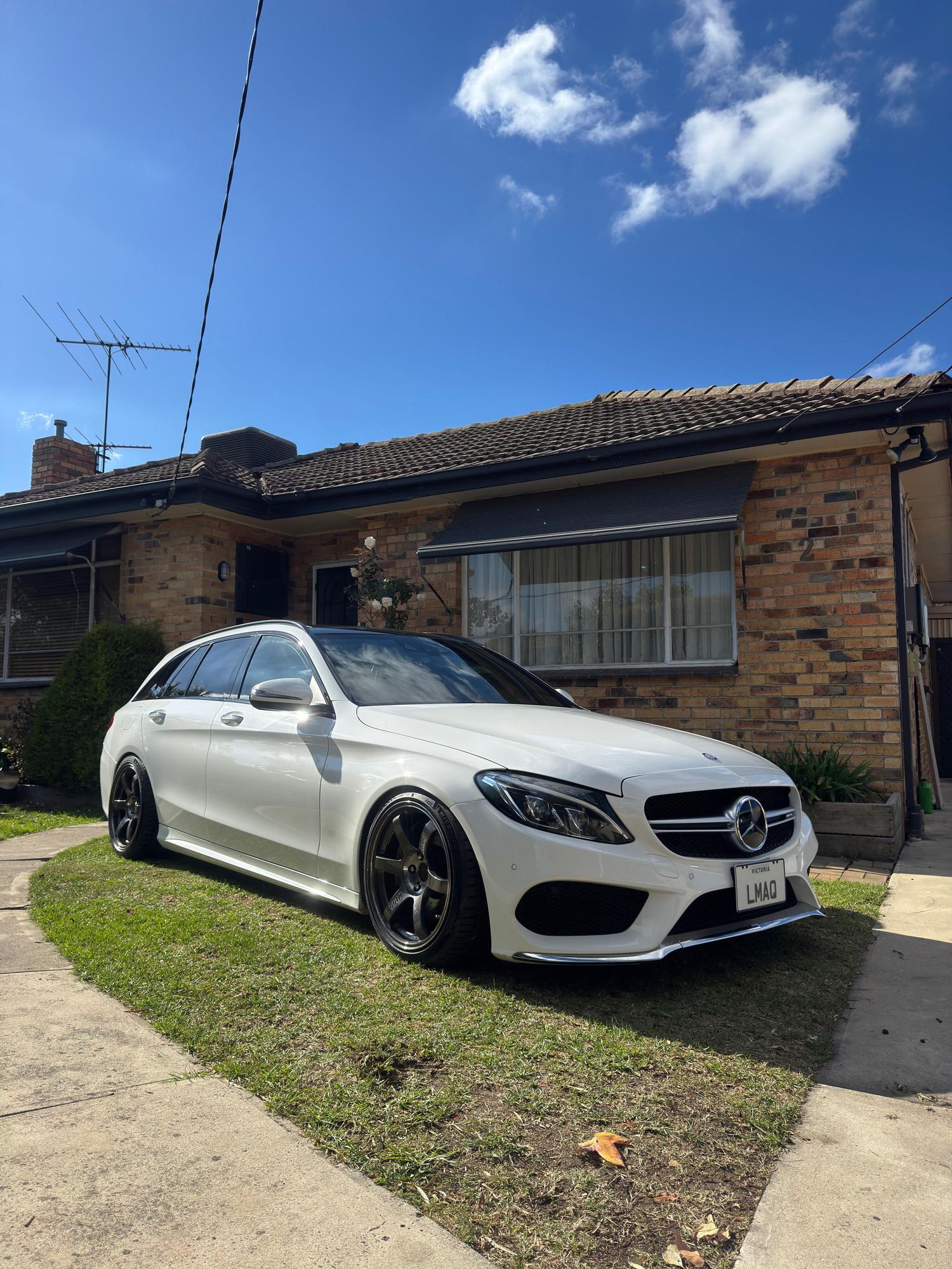

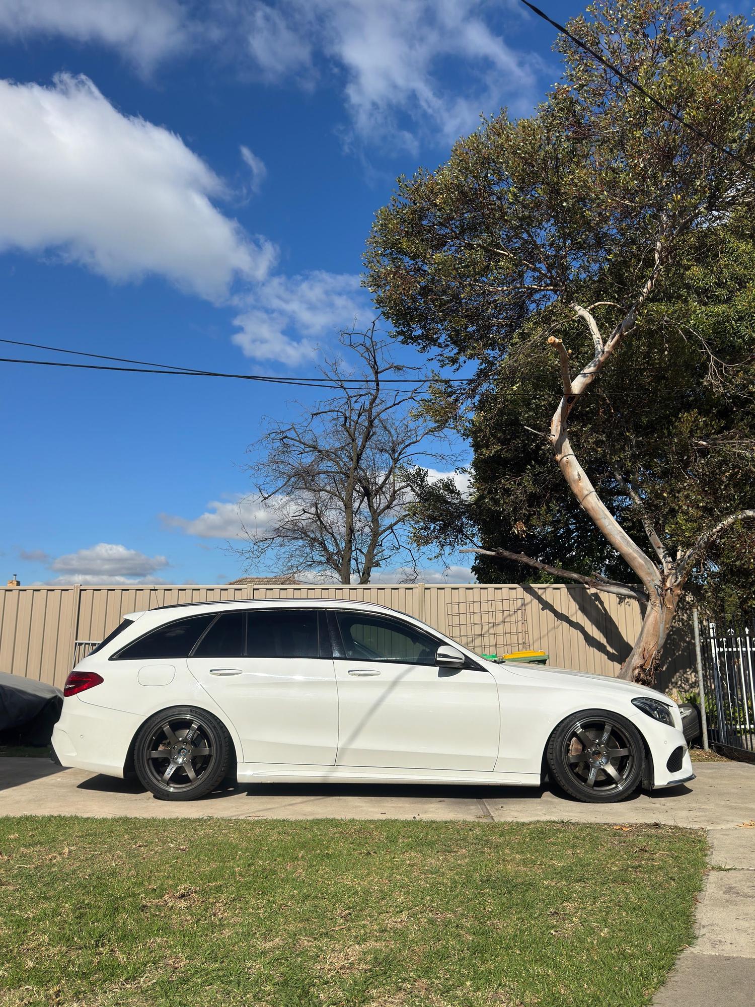

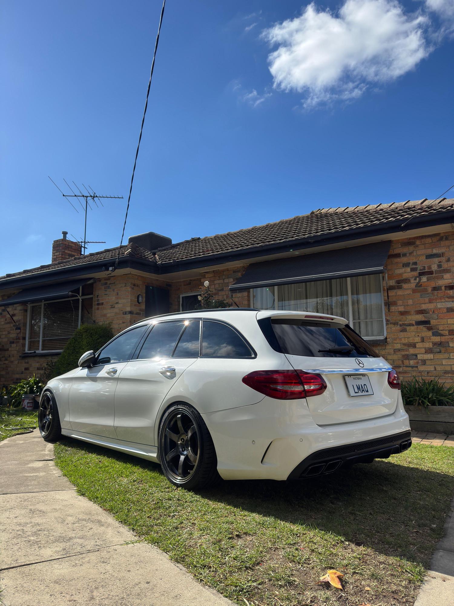

sorry to nuke a relatively old thread, but just wanted to thank Dimitrius for the valuable information
here's my setup on 18x9 +27 TE37SL's, 225/40 F and 235/40 R
