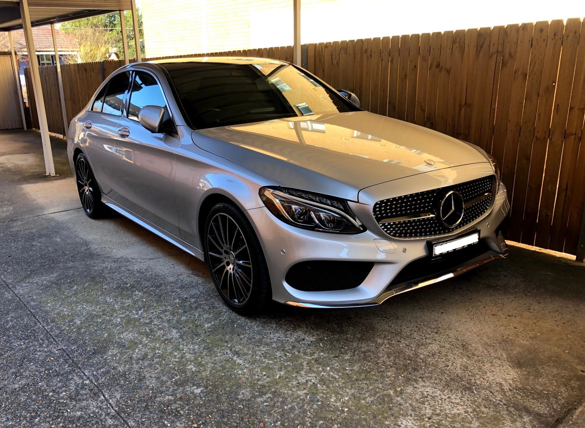

Old Oct 13, 2019 | 09:18 AM
camelfarmer06's Avatar
Joined: Jun 2019
Posts: 17
2016 W205
My first Benz!

Nice looking car and congrats AND welcome. Does the car have a comfort mode and a sport mode?? I believe some of the cars that do usually start off in 2nd gear when in C mode, versus starting off in 1rst gear in S mode.
