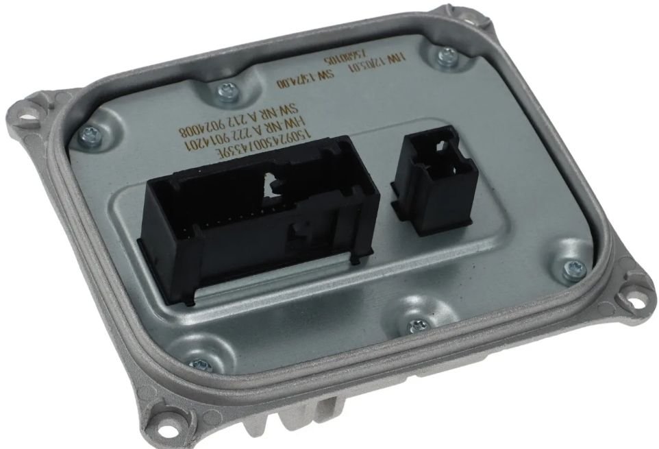

Well I think its unfortunate these HL need to be.poorly vented.
As it turn out... our high power LED HL generate enough heat to require a cooling FAN spinning all the time.
I've seen my HL filled with heavy condensation after driving through a short 2Mi long stretch foggy freeway.
I am concerned to see the HL control module is conveniently located at the lowest section where condensation has a chance to pudle - These electronic modules are unsealed...
Control requires coding to match L/R
I intend to coat circuit board and RTV-seal the controller Module and limit water entry from 3 vents using dryer sheet synthetic material.
As noted many car brands feature this new issue worked in by supplier: Hella?
