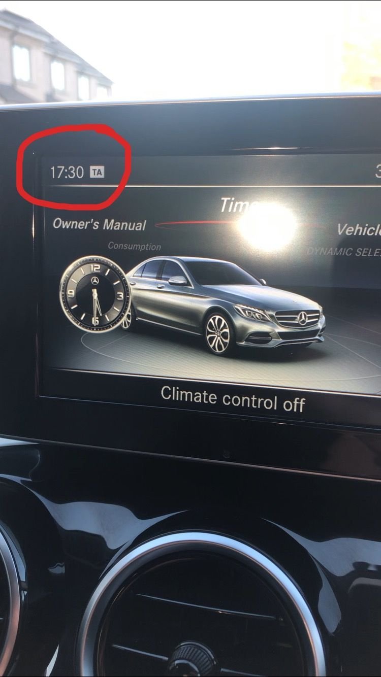

Hi Guys,
I’m hoping someone will be able to help me. I’m having an issue with the Time in my 2016 C220.
When I start the car, the time on the comand screen and the mfd are the same, however, as time progresses, the time on the Comand screen stays up-to-date but the MfD stays static (stays whatever time I started the car).
I have tried updating the time settings and even though it updates the time, the MFD refuses to stay up to date.
Any help here would be greatly appreciated!
Thanks

Originally Posted by Andy74
Do you the rotary little clock on the center console? Is that what you refered as MFD? They should synchronize. Maybe there is a malfunction in your center console clock.
maybe I'm
using he wrong terminology. See pictures above.
Thanks

Originally Posted by Kelleher77
Any other suggestions on this guys? Would it help if I updated the NTG version? (Or am I jumping the gun?)
i would see if there's an update. The Comand screen updates from GPS, and it seems the MFD does not.

not sure if yours is on this list....
MANY Mercedes cars were impacted by satellites rolling over their date in a silly 19 year cycle. The S class w221 was a nightmare as Mercedes couldn't be bothered to support a software update and a guy on the forum here did it himself.
for other later Mercedes
Recall Campaign 2019120008 DEC19 – 2013-2017 CLA-Class (117), GLA-Class (156), M-Class/GLE/GL/GLS-Class (166), SLK/SLC-Class (172), AMG GT-Class (190), GLK/C-Class (204), C-Class (205), E-Class Coupe/Cabrio (207), E-Class (212), S-Class Coupe/Cabrio (217), CLS-Class (218), S-Class (222), SL (231), B-Class (242), GLC-Class (253), GLE Coupe-Class (292), G-Class (463) due to a software fault in the communication module as provided by the supplier, the date and time as determined from the GPS satellite data could differ from the actual date and time starting on November 4, 2019. The correct date and time are necessary for the "Assisted-GPS" function to determine the vehicle position. Dealer will update communication module software.
