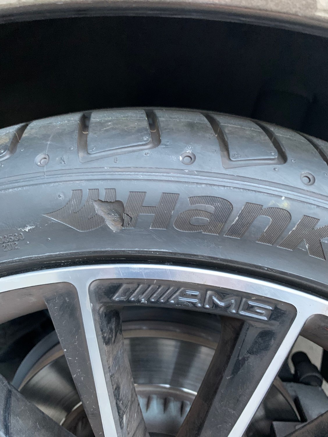

Need advices with this small damage on my tyre
Hi
I got this small damage on my wheel need you’re advices is there some glue that I can use to cover it or a cement material that I can use for it

I don’t think the tire is compromised structurally so I don’t see the need to fill the damage.

If you are going to get a flat tire, chance of getting in this particular tire will be greater.
If they are runflat tire, maybe you can drive home. If they are regular tires, I would get a replacement.

The damage is superficial as it does not even reach the radial cords. There is no reason for concern here operationally; just for the visual aspect.

you'll be okay until the tread wears completely. no high risk situation here.

Its superficial, not deep enough to cause an issue. I dont think it will expand.

I'm the contrarian on this one. The sidewall is not nearly as strong as the tread area and is stressed on turns. I think it should be replaced. If it blows out, it may rip up the wheel too. Ask a tire shop or two.

No way I’d keep driving on that. Peace of mind would be worth the cost IMHO.
