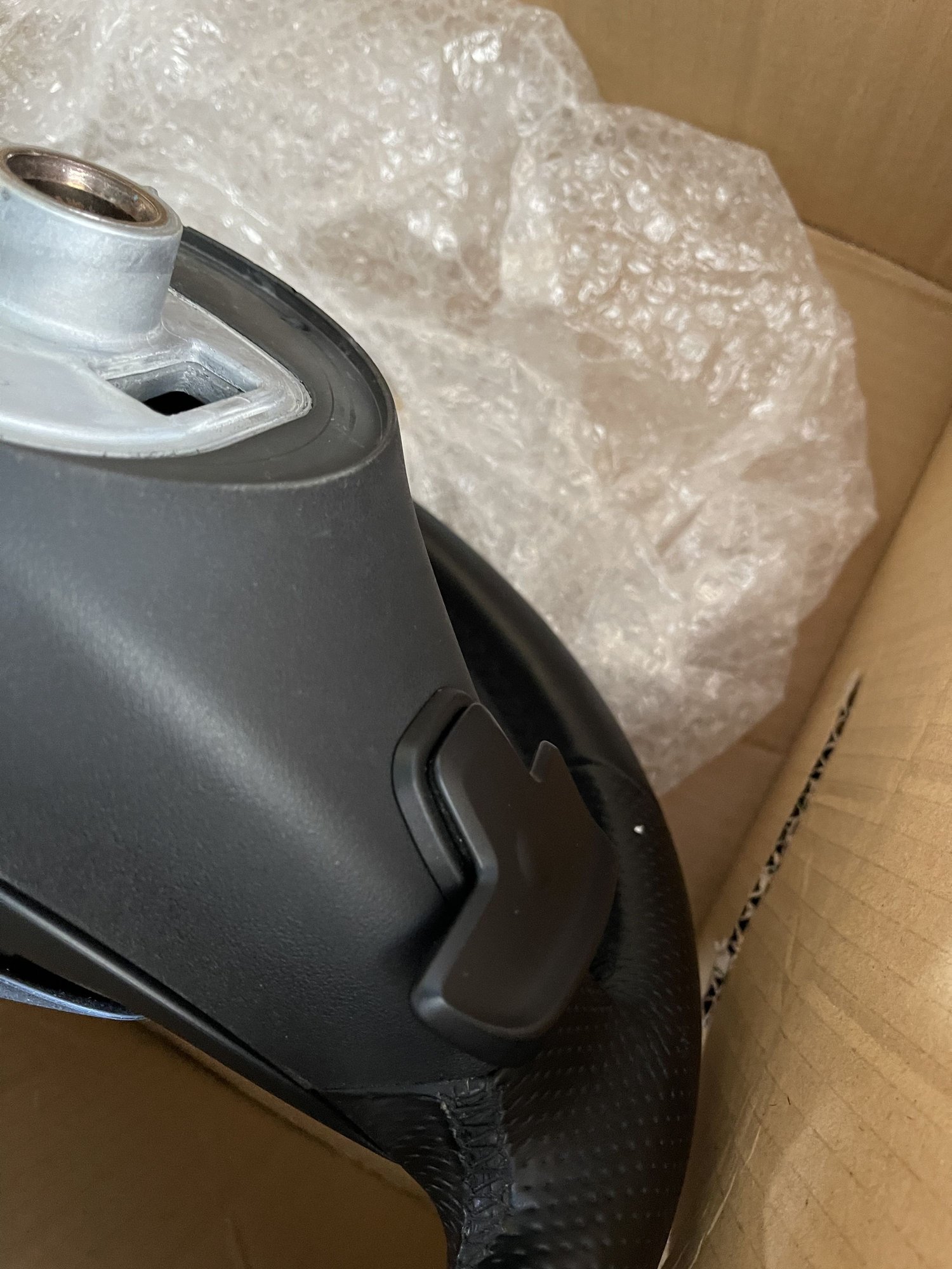

Hi all
I've just had my steering wheel changed over, unfortunately I didn't look hard enough when buying the (to me) new one and it had a slightly different arrangement of buttons.
I didn't think much of it, had my indy change over the contact plate and button modules but the horn and buttons still don't work, however pressing the upshift paddle looks to perform the action of the back or ok button 9 times out of 10.
Does anybody have any clue how to fix it and/or why it doesn't work? The only thing I can think of is that the paddle shifters are not playing well and I don't think these can be changed over as they appear to be a different size (pictures attached, chrome paddle shifters is the new steering wheel with buttons from old steering wheel)

Please give us more details about the car and the new steering wheel that you are trying to fit. Do you have a picture of your old steering wheel.

The car is a 2014 model with absolutely no options I can think of that would alter the steering wheel (no heated steering wheel or lane assist or anything like that), VIN is WDD2050042F038283.
After prodding the seller, the new steering wheel came out of 2017 C218.
What I don't understand is why would it still not work despite having both the buttons and contact plate switched over from the old steering wheel

Because I was stupid and didn't think to look at the pictures closely (I mean who would notice the left and right arrow instead of OK and voice assistant off button) and the seller listed a whole list of cars for this steering wheel without saying which car it actually came from.
I just went by the shape (changing to flat bottom from round steering wheel) and I know that was a mistake but I'm trying to work out if it's the paddle shifters or something else entirely, but other than those and the frame there is nothing on there from the new steering wheel so I'm just trying to pick some brains.
Also the last 2 pictures in my first post is the old steering wheel with new buttons.
