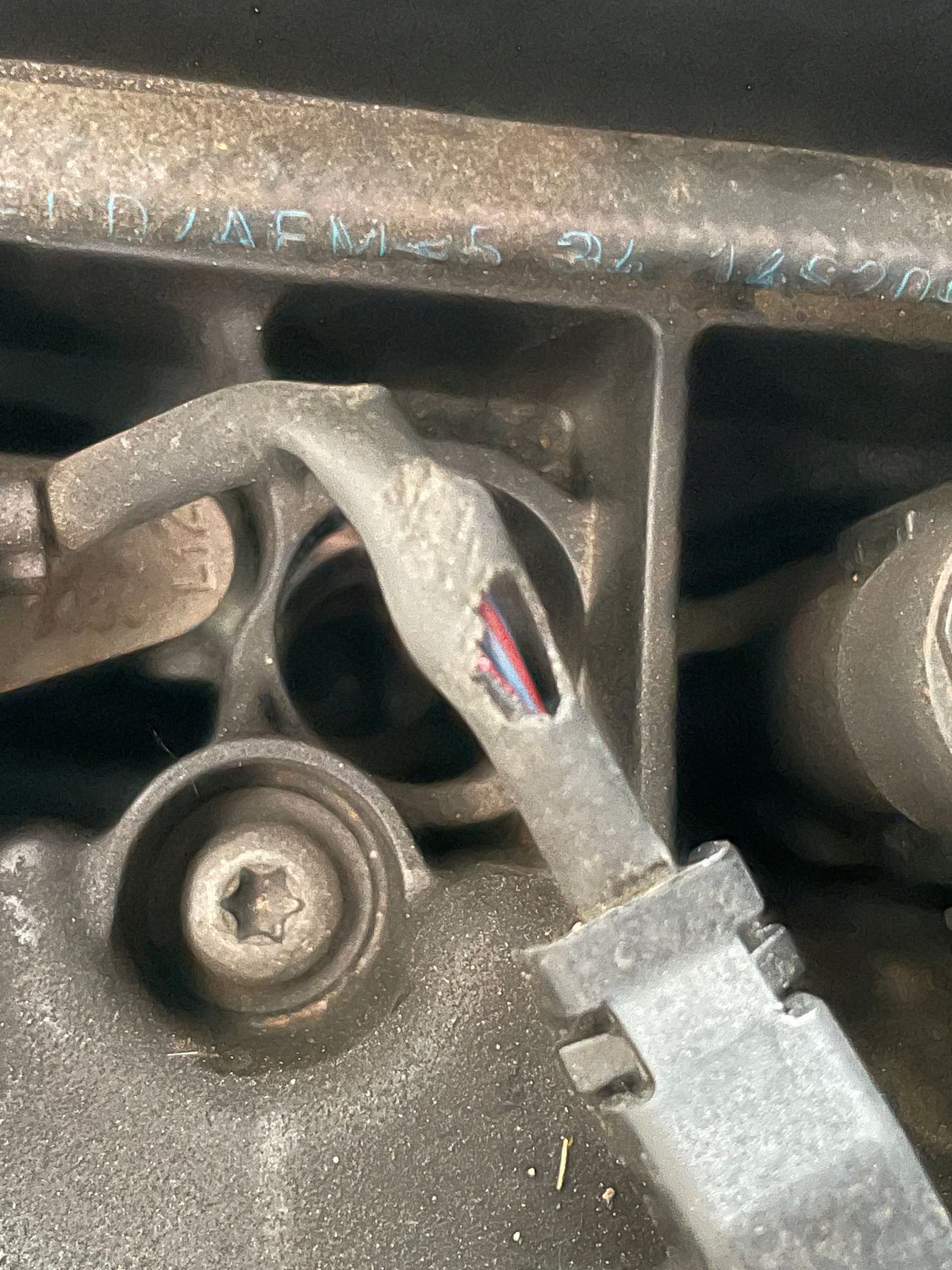

What would cause this damage to injector wiring?
I got the P0203 and P0204 error codes off the OBD scanner and pulled the engine cover off to inspect.
I no need to replace these but am stumped how this could happen!
anyone know the part numbers and how to replace these? 2015 c250 blue TEC
thanks

Rat or a mouse? Or some other rodents that can climb up there.

its starting to look like that!
Now i need help trying to find the part number for the injector lead. Anyone know where i can find this?

Yep, victim of the current mouse plague...

Not chafing on the engine cover?

Have a look at www.realoem.com ignore the BMW bit and choose Mercedes then you model and year.
none at all

I would use rat/ice poison bait and just jump the wires using crimp connectors and heat shrink tubing/non-acidic silicone and gaffers tape wrap.
Stagger the point of the splice if possible, so they are not against each other.
Replacing the harness is $$$$.
Would the crimp connectors cause an issue with the CANBUS? ie load or resistance?
Looking to get some mice bait. Country Australia has a plague at the moment, but i haven't seen any in my local community apart from this wiring smorgasbord under my bonnet!
