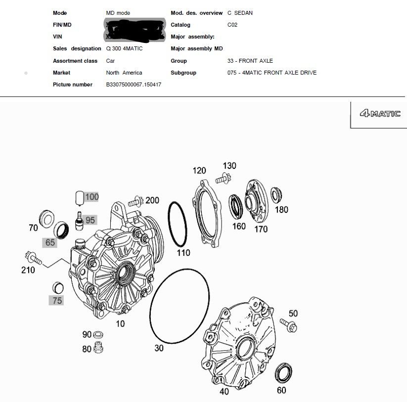

It is well documented on the forum that there is no fill plug but only drain plug. Dealership fills it by removing the half axle. DIYer's will fill it by pumping the oil up thru the drain plug. The transmission filling adapter fits the drain plug and works well. If you do it, please document by taking pictures to help others. Be safe when under the car.

Yes "no" fill plug, unlike the rear differential. I don't have the links handy. But do a search on all platforms you should be able to find it. If you are still having problems finding it, I will help locate it. Many thanks for the transmission fluid DIY, I am sure it will come handy for the members. My service is also coming up soon before the summer is over that I would like to tackle myself.

Here is the screen
shot from EPC that does not show fill plug on the W205 4matic.
