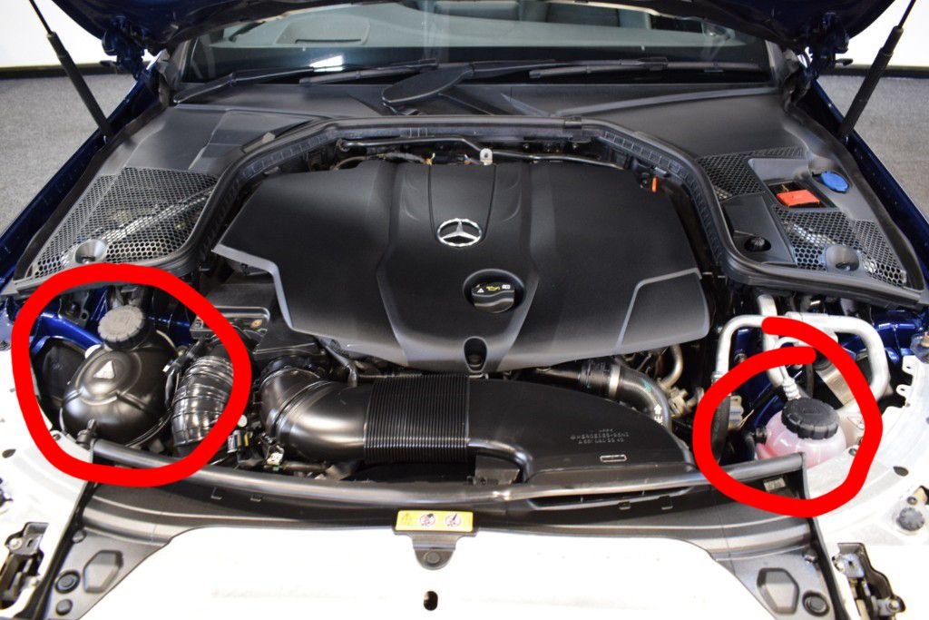

the older W205 had 2 coolant tanks, the 2nd one just over the turbo... while the 2017 and above would have a single coolant tank only.
Likewise the larger CC engines would also have 2 coolant tanks.
For coolant the W205 uses the coolant spec 325.5 (pink in color), part number A000 989 28 25 11.

Thank you, but can you tell me where are the 2 coolant tanks exactly ?
Old Aug 25, 2022 | 07:44 PM
dagger22's Avatar
Joined: Feb 2018
Posts: 333
Likes: 102
2019 CLS450 (C257)
here's the reference link: https://mbworld.org/forums/c-class-w...ml#post7481512

Hey guys, my car (2017 c220d) has 2 coolant tanks. I only had to refil the left one because I had a leak somewhere but the right one didn't move an inch. Does anyone know its function?
Old May 6, 2025 | 01:57 PM
W205C43PFL's Avatar
Posts: 32,222
Likes: 6,281
yes they serve different functions: https://mbworld.org/forums/c450-c43-...x-coolant.html
