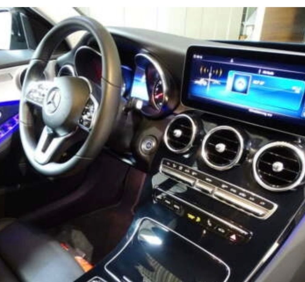

Hello
I’ve got a new scree and Hu from w205 2019
i have w205 2016
the New cluster is necessary ?
i dont have the pin of hu where i can buy one?
I will do the assembly myself and the coding for an spécialist
thank you for your help

Yes, you'll need a new cluster (from a FL car), a FL headunit (sounds like you already have it?) and the new screen. You'll also need an unlock pin for both the cluster and headunit and the cluster will show you the wrong mileage unless you buy a brand new one.

Yes i have hu and screen.the seller also has a screen. I also saw that it needed an additional module but I can't find any info on it

I'm genuinely not sure you'll need one, you might need new LVDS cables for the screen and cluster as I'd assume the old ones won't fit and you'll probably need a new card reader and touchpad.
Try those threads:
https://mbworld.org/forums/c-class-w...05-screen.html
https://mbworld.org/forums/c-class-w...-ntg5-5-a.html
https://mbworld.org/forums/c-class-w...-retrofit.html

This is only necessary if you want to retrofit an instrument cluster from W222 into W205 iirc.

Hello, I had left the topic hanging because I thought I would put an Android screen. I will still install the HU5.5 and 10.2 screen. I saw a w205 fl with a cluster like mine. I’ll leave the original one.
