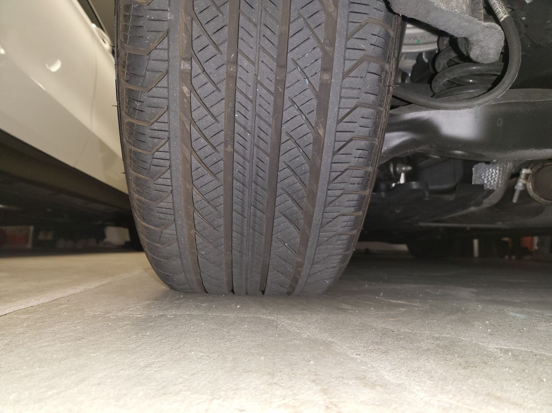

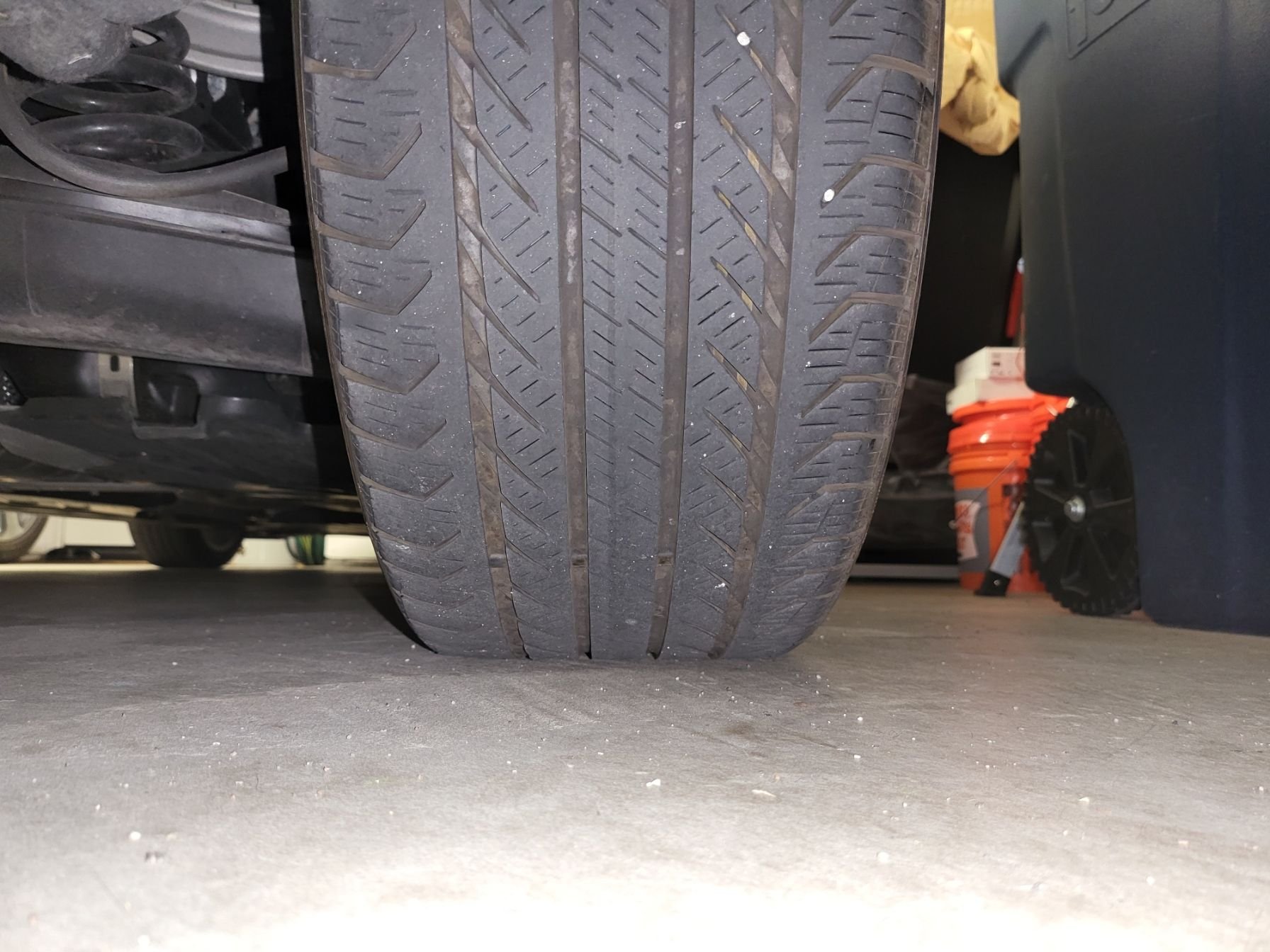

Question Is this typical tire wear? Continental RF almost done at 12k miles
Dealer put on new MOE Continental RF (18") when I bought the car CPO.
After 12k miles, my rear tires look close to needing replacement. The right tire looks more worn than my left tire overall, especially when looking the inner edge to the middle.
Is this typical for a C300? I understand these cars chew through tires due to its camber, but wanted to understand if the uneven wearing is somewhat expected?
Rear Left
Rear Right

Too soon. Clearly there is an issue here. You don’t say if square or staggered.

These are staggered setups.

If you have the C300, you should not have any problem with your tires like on the C450/C43/C63's
The C300 sits flat, so you must make sure your tire pressure is set properly plus after some time, you should also get a realignment done if you purchased from a dealership outside of MB or if you see uneven tire wear.
The 18's sit flatter on the C450/C43 cars even with the rear camber BS that is setup in the cars and can not be adjusted however the C300 do not have rear camber sport setup.

What do you mean by the C300 sitting flat? Do you mean the camber? My last alignment done back in Oct 2021 shows that my car has -1.5/-2.0 camber on left and right side, respectively.

What I am saying about "Flat" is that your front and rear should be 0.0 camber or very near it. Also the toe should also be 0.0 as the C300 is not setup for sporty driving but more luxury smooth driving.

As others have said, this is a common issue of uneven tire wear on the rear of C300's. The factory rear camber setup is excessively negative IMO. The proper way to correct this is by getting a quality rear camber adjustment kit... or just keep buying tires. :p
Mine had the same issue. I have the K-Mac rear camber kit (highly recommended) and it has corrected my issues. Plus I can have it adjusted at will, if I want to go more aggressive for handling, etc.
Check out the difference of the north-south plane of the rear wheels in my before and after pics:
BEFORE:
AFTER:

I'm going to the dealership to have them do a wheel alignment. They're running a special for $109, so I thought it was a good value.
At this point, my Mercedes indy said that all the suspension components look good. So hopefully this is just an alignment issue...
I'm also under CPO warranty so I will push the dealer to quickly check all the suspension components, just in case. Hopefully they don't charge me a diagnostic fee
I will update this post after.

Got back from the dealership this week. Did my 60k transmission service early + did a wheel alignment. The alignment came back with only the rear-right wheel out of alignment. So the conclusion is that it was an alignment issue.
I was told that these tires still have a good chunk of life left. I'm gonna keep a closer look till then. Hopefully I can get a good 25k miles out of it (halfway there so far).
