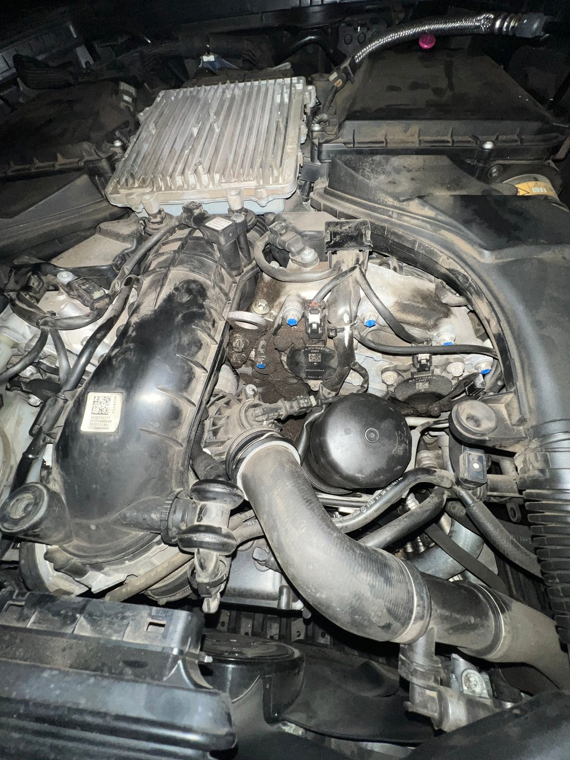

so yesterday I was performing my oil change on my 2016 c450 amg
this car just got out of warranty so it was the first time for me doing the oil change
right away i notice a leak coming down from the top
after inspection, it seems to be leaking from the driver side cylinder head
very disappointed since this car has always been maintained by mercedes benz themselves and they never mentioned there was an obvious major leak coming down the top of the engine
it looks like they never saw that (for me it was obvious)
i have been googling around trying to identify the part exactly without success
any tips would be greatly appreciated as to common leaking problem with this engine m276.3 or car w205 2016 c450 amg
or simply help to identify the parts / valve itself so that i can do further research
the part im looking seems to be attached to the front end of the cylinder head and im not sure what is leaking exactly
the oil seems to be going out near the rod or a bolt....
see attached pictures:

That leak is from the front cylinder head covers. Pretty straight forward job. Remove the covers, clean and reseal. Technically, they are not supposed to leak but they do.

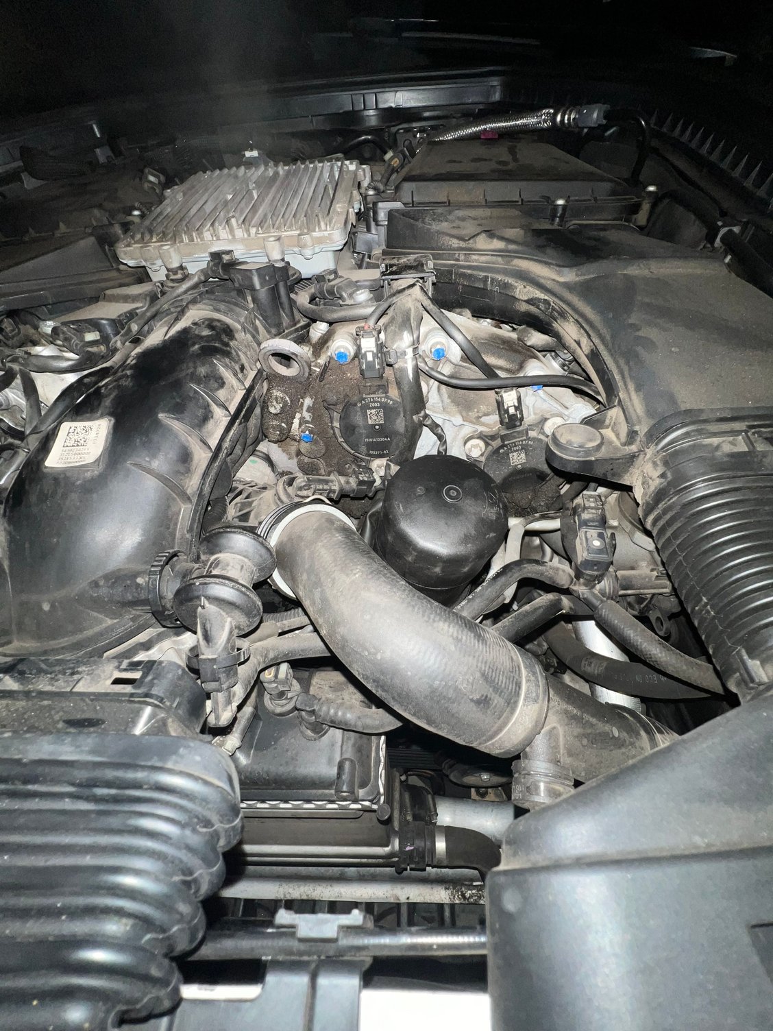

I attached some additionals pictures and the oil seems to be leaking from some bolts and also from the two Control Valve Solenoid part no: 2761560790
It would be nice if some other knowledgeable people gave their opinion about the leak
I am planning to the job myself. It would be nice if people could help me identify exactly what parts I should replace.
If I need to do the job, I prefer to change more components especially if they are on the cheap side like bolts and gaskets.
Do I need to empty the oil reservoir before resealing or changing the two control valve?
From my understanding I would not need to change the valve cover gasket right?
I found that labeled head cylinder cover is it the part i need to do the reseal job you are talking about?
https://www.mbparts.ca/oem-parts/mer...bC12Ni1nYXM%3D

Yes, common leak. Need to diagnose for certain if the leak is from the cylinder head cover or the cam magnets. Cam magnet reseal is fairly easy. Cylinder head covers require careful and thorough cleaning without damaging the machined surface. Then using the right type and quantity of sealant. Then using new aluminum screws torque to the proper (low) torque.
Use the search feature or google with site:mbworld.org, this is addressed in this site.

Yes, thats exactely whats occuring with mine. A reseal with Mercedes RTV and replace the 16 stretch bolts and youre good !

UPDATE. Its worst than we first thought. After removing air intakes and air filters and cleaning all the oil leaks, its blatant that the right head gasket is leaking, right cam magnets are both leaking, the front head cylinder cover on the right is leaking and the oil is smelling gas. Which makes sense because the care is smoking white. I went to benz to confirm my diagnostic. After spending 2 hours and charging me 400$, they confirmed I was 100% right. In addition they say left side also started leaking. The gaskets, the sealant and the o ring behind the cam magnets are super stiff probably because the car did not run for a few months. So it seems I am completely screwed up. Dealership said for a tedious job like that, they dont estimate up front. They start the meter and thats it. Could easily go in the 5000-10000$ range. Any advice? I am thinking literally fitting in a new engine at this point. Am I stuck with the original one or could I fit a c43 amg with no mods?
