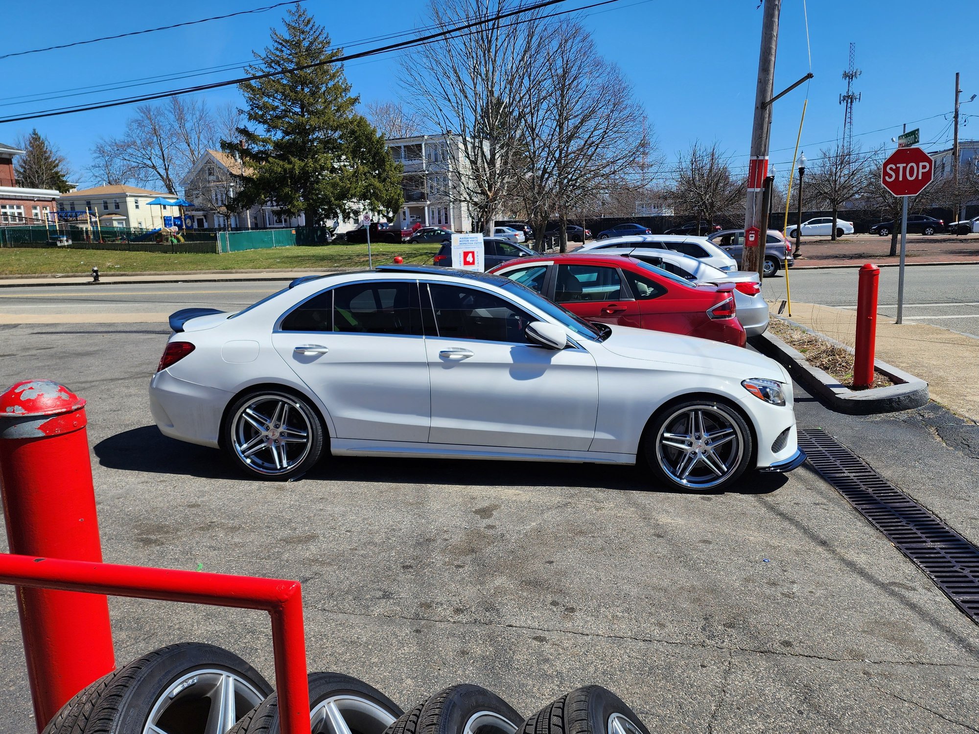

It's hard finding info with 20s on a W205. So I did mine. It's a 2016 C300, 4matic, Sport version.
Fronts: 235/35/20 ET 40
Rears: 275/30/20 ET 45
It sits perfect. Flush right to the fender.
Hope this helps you guys out there.
A small gap but no rubbing issues.
1st day with new wheels on

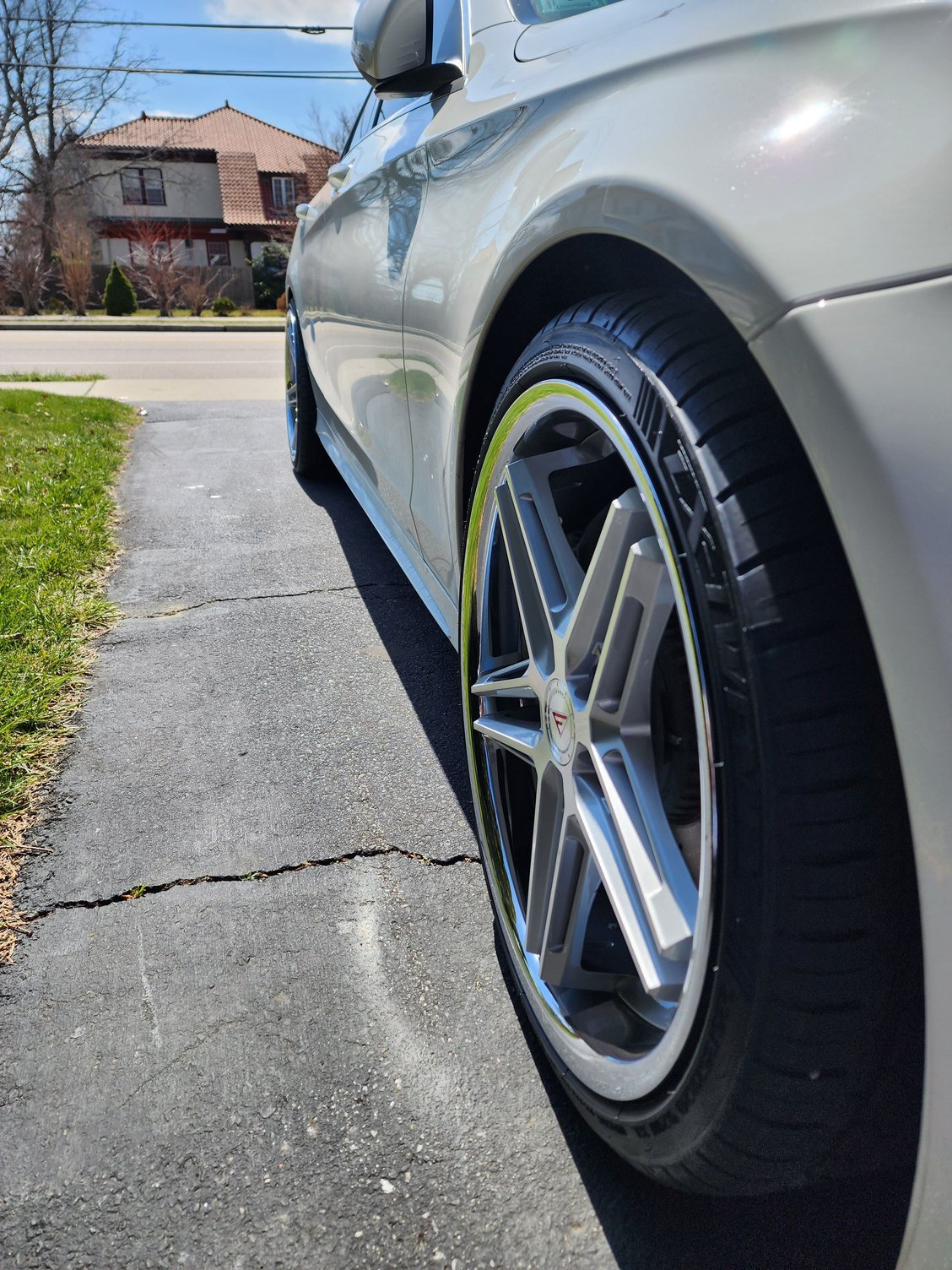

Ferrada Concave Madness 1. (Or just CM1).
The fitment specialist said if I were to go with 255/30, (which I had on my w204), they'd have to stretch the tire to fit the rim (or something like that), but with this they didn't need too. But if you mean stretch as in wide, well yeah. It's broad. But no issues at all.

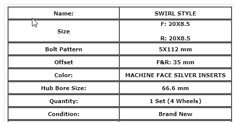

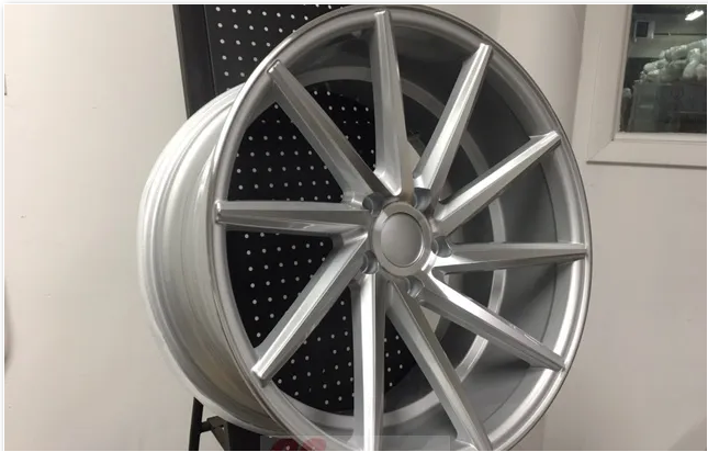

I'm thinking about getting these wheels off of ebay for 2018 c300 front and rear are both 20x8.5 offset 35 front and rear. Is this a bad look, would like to know before purchasing also what would be the right tire sizes
Old Apr 9, 2023 | 07:11 AM
arcangel_nickk's Avatar
Joined: Apr 2017
Posts: 11
C300
Originally Posted by sweetc300
I'm thinking about getting these wheels off of ebay for 2018 c300 front and rear are both 20x8.5 offset is also the same front and rear 35mm. Is this a bad look, would like to know before purchasing also what would be the right tire sizes
Those are some nice looking wheels. 😎
​​I seen a c300 with 35 offsets but the wheel was 20 x 9 all around, & it looked good. So you should be good. I'd advise you too call Fitment Industries for finding the correct tire size. Just mention the rim size (20 x 8.5 all around) and the offsets, an ask what tire size they recommend.

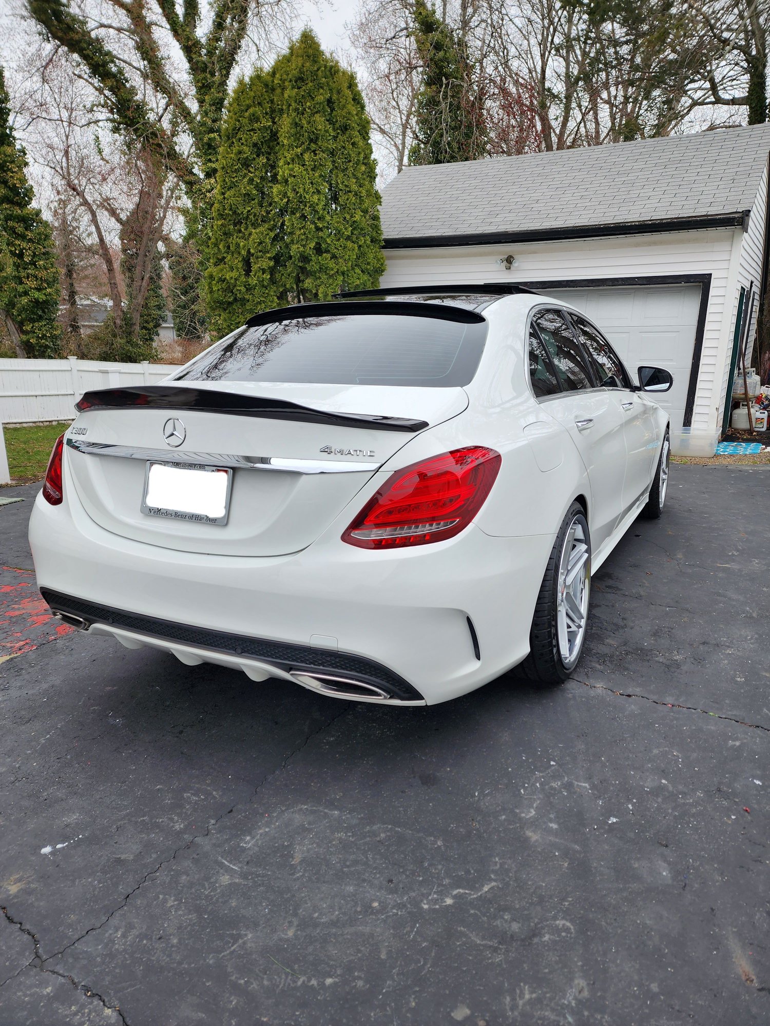

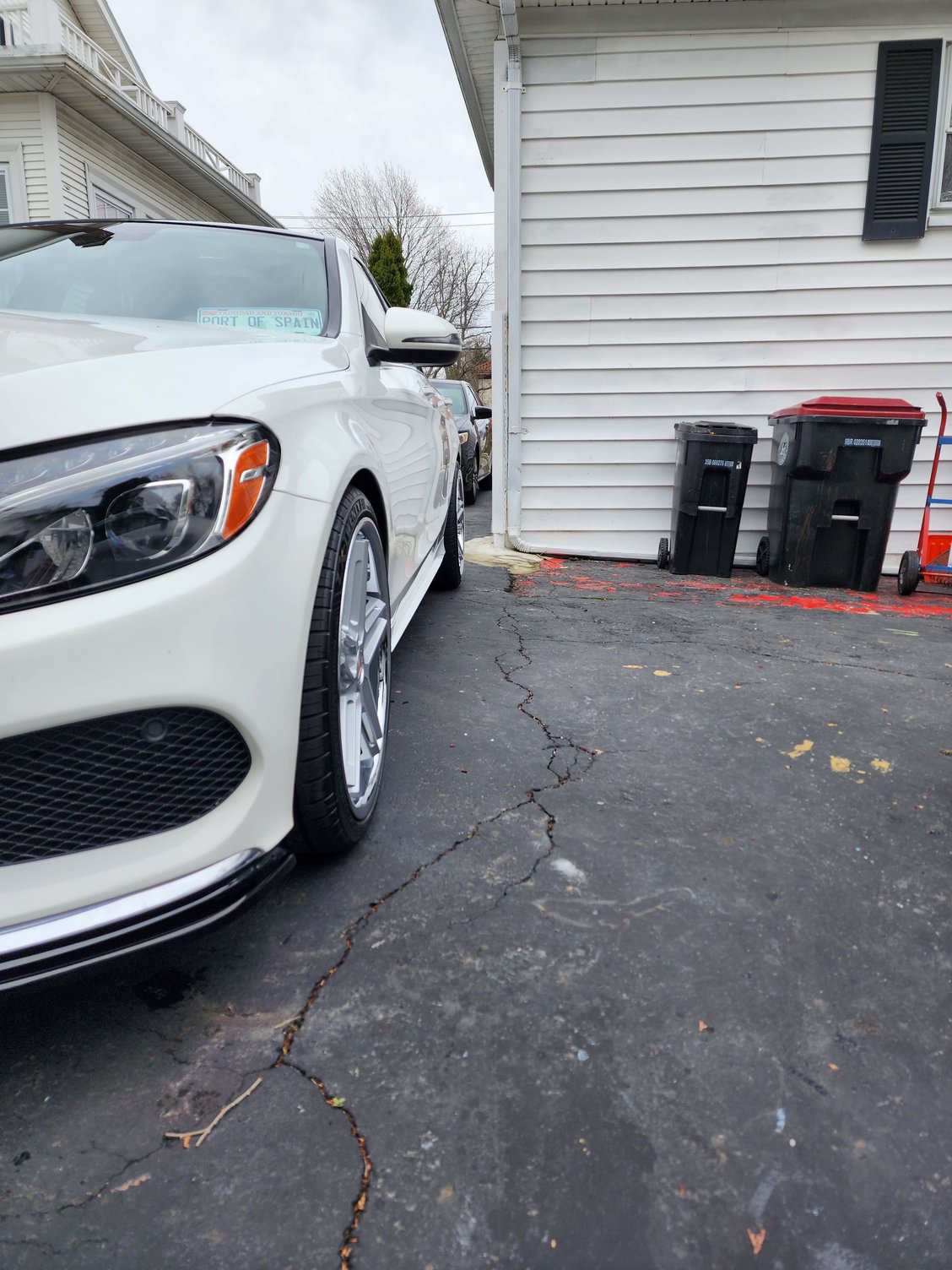

Couple side by sides, before & after
Front view: 18s to 20s
Side view comparison: Stock amg 18s to 20s
