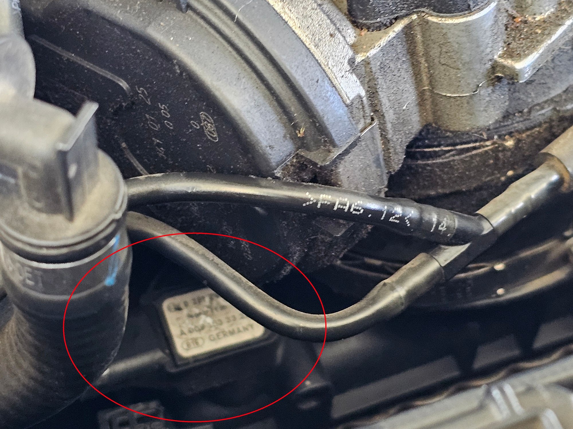

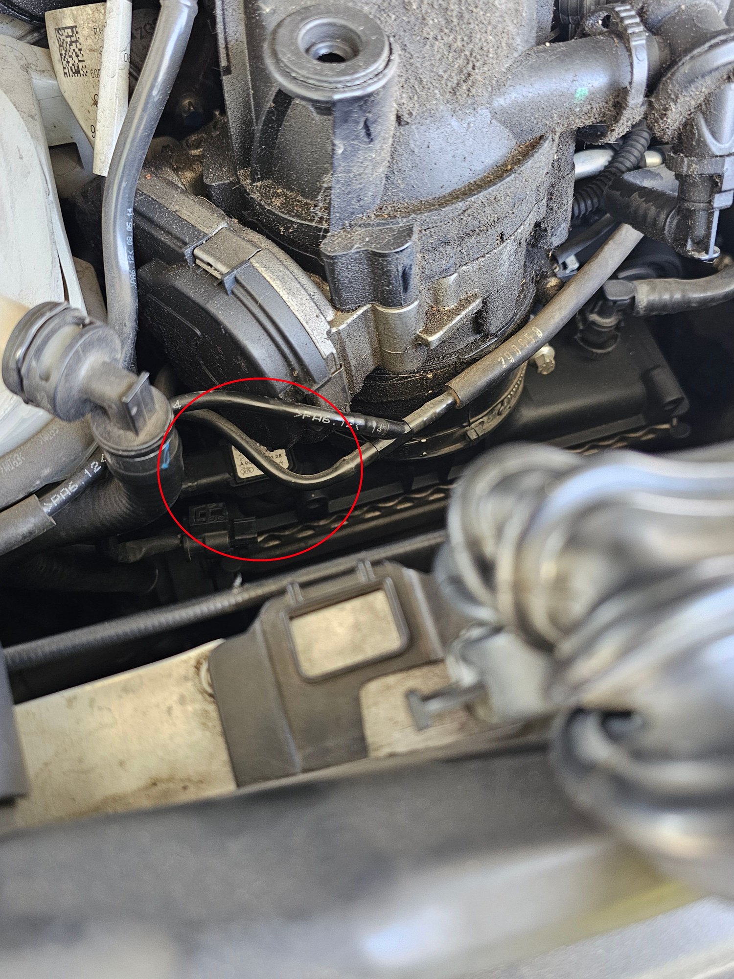

Received the turbo boost pressure sensor today. Even using a stubby with a torx bolt attached, there is not enough space to work with. I can't imagine I'd have to remove the manifold just to reach this sensor. Is there a better way of doing this that I'm missing?
I've attached some pics with the sensor circled in red.
Old Jul 20, 2024 | 11:31 PM
TwoC400s's Avatar
Joined: Mar 2022
Posts: 342
Likes: 112
2015 C400 4MATIC Palladium Silver Metallic
Originally Posted by rsmooth
***Update***
Ok, I'll give you my take... But you aren't going to like it 😂
If you need the IC to move/shift you have to:
1) remove the intake/filter piping to the turbos
2) disconnect the intake pipes between the turbos and the IC(this is BY FAR the hardest part)
3) disconnect the IC from the throttle body
4) Pop the IC off of its retention bracket
After that the IC will move around quite a bit with only the coolant loop hoses connected.
​​​​​​Coincidentally, those are the first four steps of replacing the serpentine belt and tensioner assembly.
I guess I should have replaced that sensor while I was in there.
You're going to need a set of etorx swivel sockets to get the IC pipes out (or extremely low profile etorx wrenches).

Old Jul 20, 2024 | 11:39 PM
TwoC400s's Avatar
Joined: Mar 2022
Posts: 342
Likes: 112
As involved as all that sounds, it's orders of magnitude easier than removing the upper intake manifold plenum
Old Jul 21, 2024 | 12:26 PM
TwoC400s's Avatar
Joined: Mar 2022
Posts: 342
Likes: 112
OK, just went out and looked at the screw. It's torx, not e-torx, exactly like the one on top of the mainfold, so you might have some options there.
If amazon is an option a low profile torx, 1/4in, pass through wrench set *should* work.

The car finally threw a P0106 - Manifold Absolute Pressure out of range code.
As a first attempt fix I cleaned the MAP sensor on the intake manifold and the car ran way way better - power was back and the CEL went away without clearing the code.
Since then I have ordered both the sensor for the intake manifold and the intercooler (same part number) from Mercedes, and I am going to replace both.
The intercooler one was hard to get out, I had to use a stubby wrench with a Torx bit that I cut down to be very short, and it just fit. Would have been super annoying to remove the intercooler or intake manifold just to change that one sensor.

Just as an update - for me it seems like it was just related to the map sensors.
