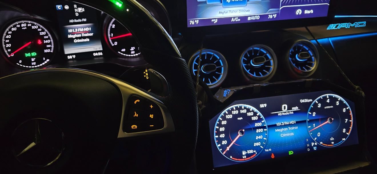

Running the digital cluster side by side with OEM one, as I test.

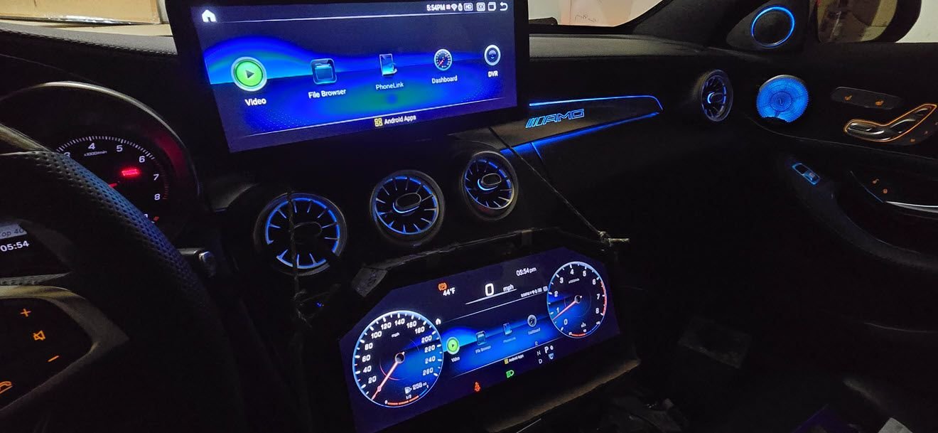

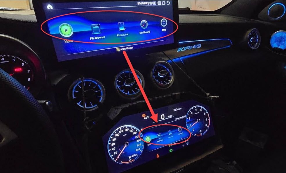

When you set the cluster on the navigation menu option it displays video from the HDMI in port if anything is connected. Turns out you don't need a new Android screen from the seller to do this.
I found two USB to HDMI adapters on Amazon, One uses a MS9120 chip and the other uses a SM768 chip. Both worked with my existing 12.5 inch aftermarket Android screen.They both come with Android drivers.
The Wavlink uses a SM768 chip and is around $45.
Amazon Amazon
The Android software is called SMI InstantView in the Play store or on the Wavlink website. Current version is v2.21.2.0
The generic KLOMIER adapter uses a MS9120 chip and is only $14. The image quality is the same as the Wavlink.
T
his adapter has two selectable resolutions in the settings,1920 x 1080p or 1280 x 720p. (I toggled this option while connected to my cluster and nothing changed)
It also has two Output Quality options, low and high. (I toggled this option while connected to my cluster and nothing changed)
Amazon Amazon
The Android software is called MSDisplay_Android and it comes loaded inside the adapter or can be found in Github online under MindShow/USBDisplay project. It's not in the Play store. Current version is V2.0.1.3.

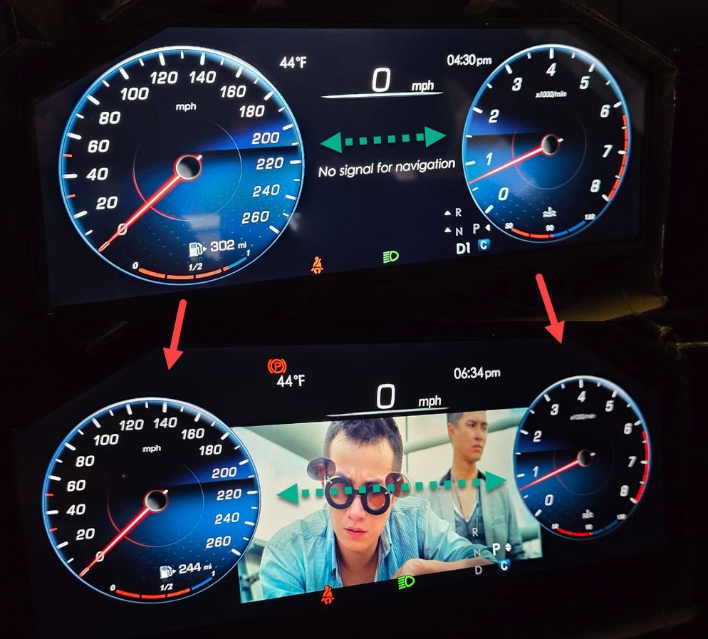

The digital cluster has a setting that allows you to adjust the position, width and height of the center screen. (While on Navigation. Push and hold the OK button.)
There are individual settings for each cluster design. Here I am adjusting the settings for the Classic cluster design.
Pushing the Ok button on the steering wheel once (while on navigation) will make the two gauges smaller and spread apart, letting you see more of the center image.(in widescreen)

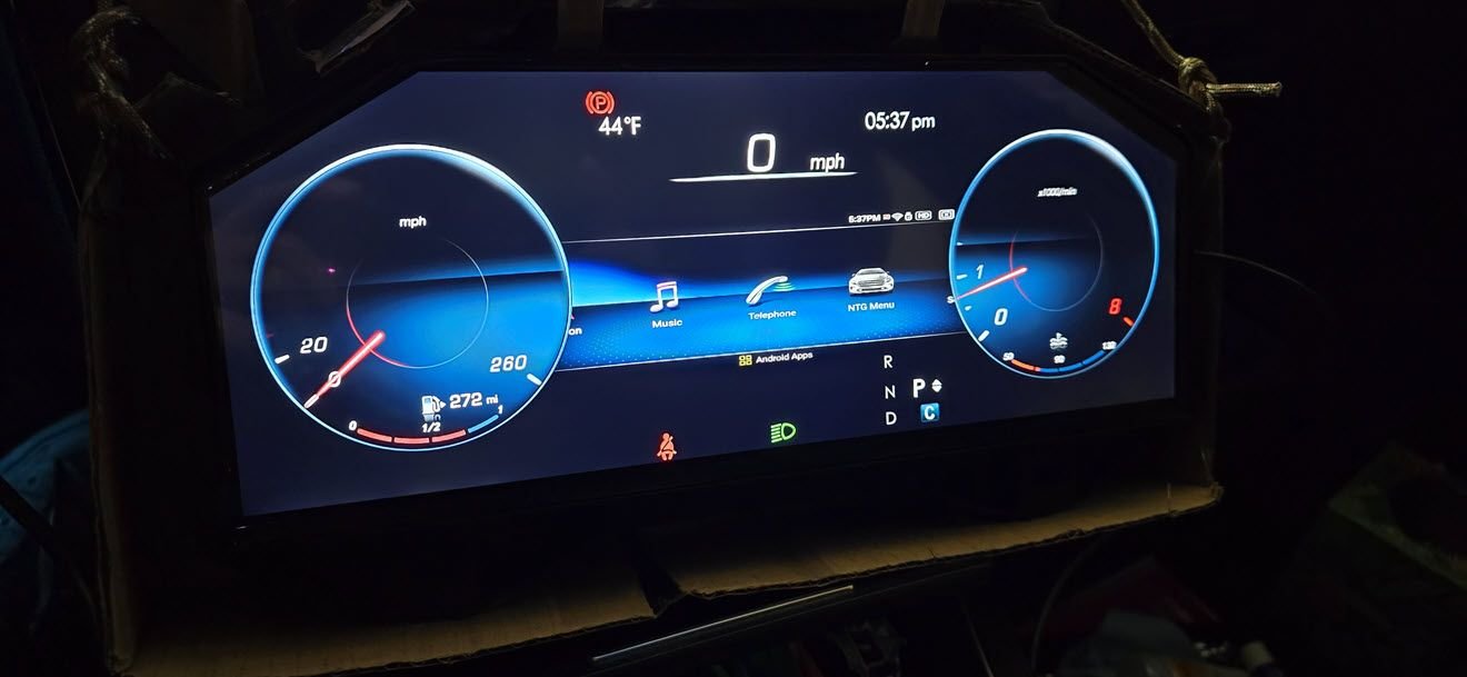

My car has does not have Parktronic / Self Parking. I cannot test.
Tire pressure values are correct, but are in KPA not PSI.
Multimedia (Bluetooth, Radio) display correct songs, information, device and stations.
The "Navigation" option in the Digital Cluster is for displaying HDMI video input from any HDMI source. (Not sure why it is labeled "Navigation")
You can display any application from any aftermarket Android screen or Google Maps for navigation. I was even able to connect my Android phone using a different USB C to HDMI adapter.
The Phone option in the Digital Screen is for Bluetooth Phone.

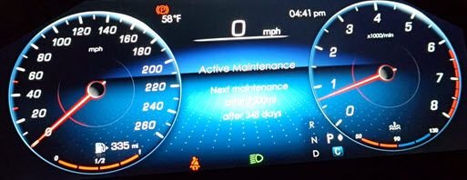

Maintenance information is correctly displayed.
